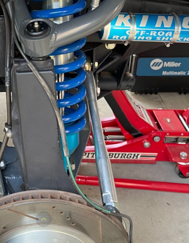

    What I ultimately ended up doing was buying the camburg inner clevis and JD tie rod since he had some aluminum ones for my kit length on hand. Since I already have the tie rod end double shear kit, he's supplying me with the inner heim, lock nut and tie rod itself. It'll look like this, and I plan on coating it with some steel-it, probably.

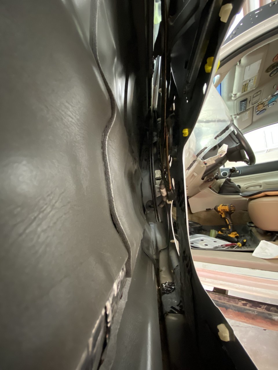

    I sound deadened my other two doors today, this is the only pic I got. Went for a test drive on city streets and couldn’t tell a difference if I’m being honest. We’ll see on the highway. I still have a decent bit of material left over for the roof but not enough for total coverage. I’m just going to use what I have and call it good enough.

    I never did the roof.... the floor pan up the kick panels and firewall made a big difference also

    That’s what I was thinking as well. Just use what I have to double up what I already have on the floor pan up front. There’s more noise coming from there than the ceiling. Plus it’s easier.

    Kilmat for the butyl and noico for the MLV. 36 square feet to do my floor and back wall and another 36 square feet to do my doors and ceiling.

    I would say so. But I would rather over estimate because you can always double up if there’s leftover and get extra sound deadening ability
