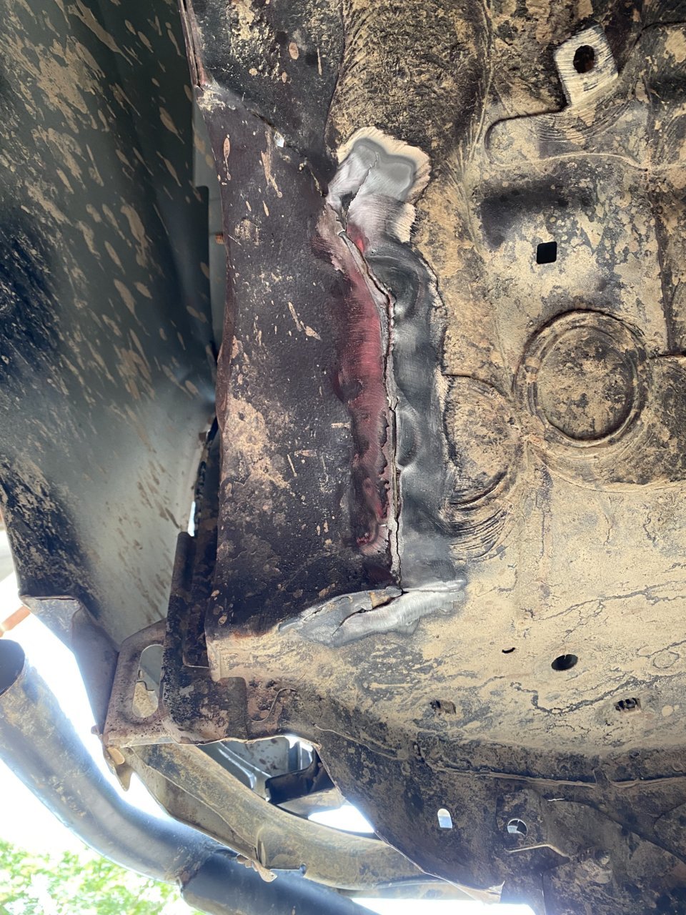

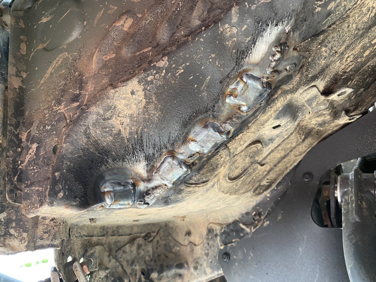

    Underneath my battery where I tubbed, a crack had started forming. I drilled the ends, welded it shut and added some 14 gauge reinforcement to try and help hold it together. We’ll see how long it lasts.

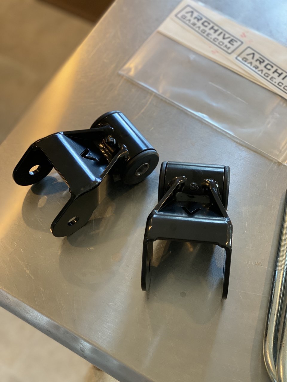

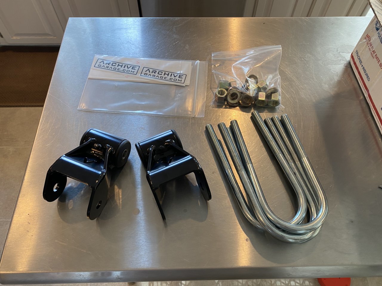

    More beef thanks to archive. I’ll have my stock shackles with poly bushings for sale in the next few days for cheap if anyone is interested.
