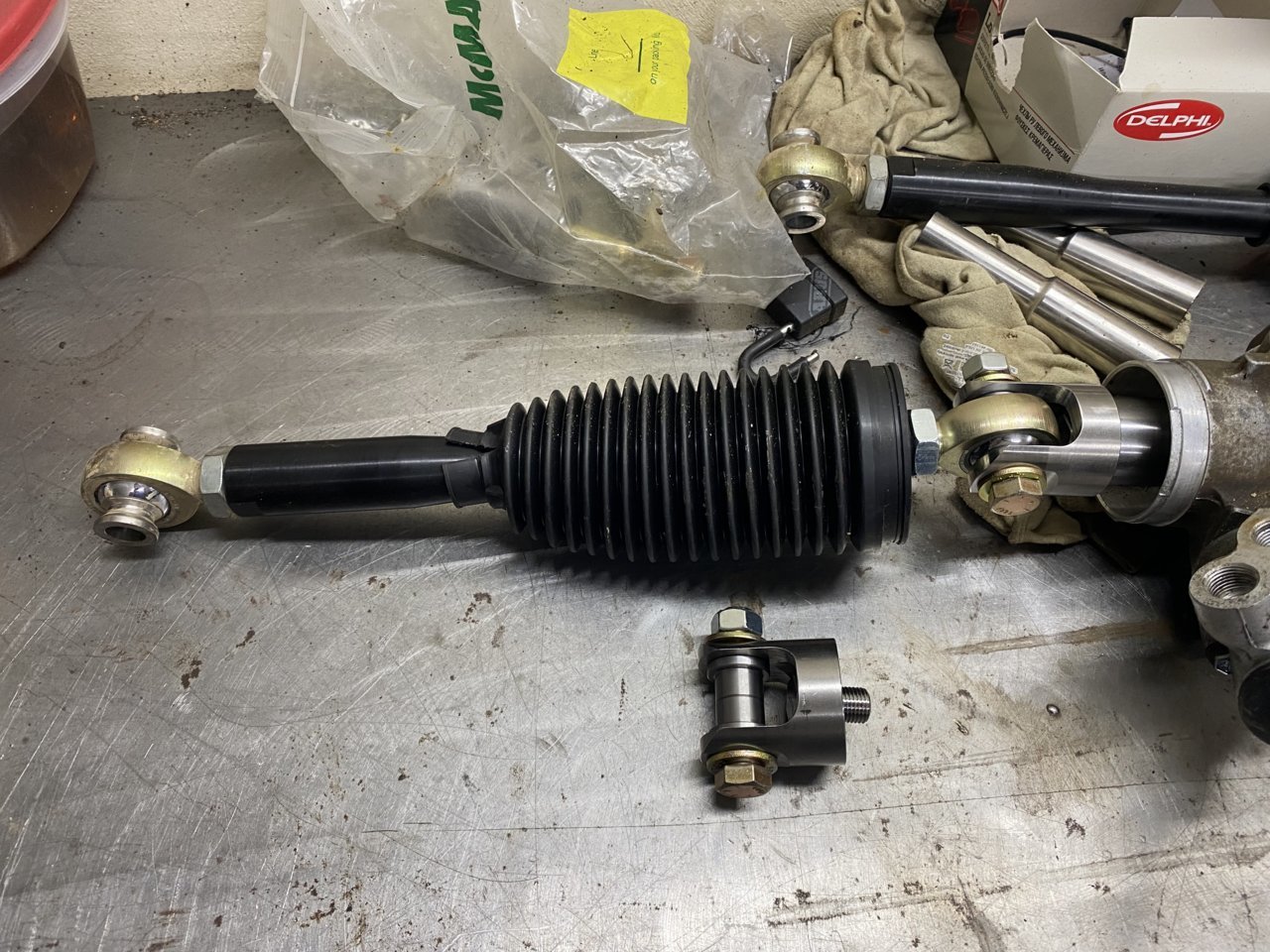

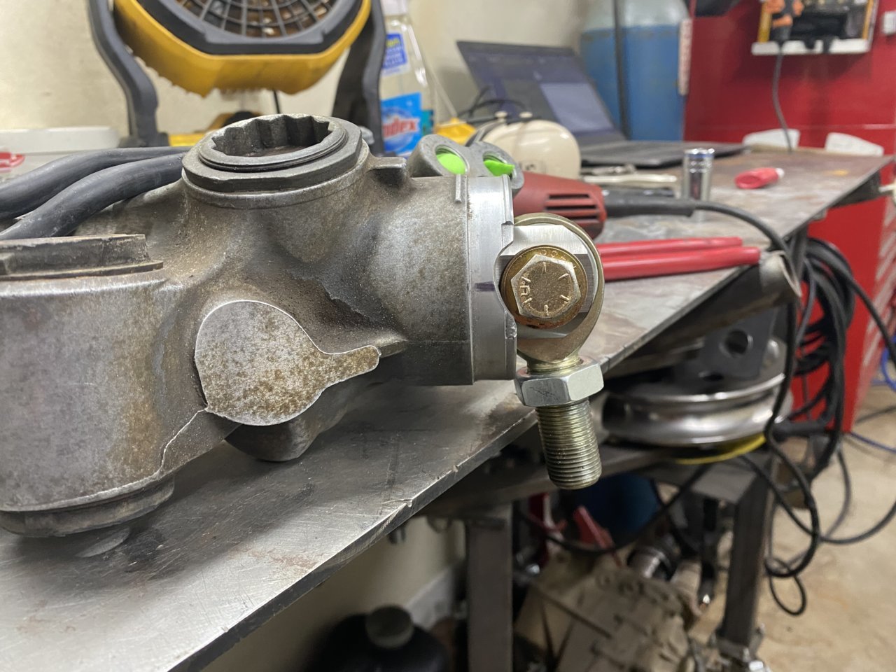

    Final piece of the puzzle arrived today, the adapters from camburg.

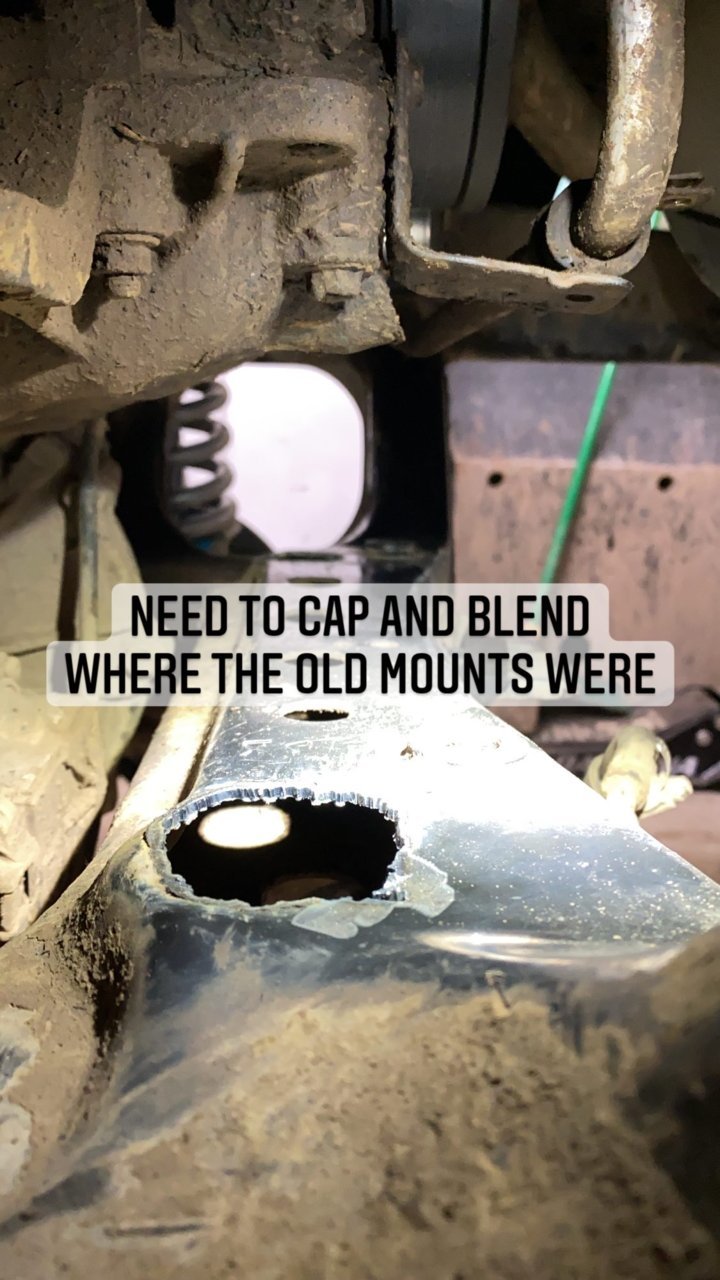

    I’m all finished for today. All I have left to do is cap where I cut out the old mounts, weld in new ones and bolt everything up.
    There’s more pics on my IG story.
    2509D417-4613-4597-AF35-1B69C124D0CF.jpg 707B0BA5-8FDF-4E9F-B9D1-89D040BA03B2.jpg FF2049B9-4C9F-4D5B-A73D-B6409E70BD7B.jpg

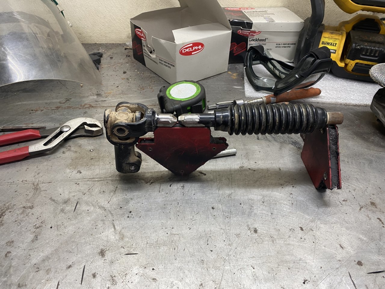

    Another relevant photo. The intermediate shaft gets shortened by an inch. Cut a section out and welded it back together.

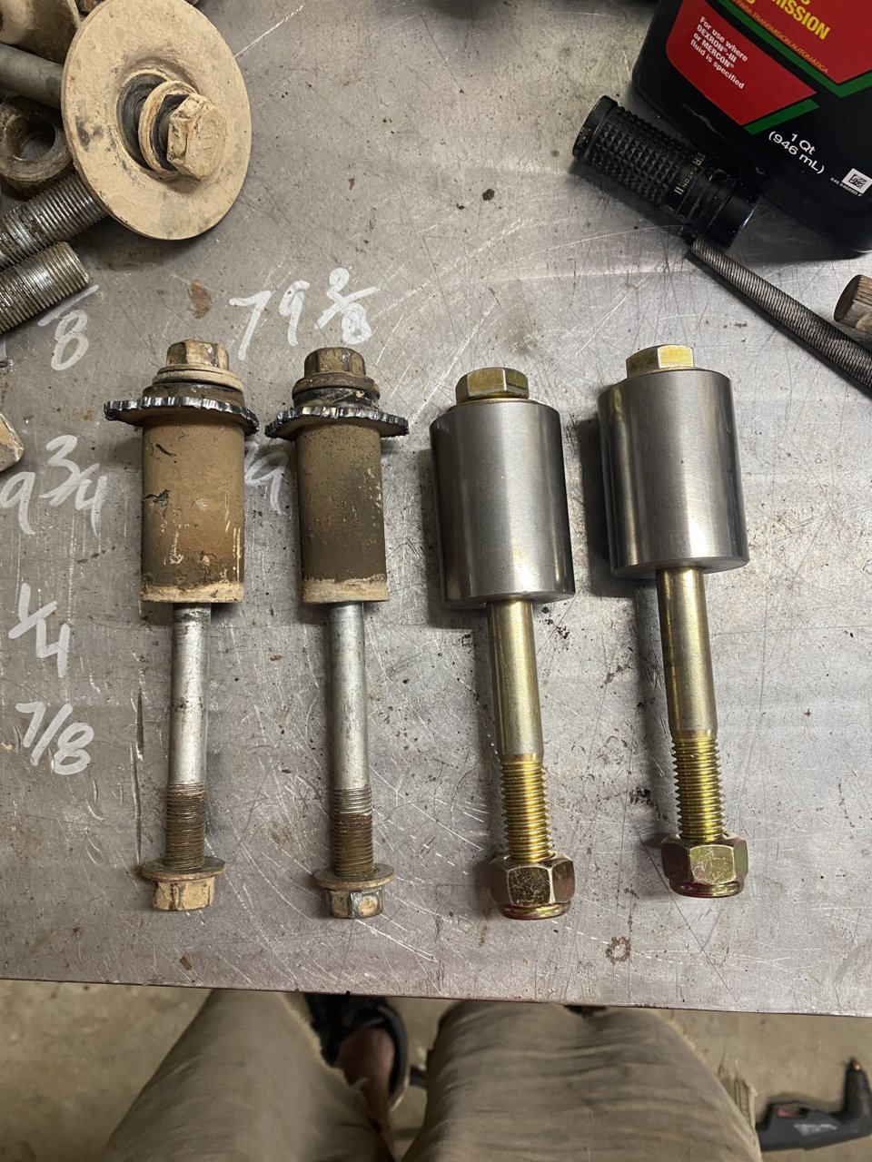

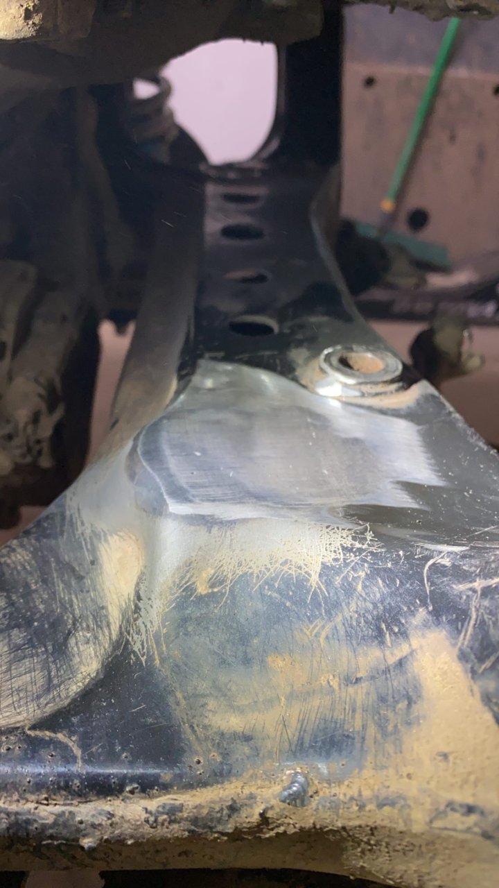

    I got the holes capped and started working on fitment of the rack. Turns out my engine mounts are old and sagging so the rack simply won't fit. I put an order in for some solid engine mounts to lift it back up. Truck will be on stands for about a month now.
    5F1EB08F-3DEF-4D64-9DE9-2D3C198E9F43.jpg 29192AD5-572D-4F1C-88AD-1028F61533E9.jpg
