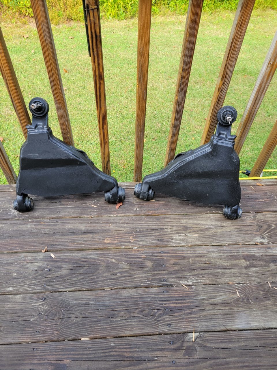

    Recognize these? Have to get these and the spindles, wheel bearings installed this weekend...ugh

    Those look sharp with a fresh coat of paint
