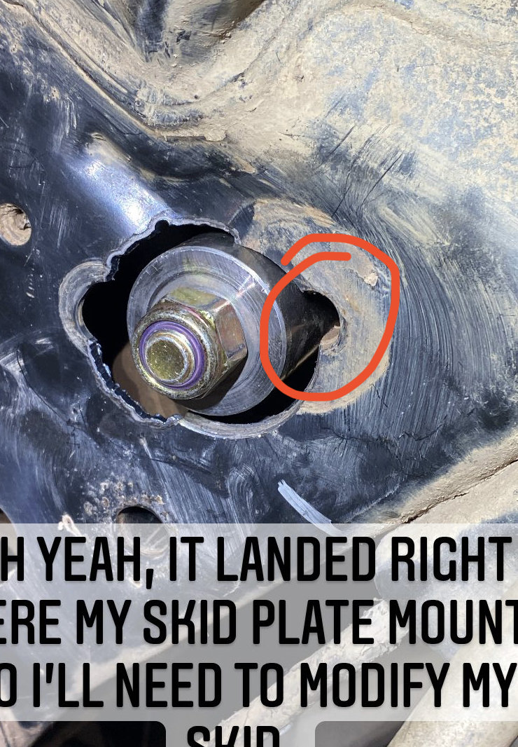

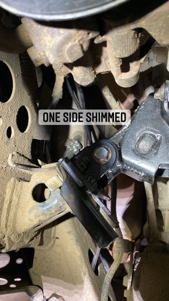

    We’re cooking with gasoline now boys. I have the mounts tacked in and the rack is within 1/32” straight front to rear and side to side.
    Added 1/4” engine mount shims and now I’m much more comfortable with the room.

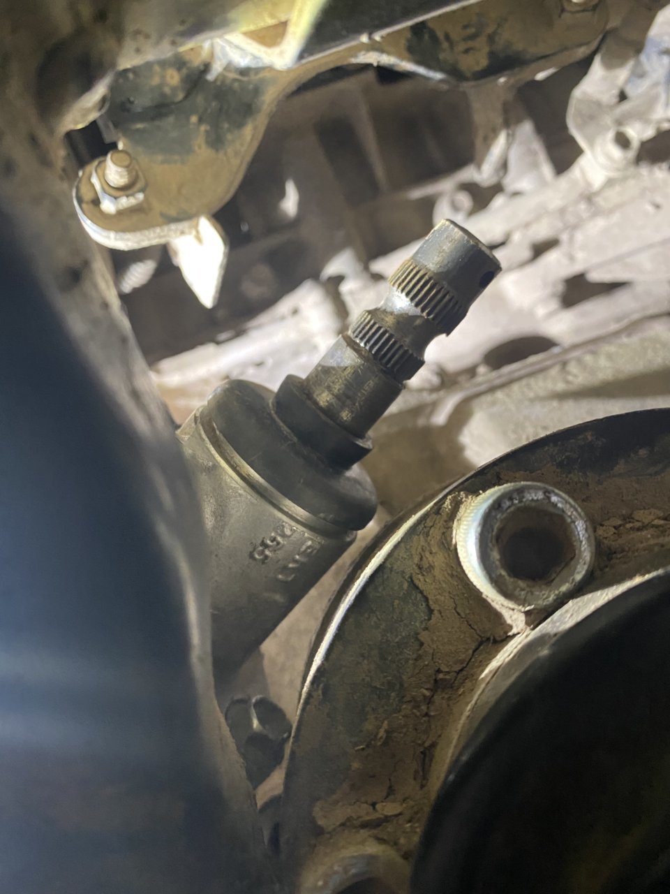

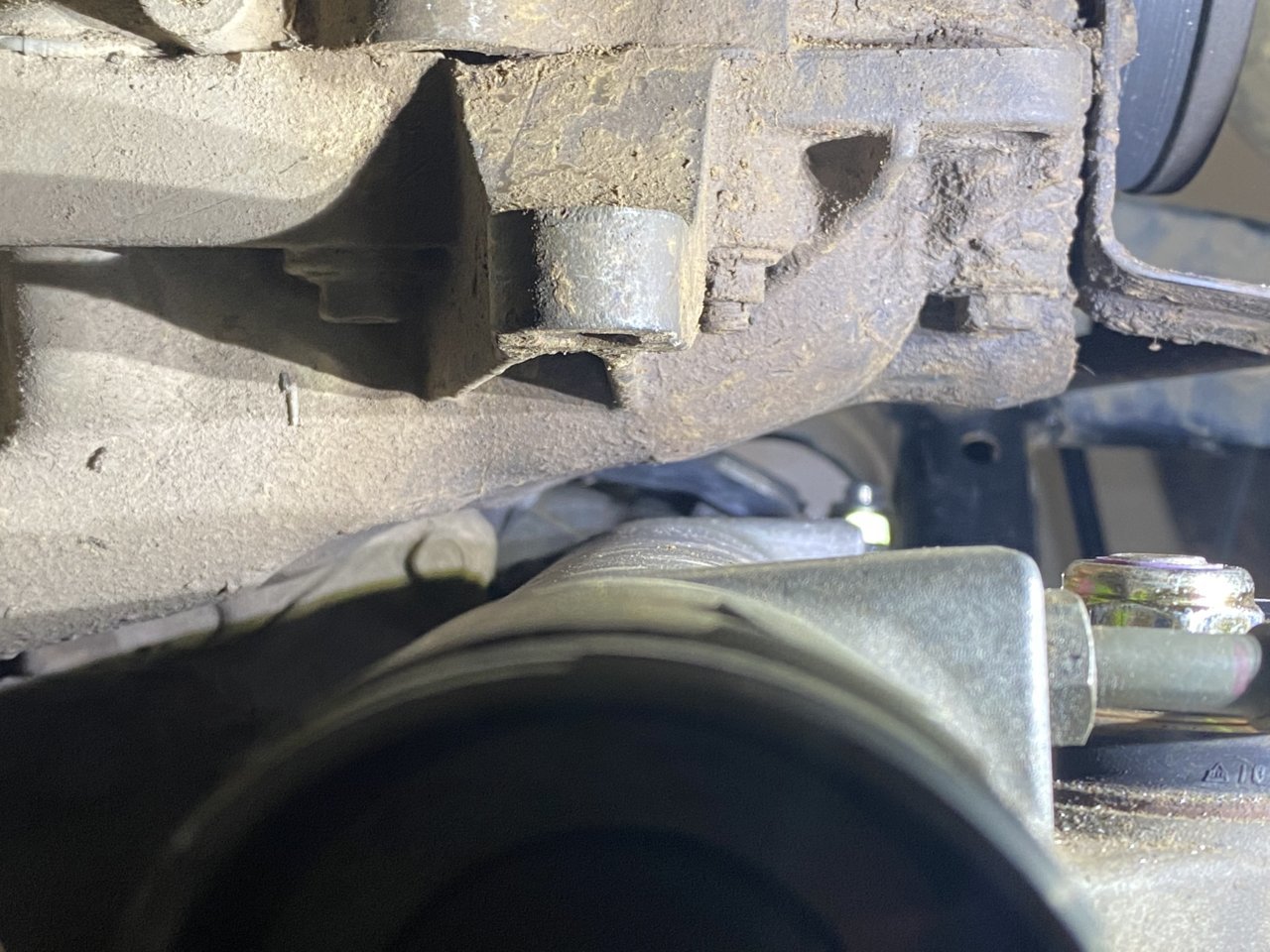

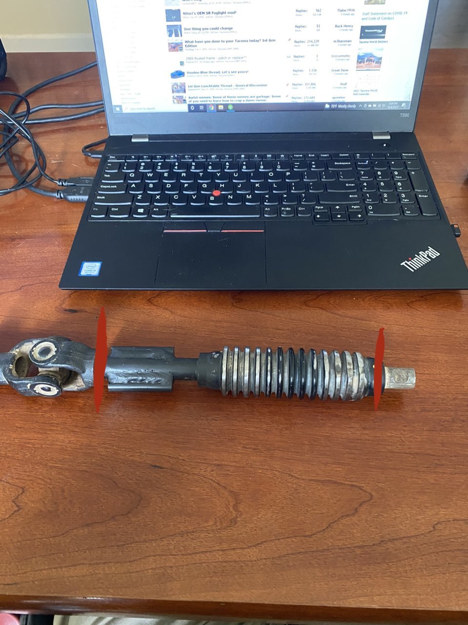

    Pic of the engine mount shims.
    Now that the rack is fitted and tacked in, I put the intermediate steering shaft on to test clearance. These coils are a crumple zone but touch the frame ever so slightly. So I’m going to cut it out and replace with some tube.
    Things left:
    • fully weld rack mounts
    • Modify steering shaft
    • Modify skid plate.
    I don’t know if I shared in here but the passenger side of the rack landed right where my skid plate mounts. So I’ll modify my skid to bolt up with the steering rack bolt.

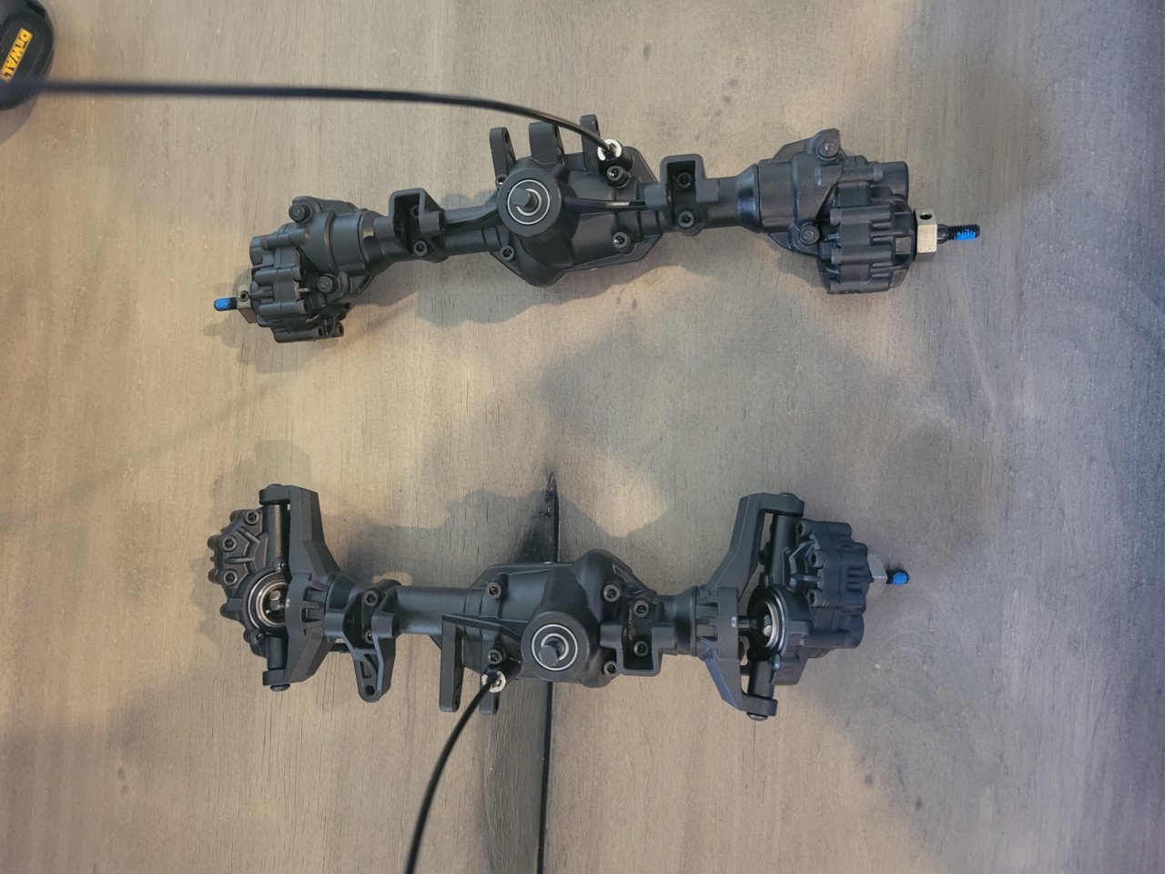

    Got the axles done. Now onto the chassis!
    Slashaar and EatSleepTacos[OP] like this.

    Are those lines coming out of the axles for selectable lockers? Very cool.
