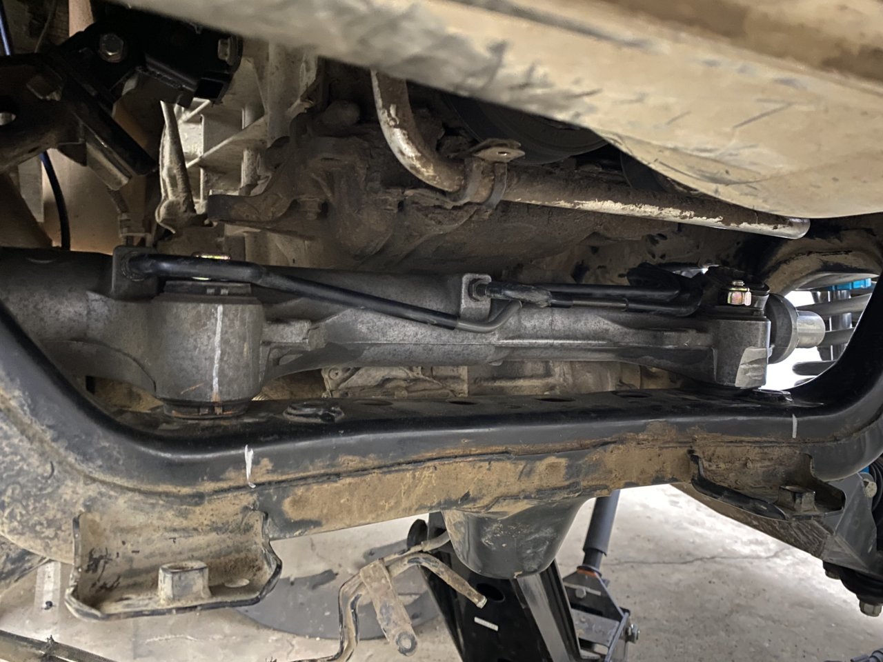

    SHE’S IN. HALLELUJAH.
    Just need to paint the crossmember and then I get get it all hooked up as far as hoses, tie rods, etc.
    After that, all I’ll need to do is modify my skid to bolt back up and modify my steering shaft, which that metal arrives today. Should be done sometime next week.

    Boom, done. Now just need to paint it, reassemble my truck, and modify my skid.

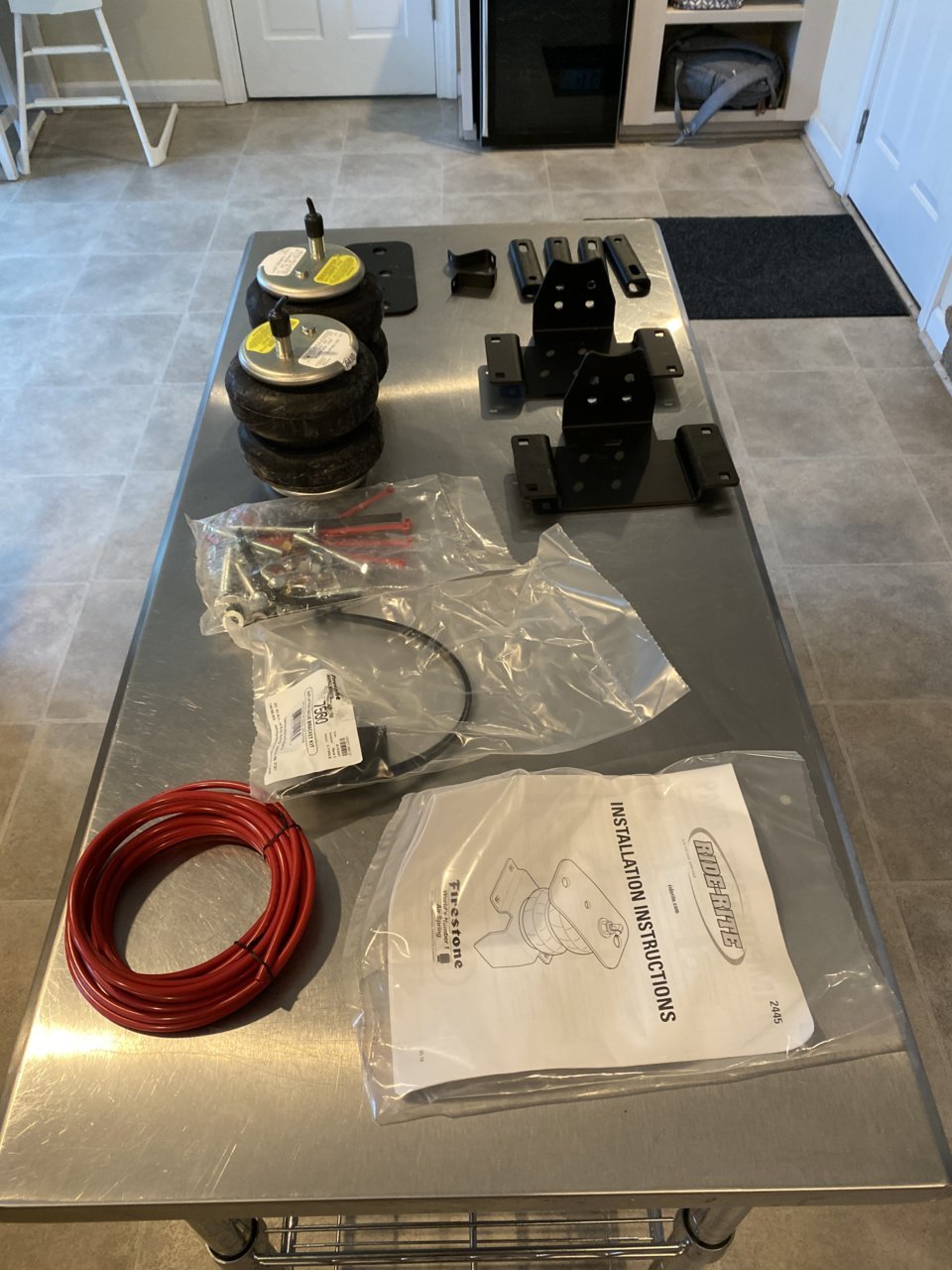

    Airbags showed up for the tundra today. I bought it from Amazon warehouse and saved $80. It’s brand new, only open box.
    If you’re not in a big rush for a more expensive item, I recommend buying “used” because there’s no risk since you can just return it if there’s something wrong, which I’ve only had to do twice.
    If it’s “sold by” Amazon warehouse and “like new” then 9/10 times it’s just open box.

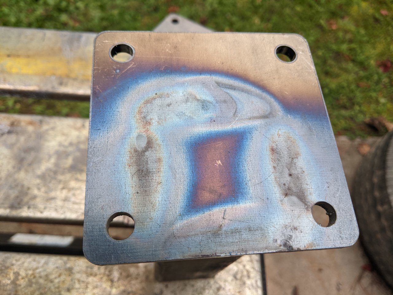

    Started welding some of the slider parts. Seems to be able to heat up the base 1/4" piece well. Now the only issue is I can only weld 1-3/4"-2" before popping the breaker lol. Getting a tad bit of undercut, so may back of the sauce and maybe that will fix both

    Yeah if you’re getting a little undercut and that heat coloring, you look a little hot. Tripping the breaker was the same issue I used to have with the titanium. Oddly enough, the Vulcan doesn’t have that problem even when on 120v.
