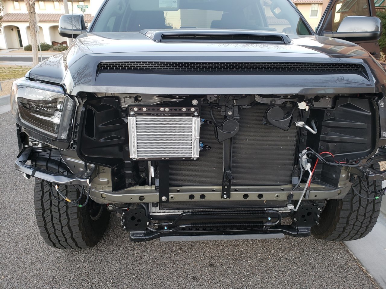

    Purchased a trans cooler for the tundra last night. For whatever reason, Toyota decided to remove on 19-21 tundras. Just driving down the highway I was seeing temps right at 200 and when I would exit, the torque converter would jump up around 210-215 from heat soak. Supposedly it’s ok from reading the forums, but it’s easy to hit high temps while towing.
    Since I’ll be up there in weight as well as regularly towing over hills, I thought it would be beneficial to add an aux cooler.
    https://genuinecoolingsystems.com/product/mhx-514-complete-kit/

    Side note, on a hot day my temp shoots up like crazy when im in park, not driving and even in traffic sometimes. When im driving and pressing the skinny pedal its fine. Is this going to help with that?

    It should, yeah. Users are reporting temps consistently staying between 185-205

    Having the transmission thermostat in that kit is good. I just plumped in the cooler in series with the OEM trans fluid cooler/warmer in the radiator and now I've got it decently blocked off in order to get up to temp lol.

    It’s a super solid kit. All oem parts, except the cooler obviously. I watched an install video and it’s super straight forward.
