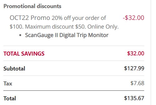

    Advance Auto carries scangauges apparently and they almost always have 20% off if you buy online and pick up in-store. Saved $32

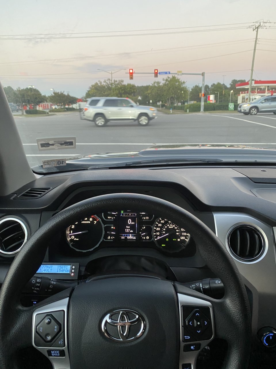

    My edit was too slow. I have no idea about programming an UG, I didn’t have to add anything to monitor what I wanted in Betty. And I just put a scangauge in the tundra today. Programming that was easy.

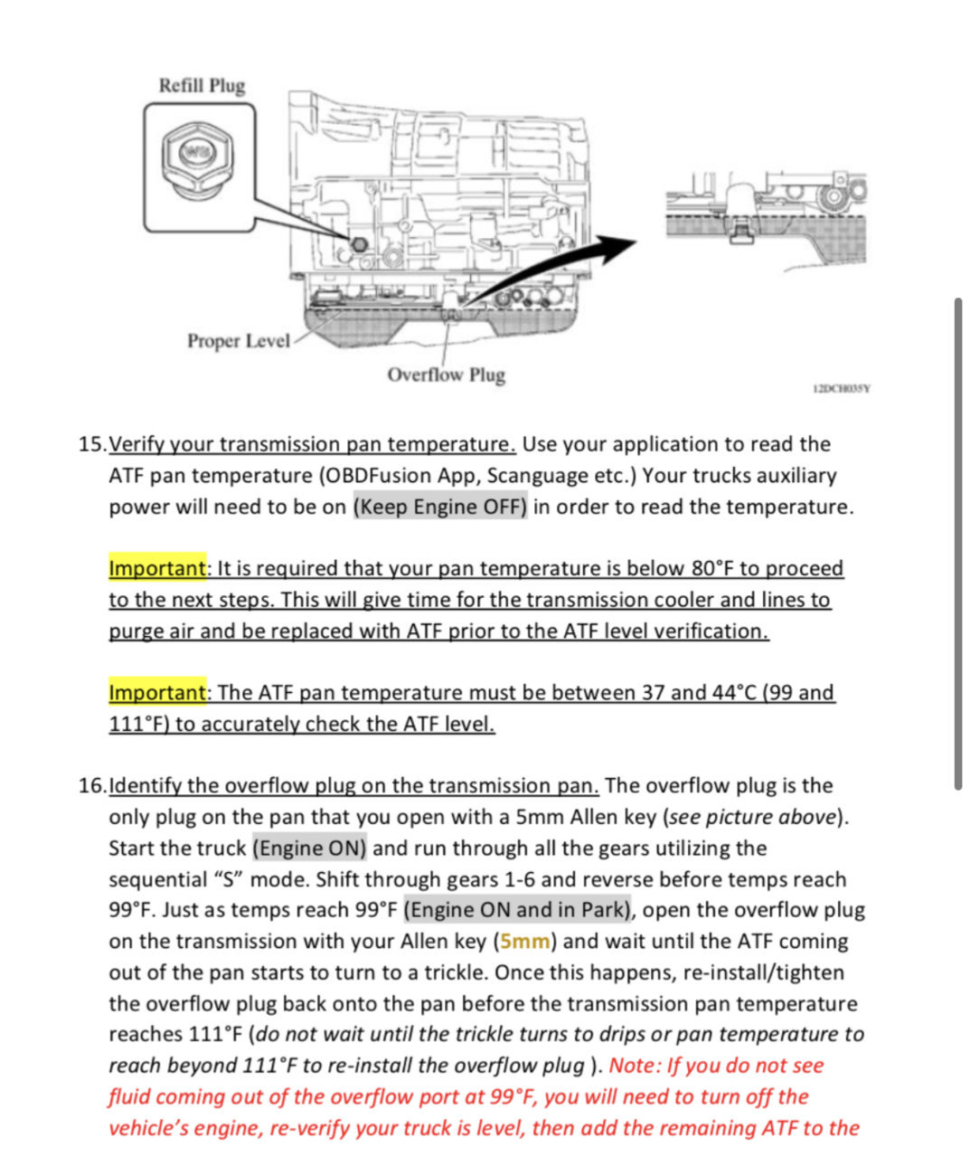

    Did that tundra have an actual trans dipstick or was adding the extra fluid a pain in the ass??

    #151688
    59,835
    Randy
    West Valley, AZ
    2017 4Runner
    It’s similar to second gens afaik, or maybe the third gens? Fill through the fill plug, then in a very specific temp range, pop out the level plug and let some drain out until it reaches appropriate level.

    Did you not add any with the new cooler??
  15. Oct 15, 2021 at 7:22 PM
    EatSleepTacos
    EatSleepTacos [OP] Well-Known Member
    Mar 24, 2015
    #151688
    59,835
    Randy
    West Valley, AZ
    2017 4Runner
    I will. Add 1.5 quarts then drain off the excess with the aforementioned procedure.
    Here’s a snippet from the instructions.

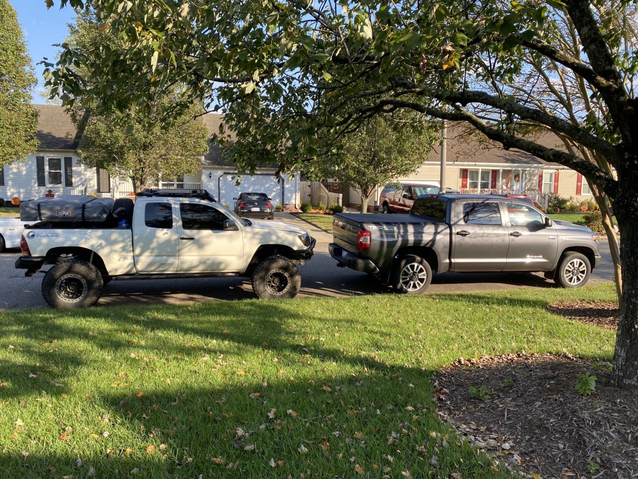

    https://www.tacomaworld.com/threads/singletrack’s-‘dad-shred-build-thread’-i’m-just-doing-it-for-the-kids.619250/ Sos offroad sliders (kickout + filler) Sos offroad full belly skids (steel) Sos offroad front recovery point Sos offroad concepts HC rear bumper with bedside kickout tubes Marlin Crawler LCA frame brace kit Trail Gear rear diff cover Bilstein 5100 + OME 885 Total Chaos UCA BILSTEIN b110 OME Dakar standard pack Wheelers Ubolt flip kit Wheelers Superbump f/r Wheelers SS extended brake lines FN five star 16x8 -25 Milestar Patagonia MT 315/75r16 Custom projector retrofit (acme super h1 + morimoto 4300k) Baja Designs S2 sport ditch pods on CBI ditch pod mounts Amazon AMAK rock lights CMC CB radio hardmount
    It’s so crazy how much larger Betty looks even in reality it’s a much smaller truck with such a mild lift… so crazy

  20. Oct 16, 2021 at 3:10 PM
    EatSleepTacos
    Mar 24, 2015
    #151688
    59,835
    Randy
    West Valley, AZ
    2017 4Runner
    That the rack isn’t worth the cost or effort. We’ll see though once I get more seat time, especially off-road.
