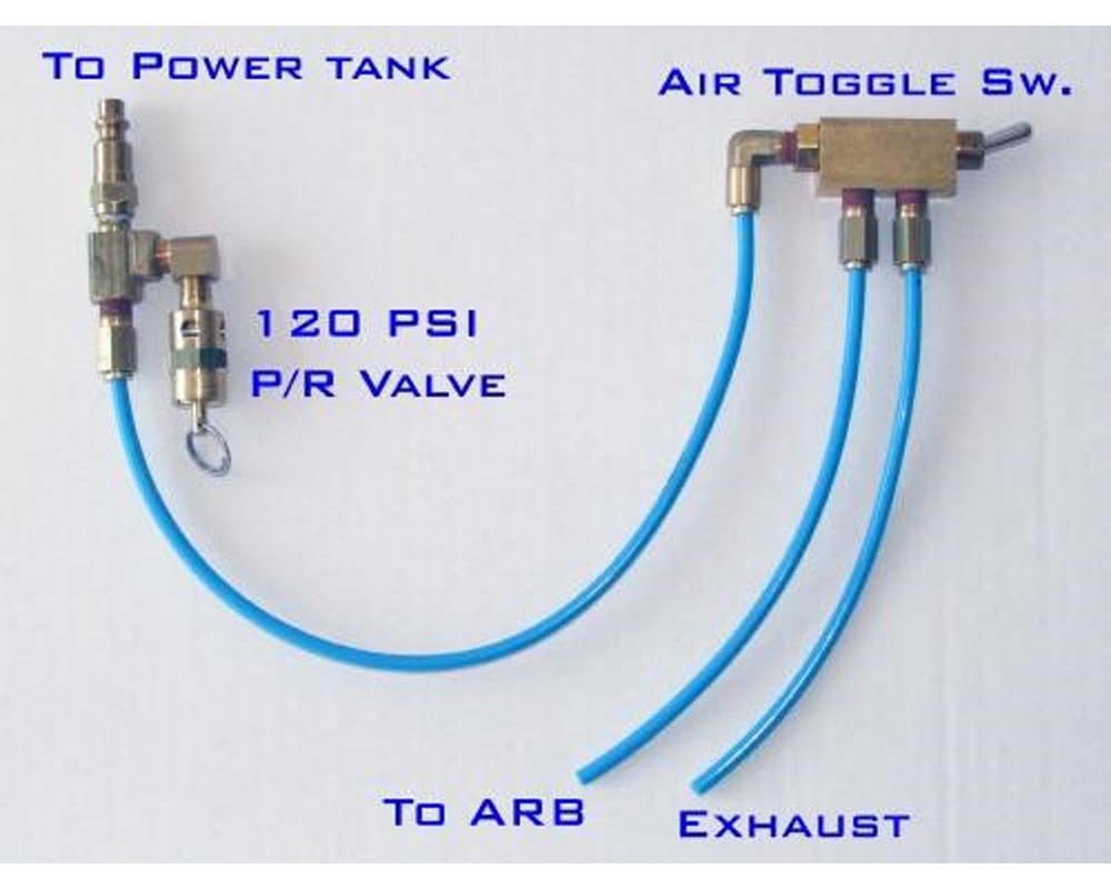

    I’m not sure how a ball valve operates so I don’t really know. Is that just a simple on/off? But I do know the solenoid releases the pressure to the atmosphere when undone, which unlocks the locker. Would a ball valve accomplish that?

    Ball valve would just be simple on/off. there's a ball inside that has a through hole down the center, so turning the inside ball 90° cuts off or allows flow. Would like manually turn a little lever under the hood or something. Was just a random thought that I figured I'd pose to the more experienced. I'll actually wire something up when I get there, because I want to learn more 12v stuff

    That’s what I thought it was. Then the question would be how would you exhaust that pressure into the atmosphere to unlock the locker? Unless you rigged up a little manifold with one ball valve going from compressor to locker and another one going from manifold to atmosphere.

    Just put one of those pull ring pressure releases on a t-fitting between the locker side of the ball valve and locker. Shut ball valve, pull ring to vent.
    That said, the amount of plumbing is getting dangerously close to that of a full ARB air setup anyway, so just do it.

    Definitely always good to ask questions. Sort of inline with that you’re asking, powertank offers a pneumatic toggle switch for lockers, it’s pretty nifty. I ran my front locker off of my powertank for a little while. You just set the adjustable regulator on the tank for 90 psi.
