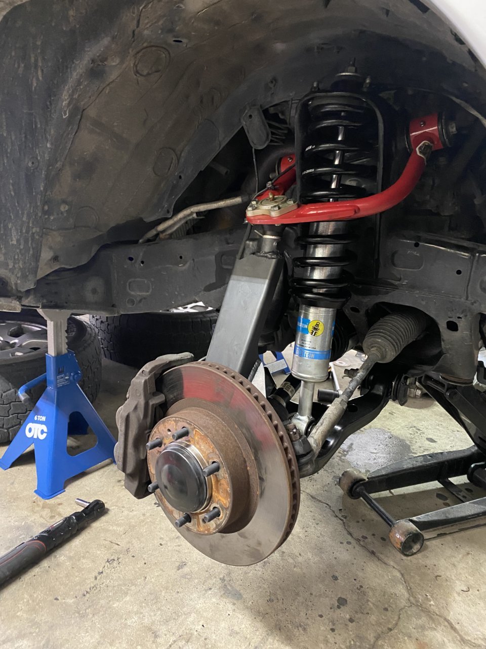

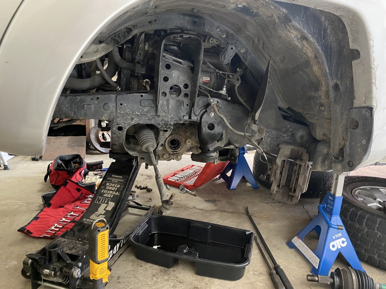

    Did a front end rebuild on Pauls truck today. Total chaos cam tab gussets, gusseted spindles, new lca’s, UCA’s, wheel bearing assemblies, and bilstein 6112s with new top hats. Original CV’s but once we got a closer look at them, the boots are pretty rotted so we’ll rebuild them at some point. Pro tip, when total chaos says you need wheel spacers on stock wheels for their spindle gussets, they’re not joking. That thought didn’t even cross our mind until he went to back out and the front tires wouldn’t move. The wheel weights were gouging into the spindle. Luckily a buddy 10 min away has a spare set of spacers so he saved the day.

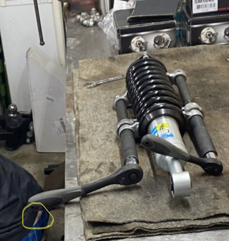

    @EatSleepTacos I think I know what it is/what it’s doing but what’s that tools name? 5AF452F8-3817-4D18-8028-0D35D24CCA29.jpg

    That’s called a box wrench

    This tool

    It’s like the shitty auto store rentals but on steroids.
