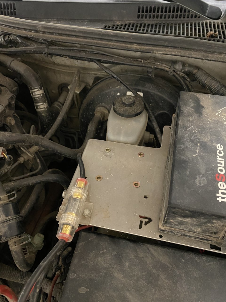

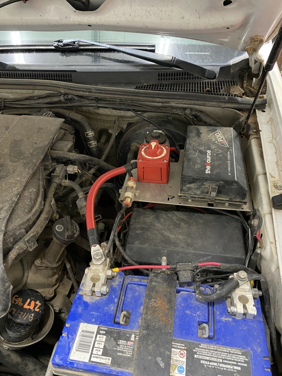

    Finally got around to adding a winch disconnect. The idea behind it is to isolate the thick un-fused wire in case of an accident. You don’t want that thing flopping around and causing a vehicle fire. You drive around with it off and then switch it on before you hit the trails.

    Fortunately, I had an Anderson plug on mine. It came unhooked during my accident and probably saved me from going up in flames.
