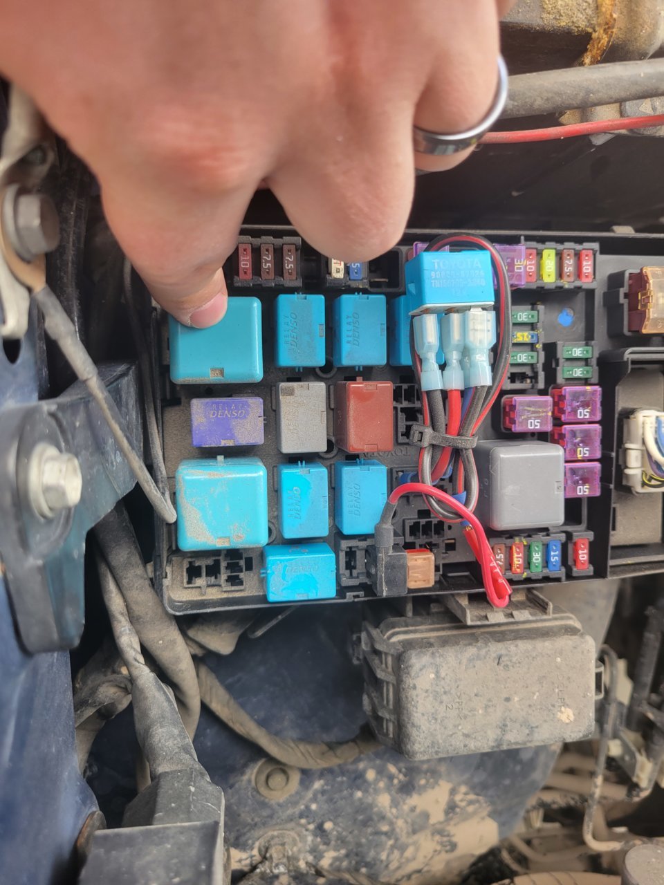

    Heater relay seems to be clicking when the switch is turned off and on. Was going to try to switch it with the other one across from it, but can't get either one out. The engine noise also changes when the switch is turned on indicative of the ac compressor engaging.

    Ok...not the relay. Swapped it and problem remains. So that leaves me with blower itself (115), switch assembly(700 new, 160 from a wrecker), and blower motor resistor (40 with the new wiring and pigtail) All of which are pretty expensive

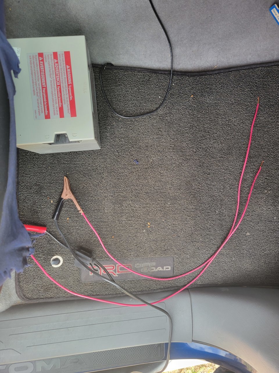

    You could supply 12v right to the motor and see if it fires up, just a quick test.

    Find a 12v battery, like a drill battery and use a couple of wires to send power to the motor

    Smarter than I thought. Used the battery from my son's power wheels and rigeged something up. Blower motor is good.that leaves wiring, switch, or resistor. I looked under the hood and didn't see anything obviously damaged or abnormal.
