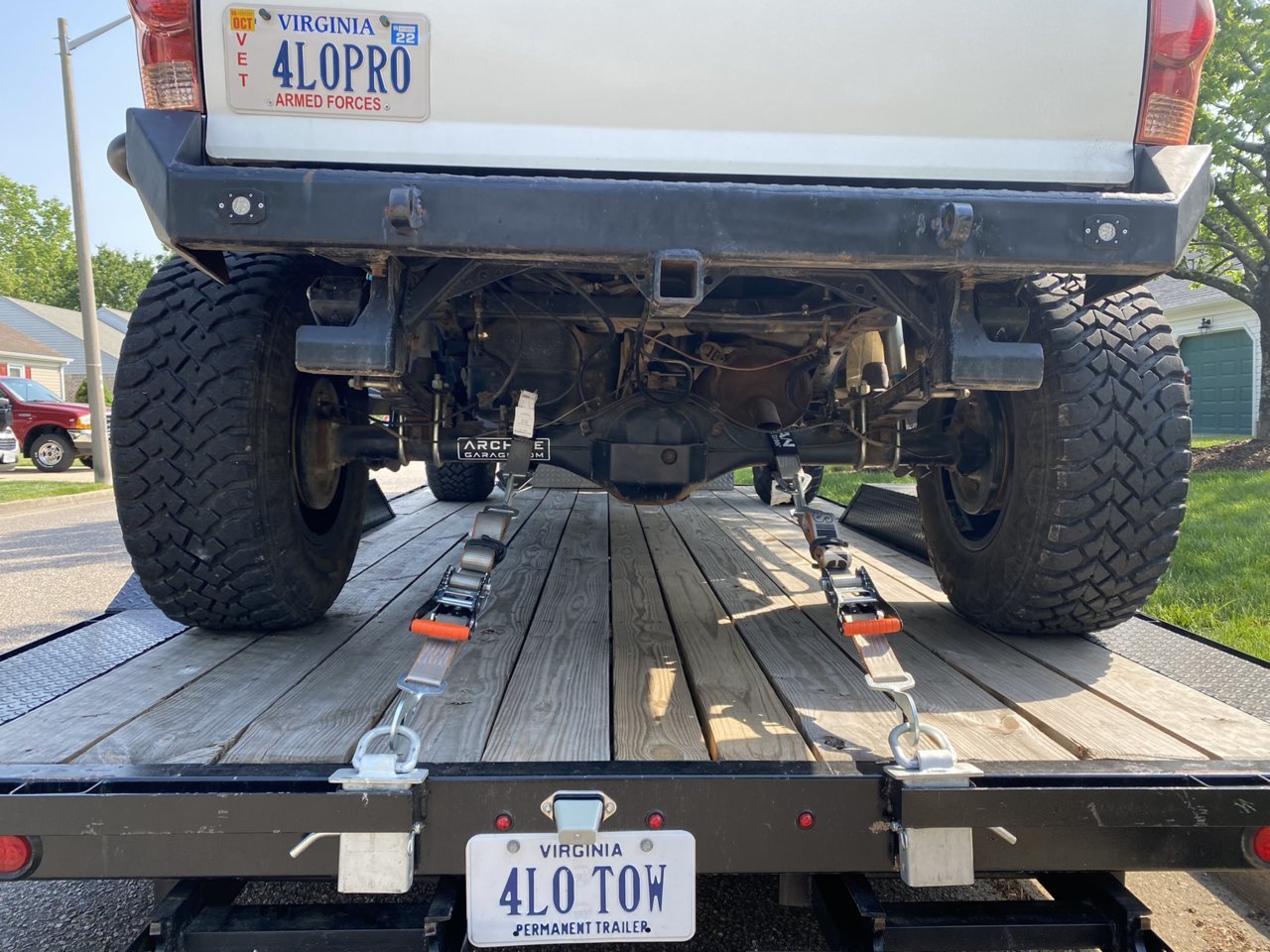

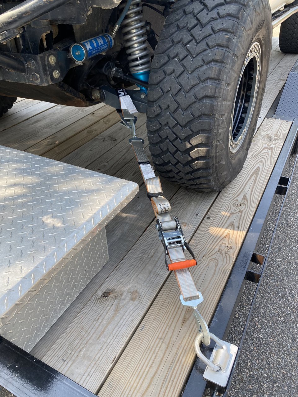

    Before I started towing betty, I wasn't sure of the best way to secure her on the trailer. When transporting a vehicle, you want to hook to something unsprung, so that way the straps stay tight while the truck is bouncing up and down on the trailer. There are a few different ways to do it, but I decided on hooking to the LCA and the rear axle. Another common way is to go through the wheels, but my chewed up beadlock rings may chafe the strap. Another way is over the tire, but that's trickier to set up on my trailer and is usually used on car transporters that have a million tie-down points.
    The LCA does move a little bit as the suspension moves, but not enough to cause any issues. I got all of this info from the long travel thread on here and LCA/rear axle was the general consensus.
    It's also common to see people create an X with the straps to eliminate side-to-side movement, but that's not recommended. If you lose one strap, the other is useless because they're pulling against each other. Going straight back gives redundancy. Ideally, the front straps would be straight as well but my options are limited with my trailer and my ability to add more tie-down rings.
    I've been very happy with the two products below.
    https://www.amazon.com/gp/product/B07PCWD7FZ?ie=UTF8
    https://www.amazon.com/gp/product/B07YQ1VX4T?ie=UTF8

    Ok. Just wondered. I see them used by the big car hauler guys and didn't know.

    I'm sure they're fine, a big selling point of those for the car hauler guys is they're so versatile, they'll work for a myriad of different vehicles. Versus my setup wouldn't work for anything other than a truck, but that's ok because that's all that's getting up the ramps of my trailer.

    Look into Shock Straps...they've got a "band" that stretches as you tighten the normal nylon ratchet strap, but as items bounce and move, be it trailer bounce, suspension flex, etc. The band essentially takes up the slack, keeping the straps taught.
    https://smile.amazon.com/dp/B08ZGYJ3RQ
    Good video overview of the general features...https://youtu.be/Tz84Fpmel48

    That’s what’s nice about strapping to unsprung parts of the truck, the straps are always tight. That is a cool product though.
