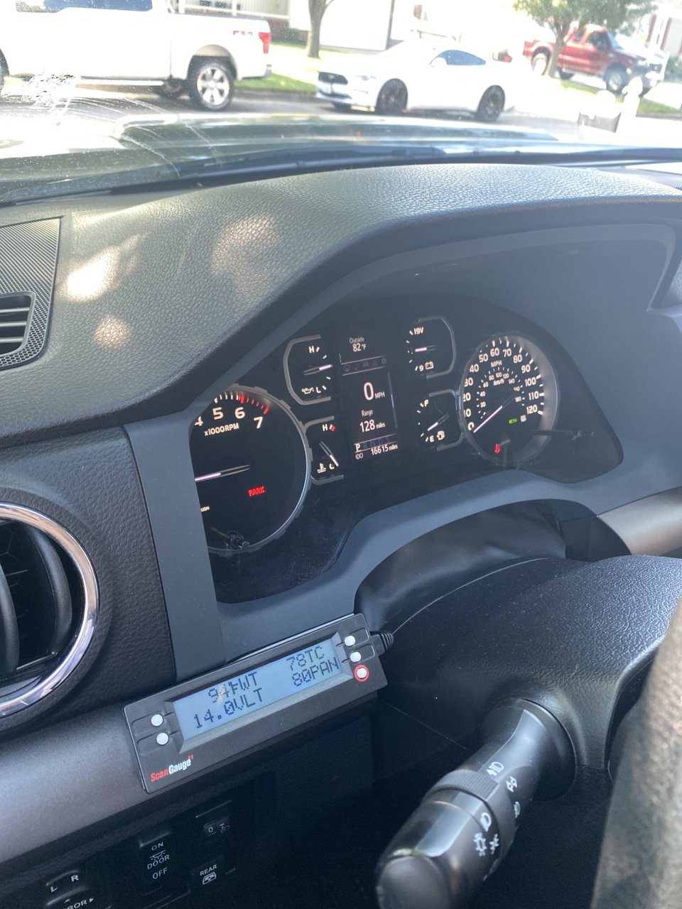

    If you were going to invest in a gauge, would you go scan or ultra?

    I ended up going scangauge in the tundra because I think it looks a bit nicer. Have you seen where I mounted mine?

    Yeah. On the column off to one side or the other IIRC.

    Yeah it’s just stuck on with some double sided tape. Very easy and looks clean.

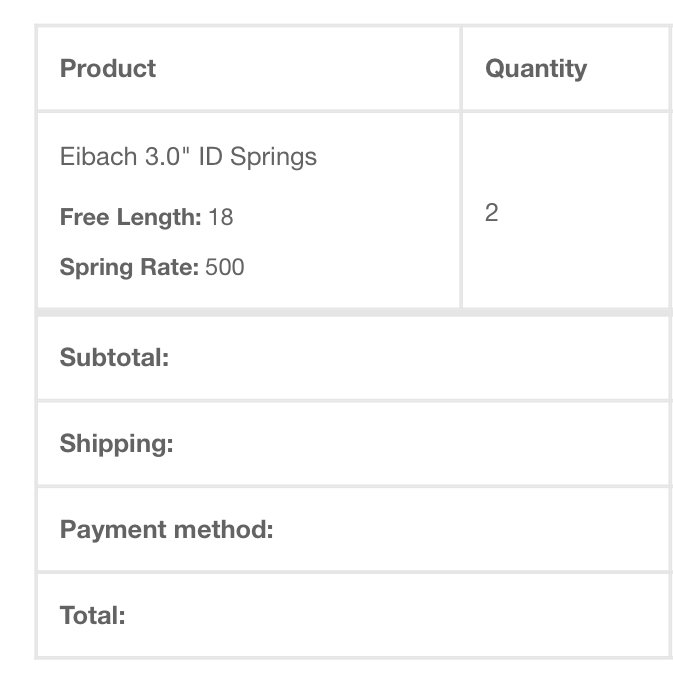

    Before I go clicking around everywhere. Randy you’re running 500lb 16” coils? Couldn’t remember the length.

    I’m about to tattoo 18”x500lb to my forehead

    I swear. I finally get the weight right, but not the length. It’s cursed…because I can’t be this dumb. I just can’t.

    Yeah I just ordered some. I adjusted my dual rate sliders to engage the stiffer coil sooner in the rear and push some more work to the front and that helped, but the front still needs to flex more easily. Hopefully this will do it
