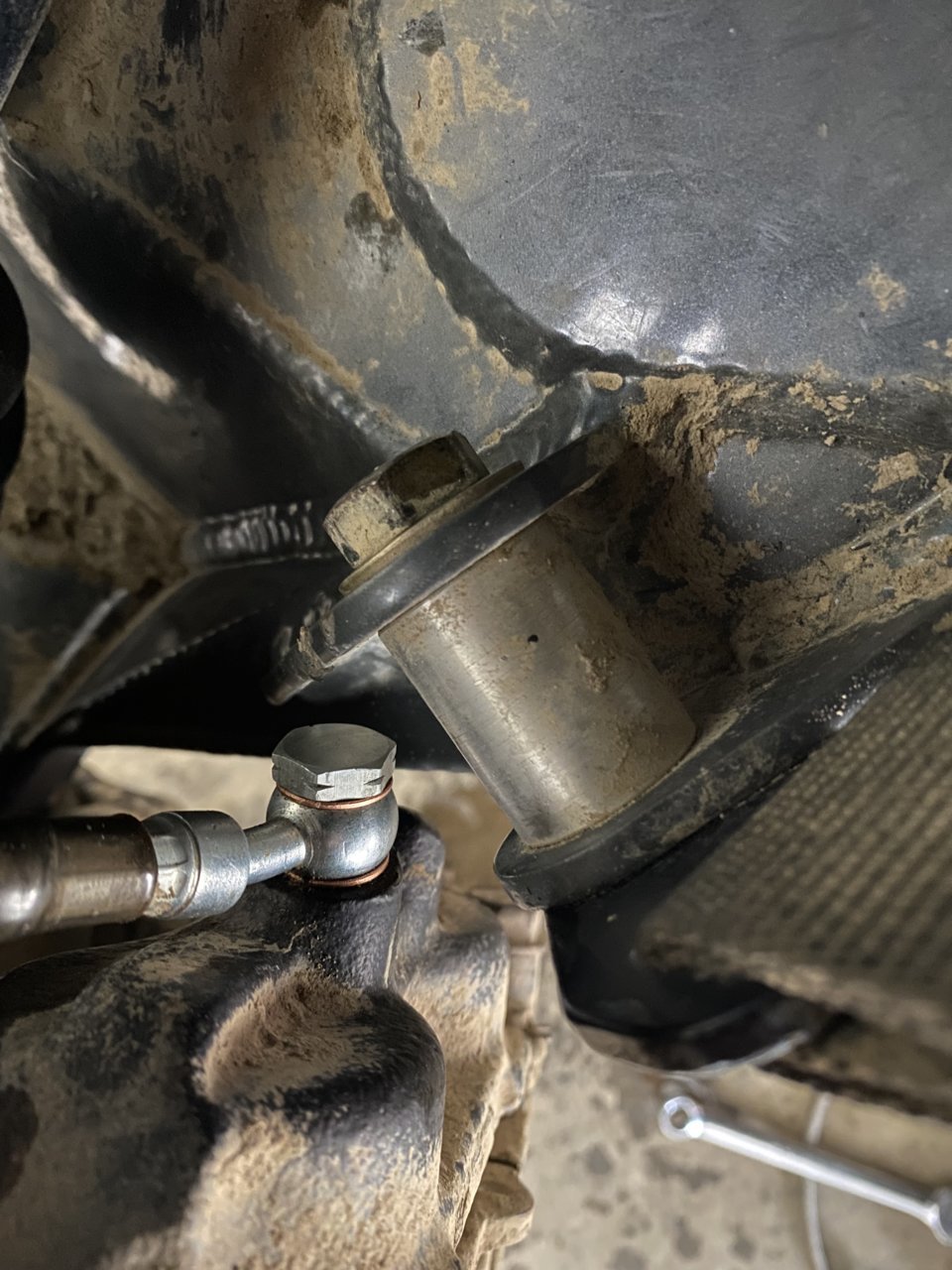

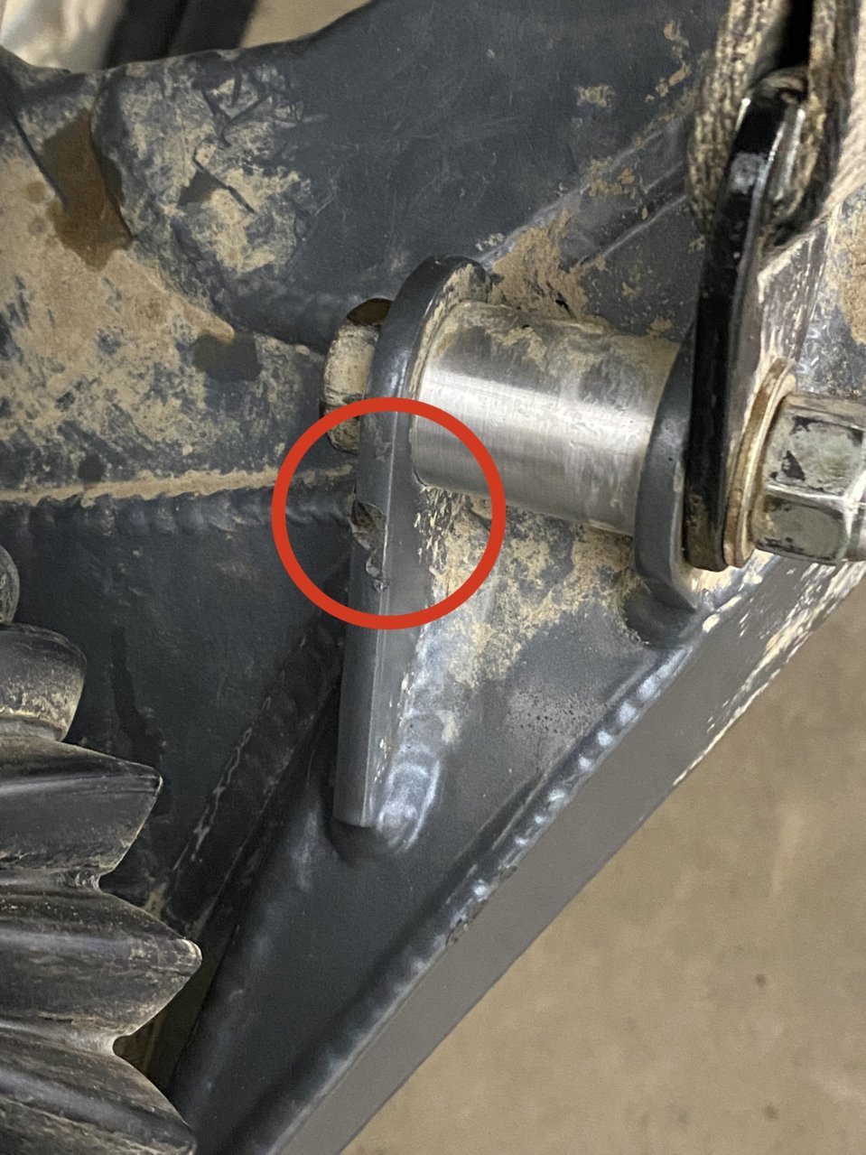

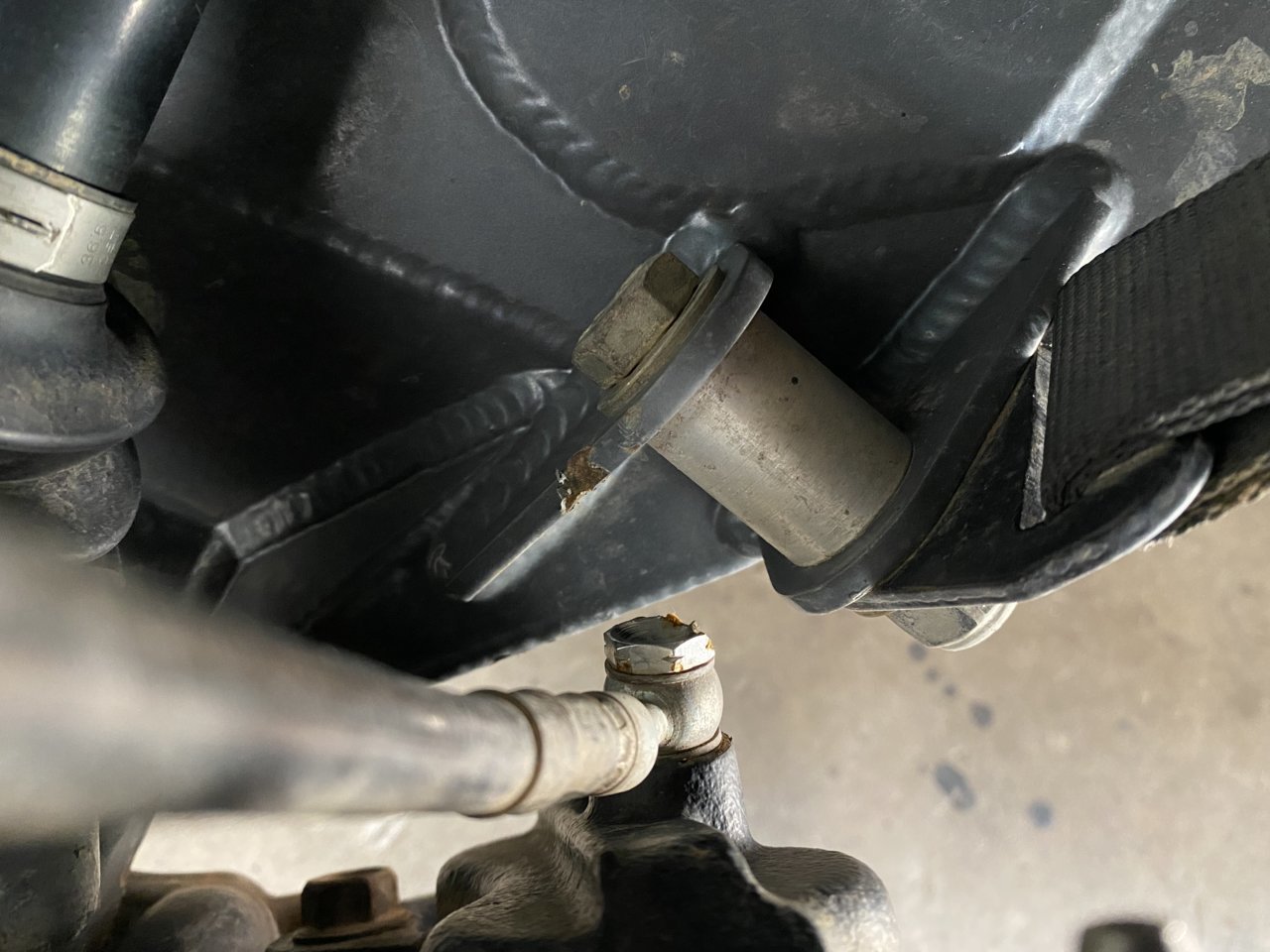

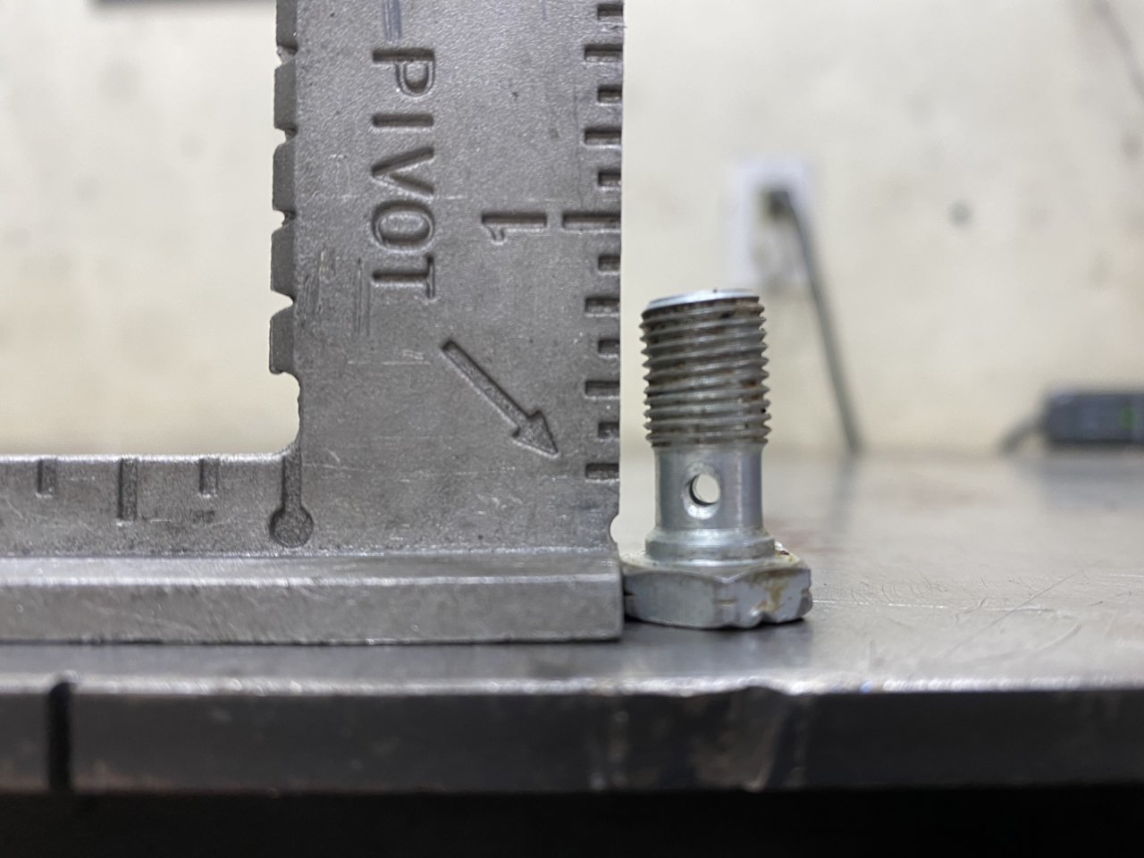

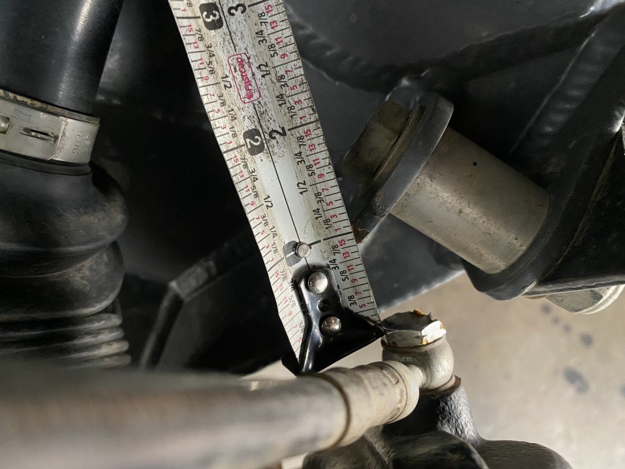

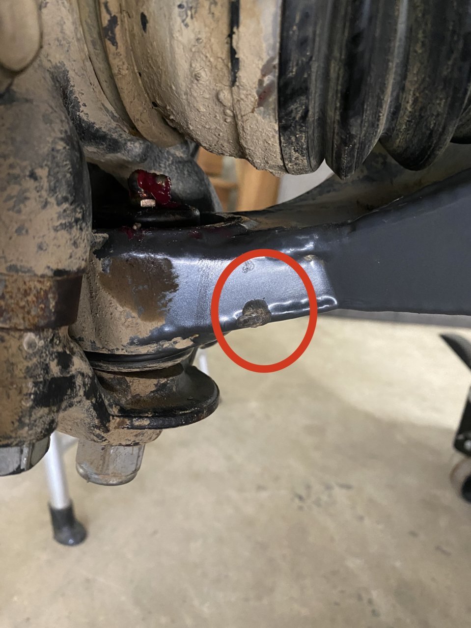

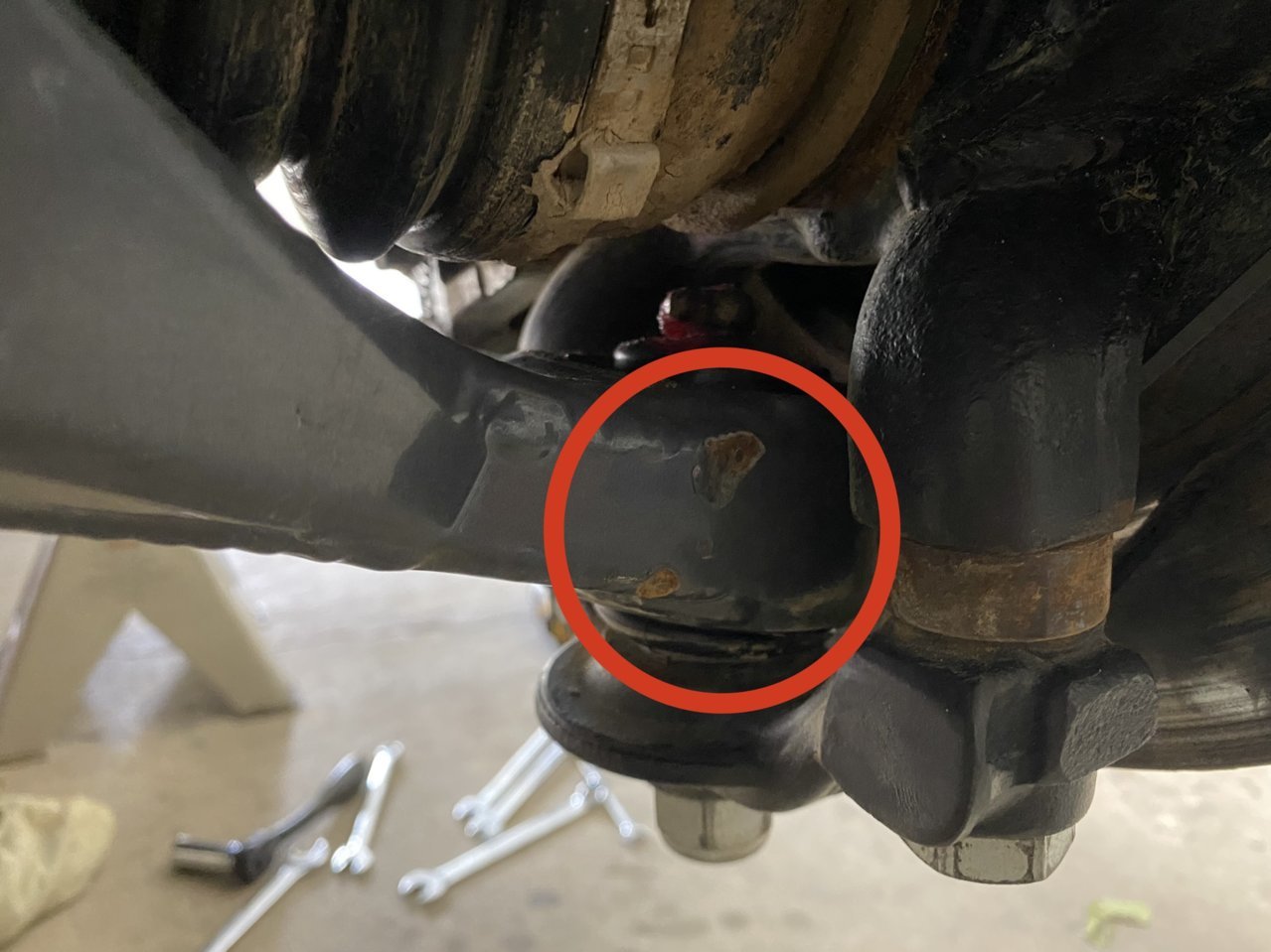

    As a whole, I like my JD 2.25 long travel kit. I currently have the uniball bushings, 934 CV axles, 8" king coilovers with 18"x500 lb coils, tundra steering rack and heim tie rods.
    When I first installed the kit, I had a stock tacoma steering rack and their double shear heim tie rod end.
    Moving into my experience and the timeline with it. I got everything installed, which includes cutting off the steering stop and went on a shakedown run. At one point, I lost brakes completely, foot to the floor and no stopping power. Come to find out that at full lock and droop, the banjo bolt on the brake caliper (banjo bolt is part of the kit) would come in contact with the secondary shock tab on the LCA, bending it and puking brake fluid. This was due to deflection in the steering rack from rubber bushings.
    I cycled the suspension after the shakedown (which I should have done before) and found out I needed to add a 1/2" spacer to my bump stop to keep the upper uniball from maxing out under compression. Not a huge deal, no mention of it in the instructions.
    I did a shade tree mechanic fix and limited my steering a little bit, but the issue persisted. For those unaware, heim tie rods/tie rod ends transfer more energy into the steering rack. I could feel it offroad and knew it would kill my rack prematurely. So between that and the brake issue, I decided to install the tundra rack. The tundra rack limits your steering a bit due to its design, so I figure I would kill two birds with one stone. Limit steering for my brakes as well as have a stronger rack that can handle the heim abuse offroad.
    I installed the tundra rack and simultaneously installed full heim tie rods. This seemed to have fixed the problems and everything was kosher. Putting a boot on the inner heim proved to be a pain in the butt but I finally came up with a fix, which is nice.
    This most recent trip out, I lose brakes again. Even the tundra rack deflected enough to loosen up the banjo bolt, but the fix was easier this time. I tightened the bolt back up and bled the brakes. When I got home, I shaved some material off of the LCA where it was contacting. The next time the steering rack is out of the truck, it will get polyurethane bushings.
    The quotes below go into greater detail on the brakes thing.
    If I were to do it over, I would have kept the stock steering rack and put polyurethane bushings in it, not cut off the steering stops, and I would have kept the stock tie rod end, no heim. It would have saved money and been a lot less headache. I don't know for sure if it would have removed enough deflection to keep the brakes off of the LCA, but it's a good starting point.
    Now, onto the positives. The build quality of the arms is fantastic. I love the pocket for the outer CV joint, which keeps the LCA sucked up high. I love the 934 axles and how it allows for so much droop. I haven't actually measured my travel but the advertised numbers are on par with +3.5 kits. I love that the LCA is 0.875" forward, gaining tire clearance at the firewall. I love the EMF joints, they're not a normal uniball, more on par with the Icon delta joint.
    All in all, I didn't really need LT. Between the kit and steering, I'm into it about $10k. I should have just chilled out, stayed mid travel and enjoyed the truck as-is.

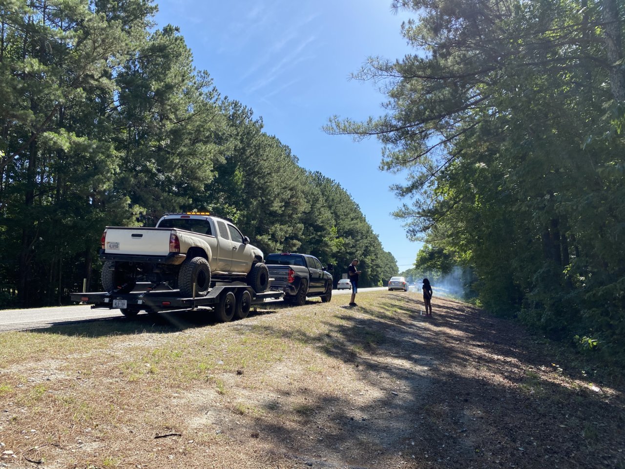

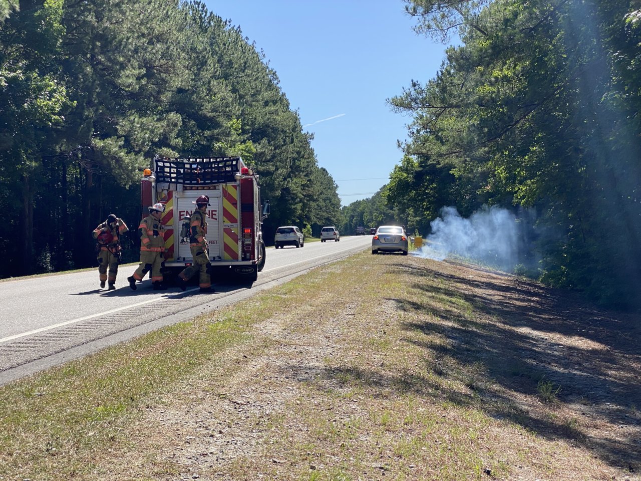

    Pretty wild thing happened today. Car merged in front of me and let out a puff of smoke and then I saw flames under it. Pulled over and helped her out of the car because she was a little hysterical and then called 911.
    She was on the phone with someone and my buddy and I pieced together that the most likely thing that happened was an oil line blew and puked oil onto the exhaust manifold.
    Luckily right after the video cuts off the fire subsided and only the grass next to the car was burning. Fire department showed up 10 min after call, which felt like forever but lucky everything ended up as well as it did.
    https://youtu.be/SeWX2PnOjTM
