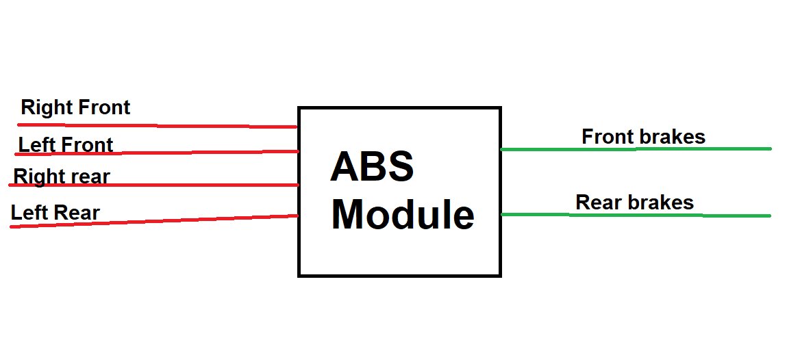

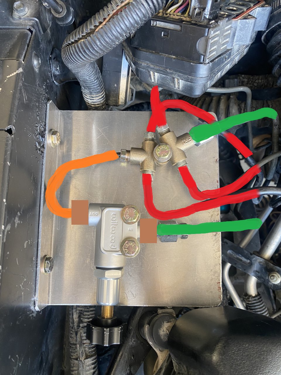

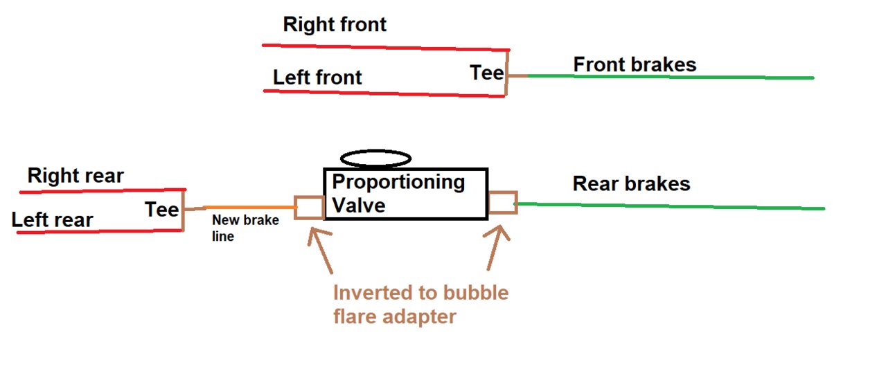

    With the help of @Airdog I'm going to delete my ABS. It's way more simple than I thought. All I'm doing is tee'ing two lines into four, and adding a proportioning valve to the rear brakes.
    note: Different years may have different fittings. Airdogs have two M12 lines coming from the master cylinder. Something to keep in mind.
    Qty 2 https://www.amazon.com/gp/product/B0841ZMKVK?ie=UTF8
    Qty 1 https://www.amazon.com/gp/product/B011B4UX5U?ie=UTF8
    Qty 2 https://www.ebay.com/itm/3342218426...0cIqLwqR0S&var=&widget_ver=artemis&media=COPY
    Qty 1 https://shop.advanceautoparts.com/p...-steel-brake-line-3-16-x-8-paj-308/22190030-P

    Very nice. I like the proximity to Mr. G's things. Great job Daddy.
    Did you bend that yourself?

    This will surely void your warranty?

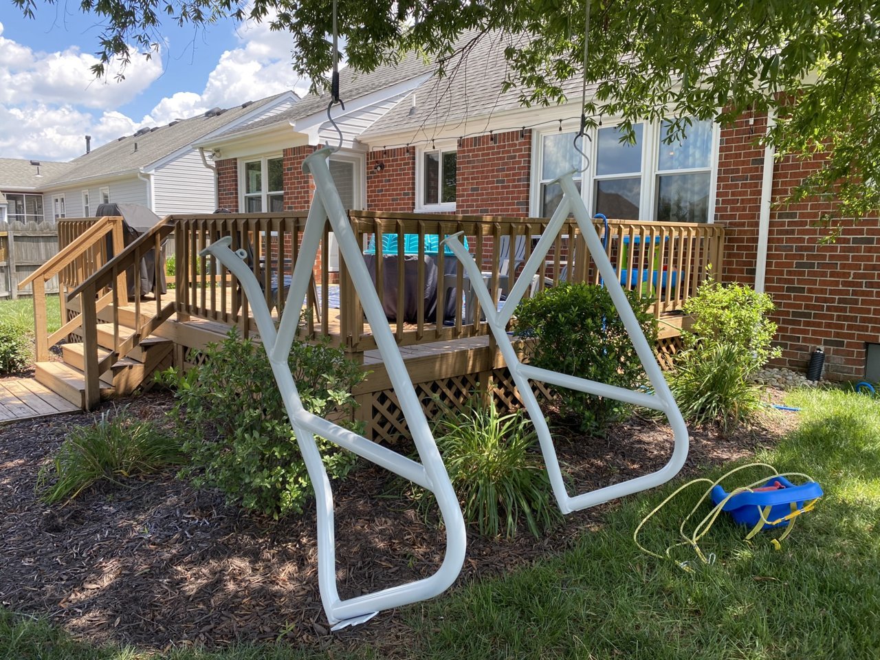

    I am really liking the Goodyear version of them. I use to go with other brands but these are more flexible year round.

    No, they're from 4xinnovations.
    I'll just reference the Magnuson moss act like the sea lawyer I am.

    I'll have to check them out. These would be great as bed side rails.
    At my age I fall out of bed a lot.
    Or maybe it's just the age of the scotch. :drunk:
