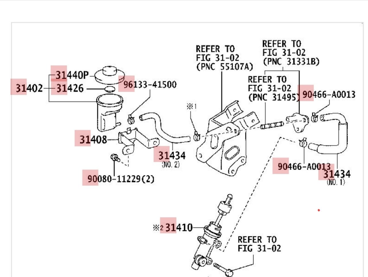

    get the TRD offroad 6 speed reservoir from the 09+ tacos. They have atrac and a separate hydraulic booster so the clutch reservoir is separate.

    SOS Performance, who makes big brake kits, says to use one of these but I haven't taken the time to figure out how to plumb it yet.

    that would probably work just as well, but yes I’m sure some adapters and fittings will be needed to mate it up either way.

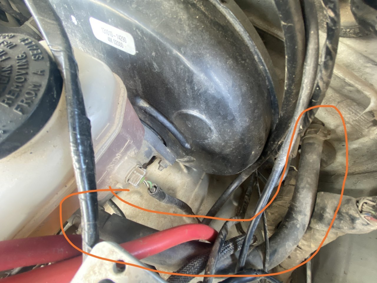

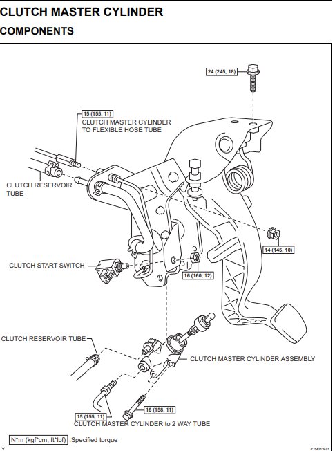

    Edit: I figured it out
    Where does it even feed into? A quick glance at the MC and it wasn't obvious, but I didn't look very hard.

    Oh would ya look at that. Clutch reservoir tube, upper left.

    the nice part about the Toyota one you could probably get it from a pick n pull and the bracket has a mount that will to bolt up to oem holes in the inner engine bay Area by the fender.

    Mine is setup with the separate reservoir if you wanted to do some comparing and measuring for the other reservoir and fittings.
