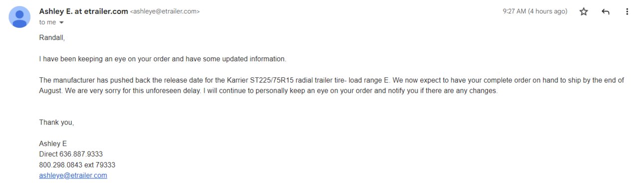

    Also shoutout to etrailer. I've never purchased from them before but I keep getting updates about the backordered tires that I purchased. It's nice to be kept in the loop. I'm also going to poke around and see if I can find someone with these in stock.
