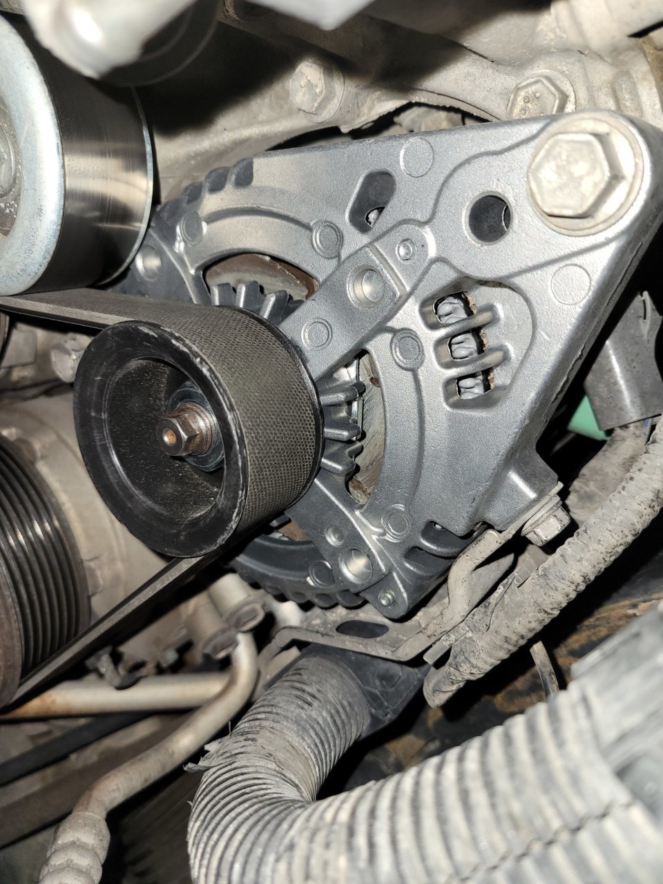

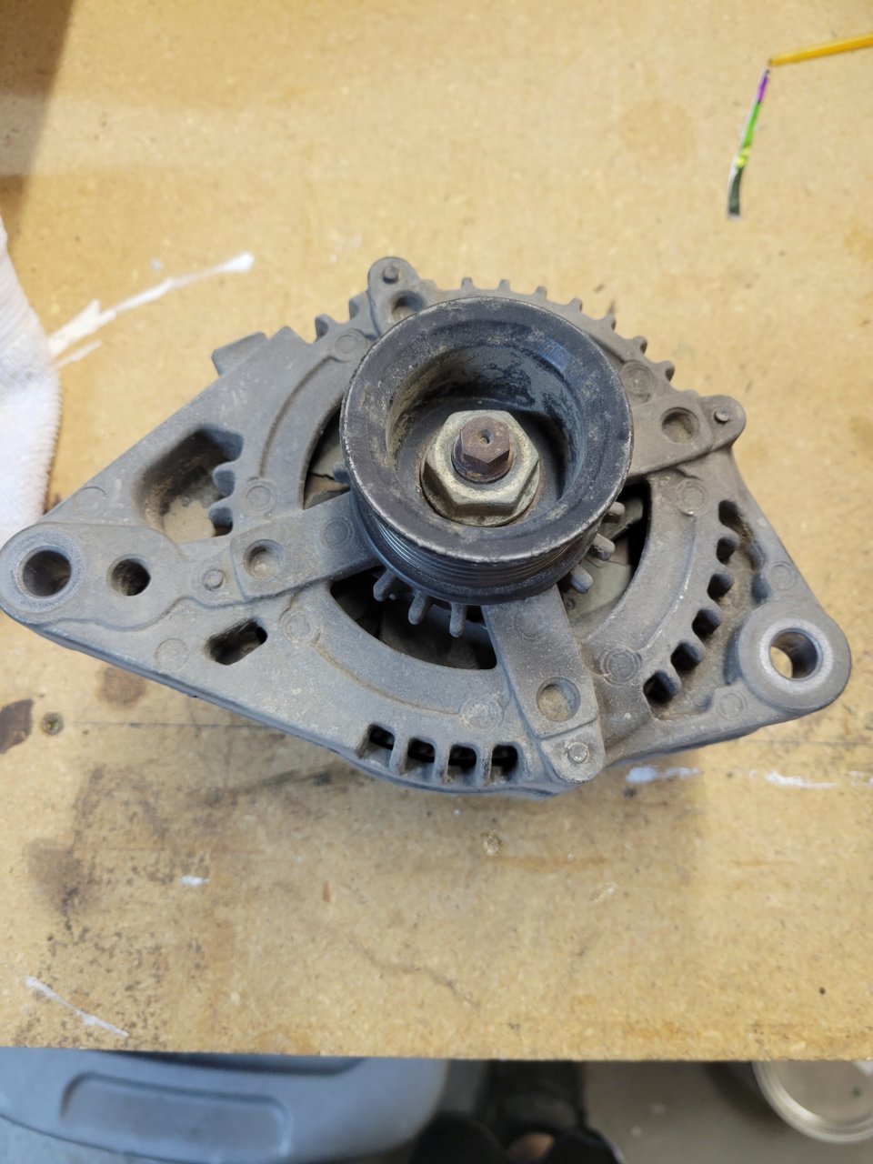

    Out with the old...
    In with the new...
    Wasn't too big of a job. Especially going through the wheel well to get the alternator out and back in.
    Norris is purring like a kitten again.

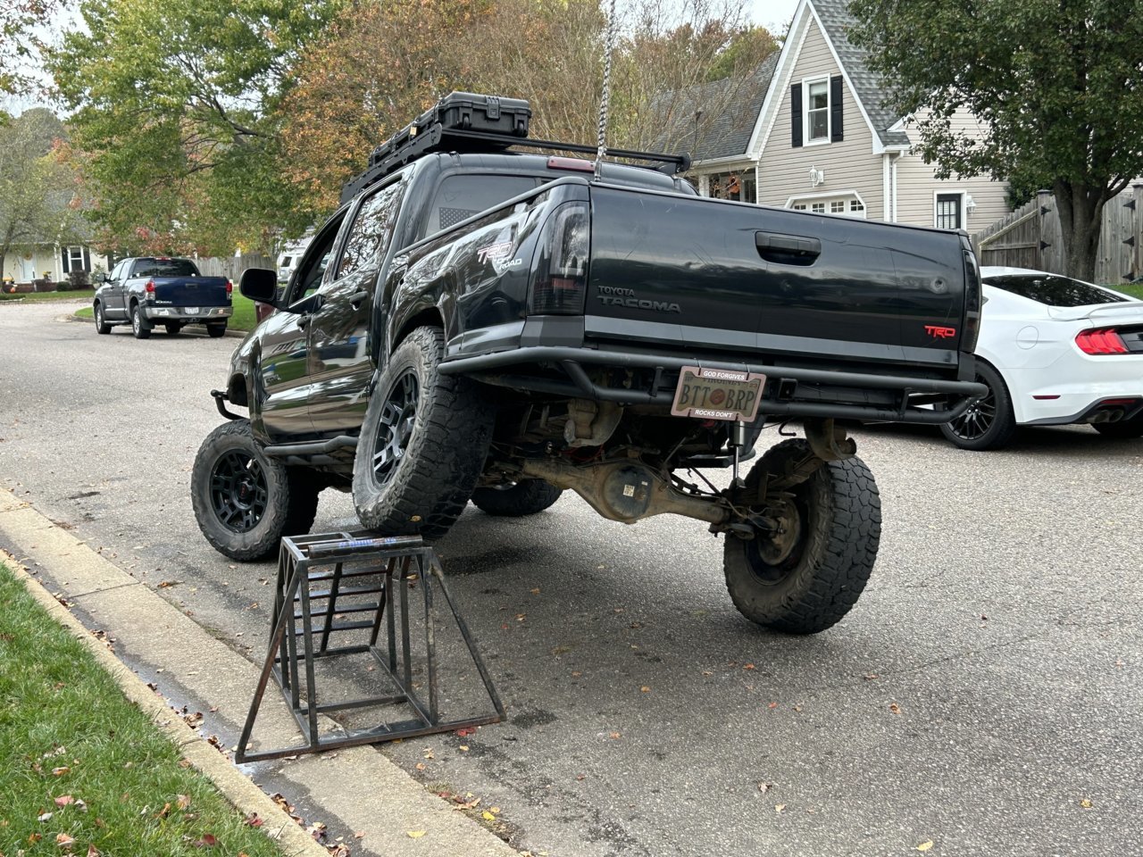

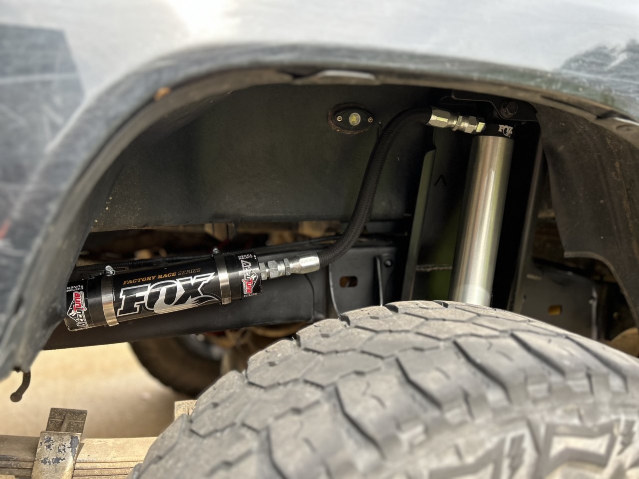

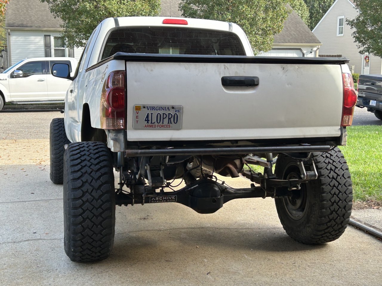

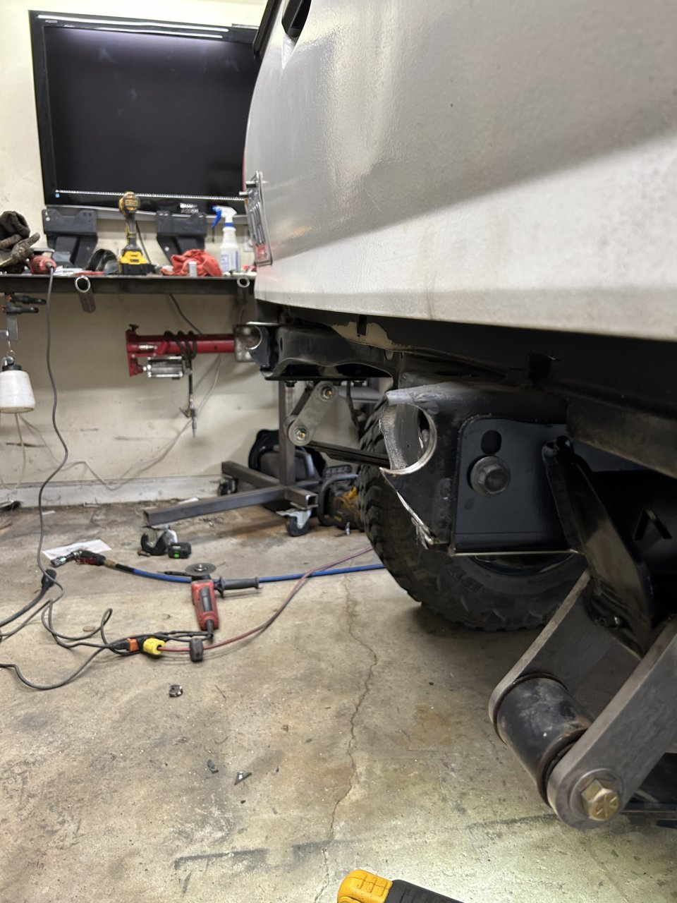

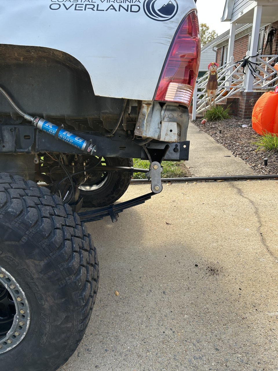

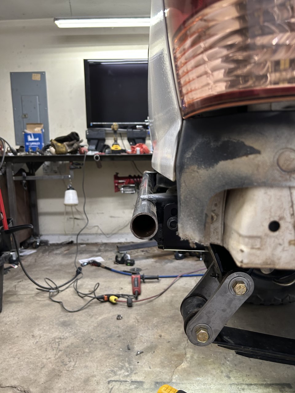

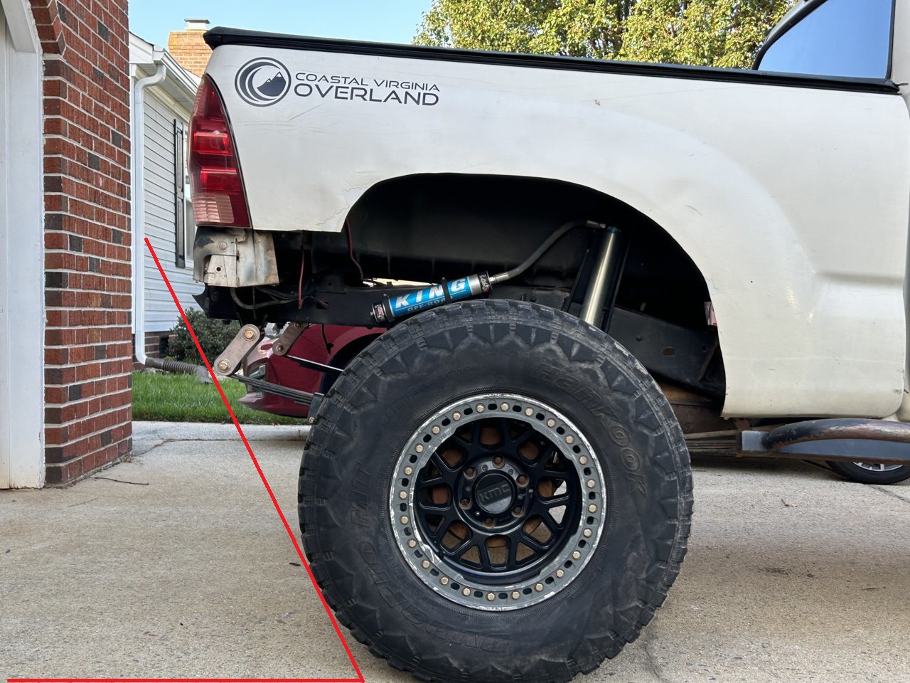

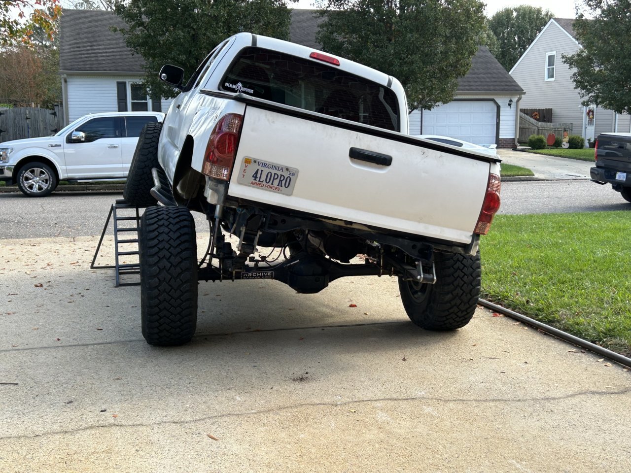

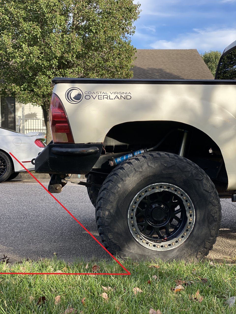

    Shackle flip and bumper are coming along nicely. I moved the shackle flip as far forward as I could to get the desired shackle angle and the ass is still sitting too high for my liking.
    The bumper takes priority and if I have time, I’ll switch my leafs to option 1 which will take away some lift.
    That tube is just a mock-up to show how tight and high it is to the body.

    Seems like with that set up, you don’t gain a ton of clearance and in place of the hammer hangers, your leaf will take the impacts now, maybe I’m wrong. But I suppose it’s pretty easy to clamp a broken spring if that happens on the trail and drive out.

    I do gain a ton of clearance. Crawlers have been doing this for decades so coming down in the leaves must not be of concern. The red lines is roughly where the hammer hangers were.
    And while some lines on some pictures aren’t a prefect representation, I will gain departure angle too. When I measured in the past, the hammer hangers were the limiting factor.
