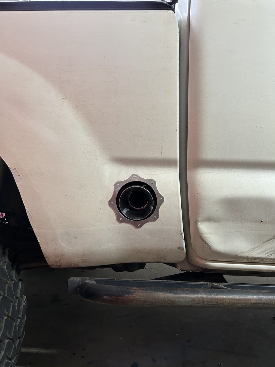

  2. Nov 20, 2022 at 6:28 PM
    EatSleepTacos
    EatSleepTacos [OP] Well-Known Member
    Mar 24, 2015
    #151688
    59,841
    Randy
    West Valley, AZ
    2017 4Runner
    They’re garbage. Were you being serious?

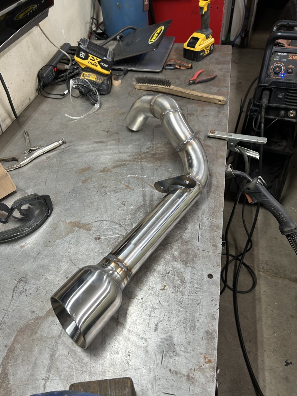

    Actually yes. Exhaust is hard to weld. Yours look decent. Be proud.
  4. Nov 20, 2022 at 6:33 PM
    EatSleepTacos
    Mar 24, 2015
    #151688
    59,841
    Randy
    West Valley, AZ
    2017 4Runner
    Only blew through it twice. :laser:

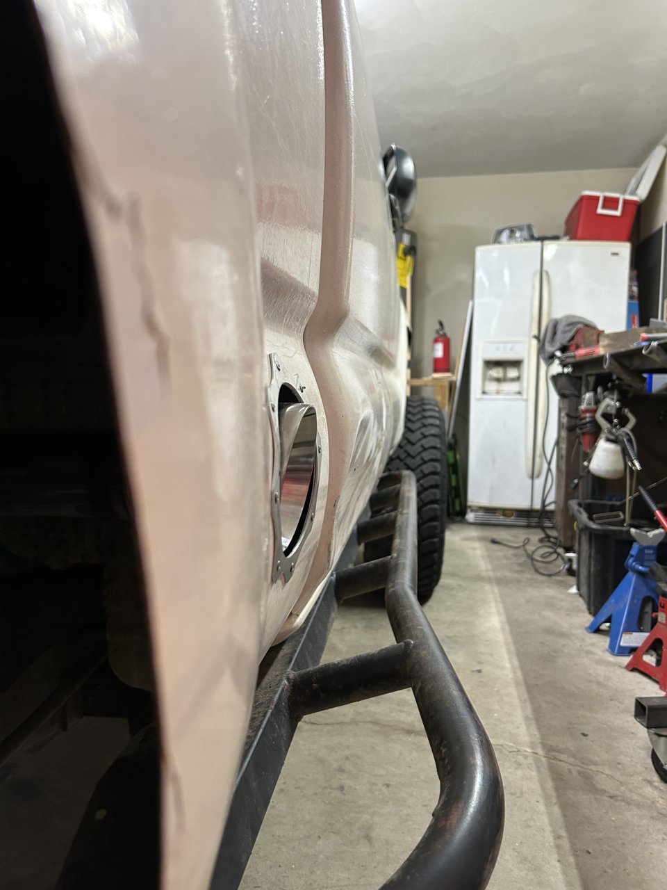

    I'd be interested to see if yours moves like mine does as the exhaust system heats up, especially since your mount is about as far as mine is away from the tip. I also wonder if mine moves as much as it does since the pipe is connected to the muffler with a band clamp and not welded on. If I used a v-band setup and welded it on maybe it wouldn't move? The shit moving around after it heats up definitely threw me for a loop since I spent SO MUCH time trying to center it in the bezel. Now when it heats up it pushes on the left side of the bezel, which I'm good with as long as it doesn't rattle IMO.

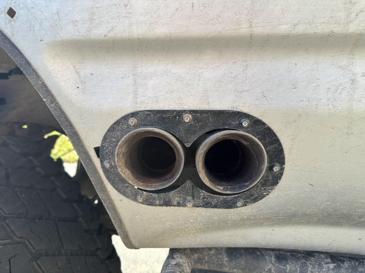

    Scrap what you got and go for the oval cut-out.
