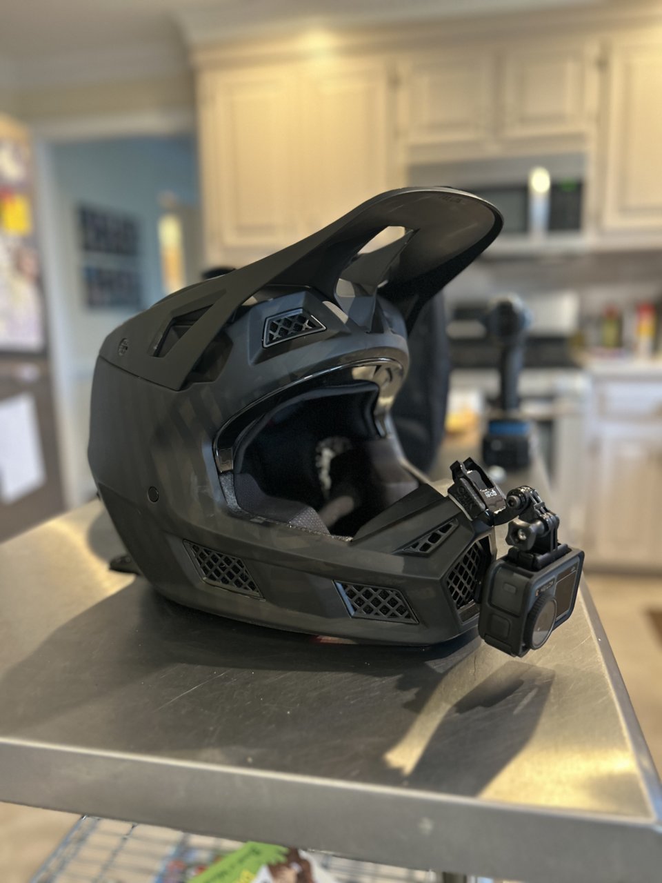

    Just for you <3

    The last thing that will go through your mind in a crash is the camera :anonymous:.

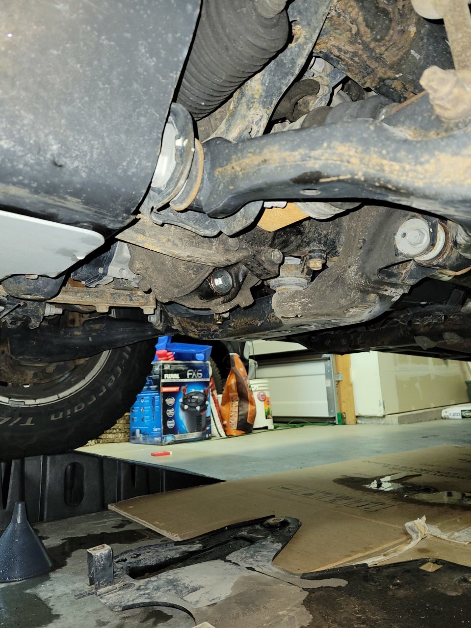

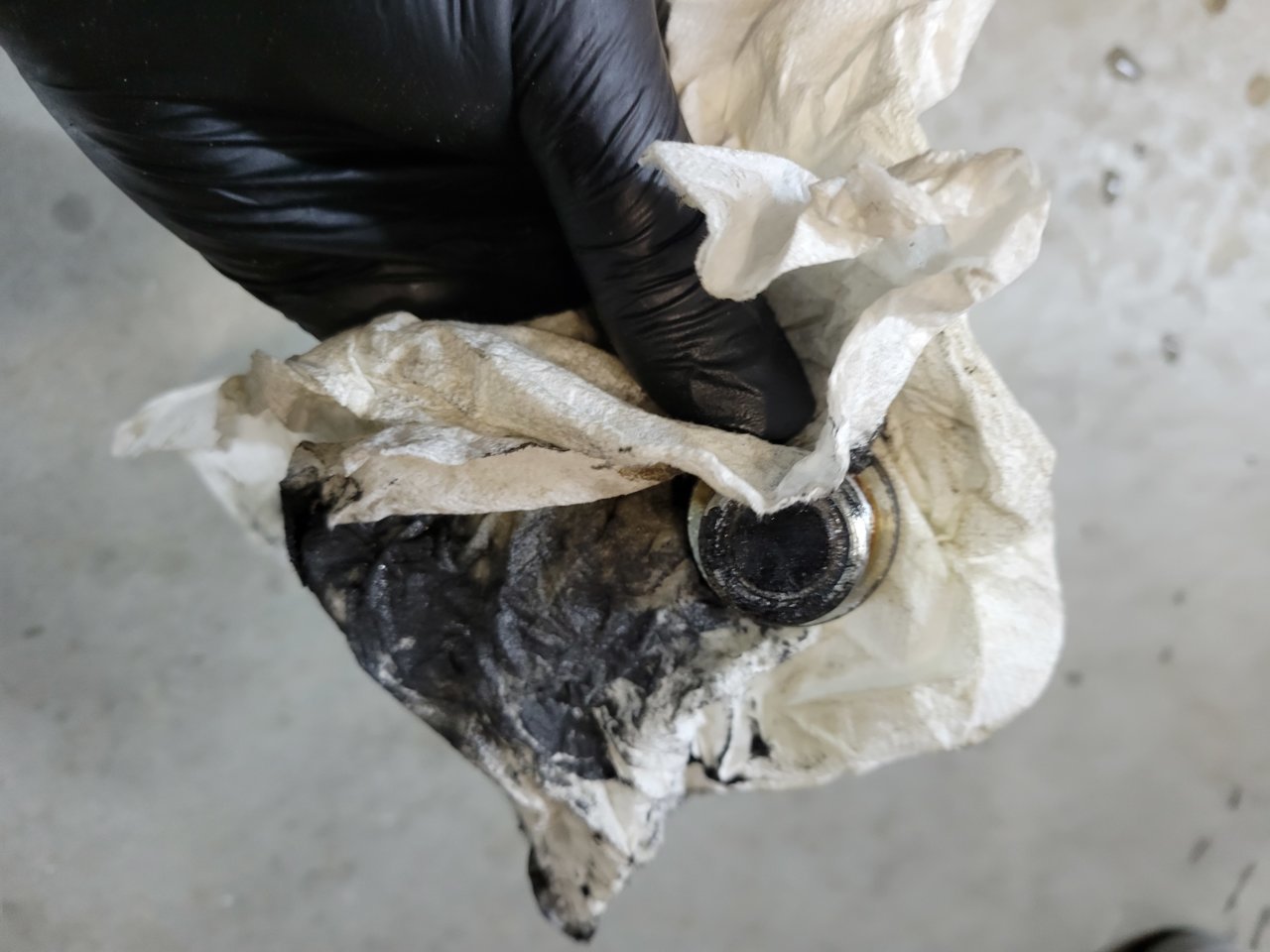

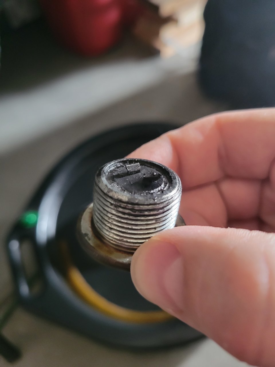

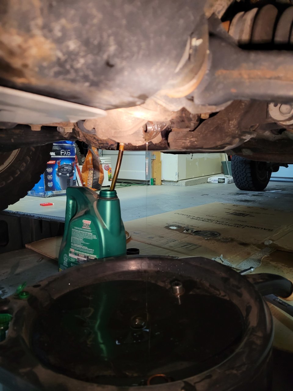

    I spent some much needed wrench time in the garage after work today (dressed warm...I am done waiting for Elsa to thaw this never ending winter!)...I was finally able to get the seized drain plug out of my front diff and change the fluid...confession time...it hasn't been changed in over 120k miles due to the seized plug. Then admittedly, with the truck up on ramps and a decent break bar, it came out embarrassingly easy. The diff has had a bit of fluid replaced when I did the ECGS bushing, but that was years ago! Replaced it with the Lexus plug that has a 13mm bolt on it instead if the 10mm hex. When i did the bushing, part of the race of the bearing were missing. Luckily they were firmly attached to the magnet on the drain plug!
    Also changed the oil w/mobil 1 high mileage (currently on coupon on costco, 34 bucks for 6 qts.) Next project is the rear drum brakes.
