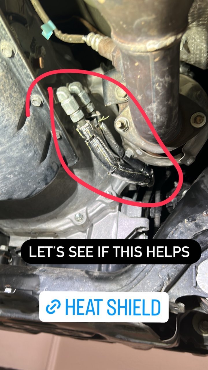

    Not a build continues. A benefit of being on Tacomaworld all the time and reading random threads is I gain knowledge that may come in handy one day. Enter this thread.
    https://www.tacomaworld.com/threads/how-to-lower-your-trans-temps.736156/
    Since the 4Runner has essentially the same powertrain, it has the same hard lines coming off of the transmission. Insulated them this evening, I’m curious to see if it helps keep trans temps cooler.

    that close the the cats, yea it will help. Surprised the factory doesn't have a least one them lil aluminum tin covers to help

    Agreed. On the tundra, the soft lines that are right there are heavily insulated. Figured it certainly won’t hurt anything for $10.

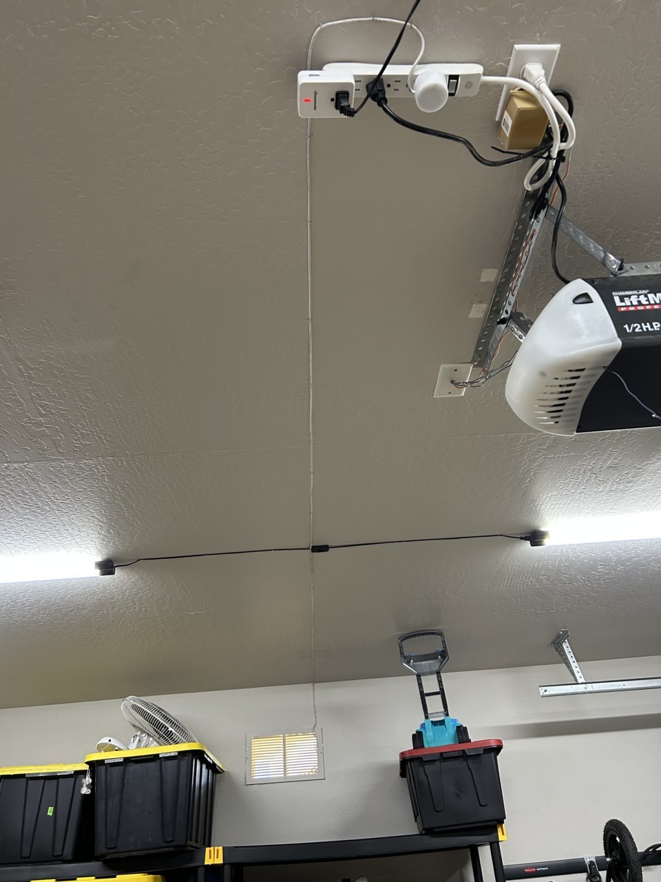

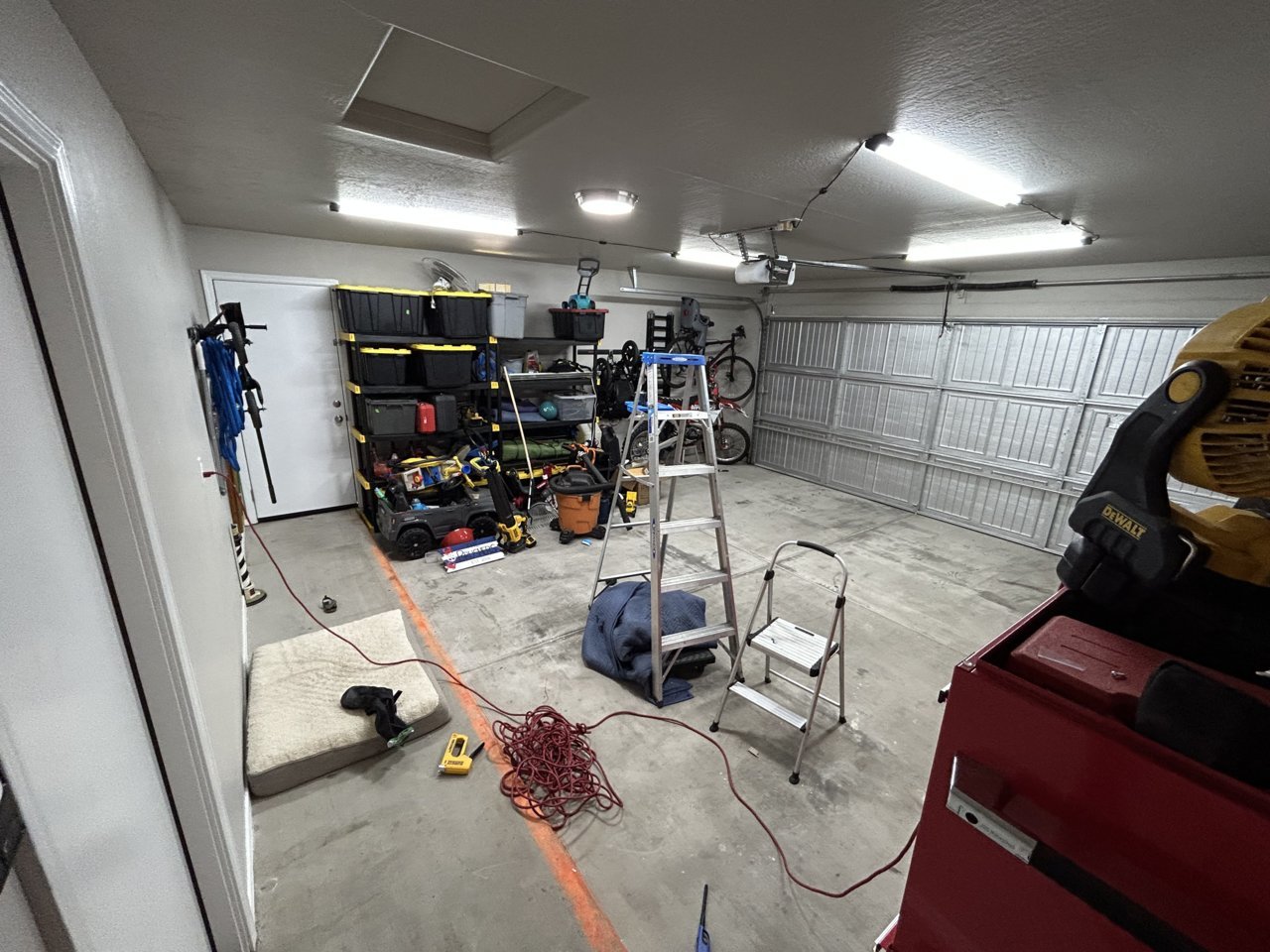

    Are those shop lights anything fancy in particular? I need some for my garage, so trying to gather some intel of what is worth spending on. I'm tempted to go for some Amazon cheapies. $60 for 10 lights with a decent amount of legitimate reviews including w/ real pictures seems like what I'm leaning towards

    They’re just Amazon cheapies. They feel cheap and fragile but it doesn’t really matter once mounted. My chief complaint is that they interfere with my garage door remotes in the worst way. If the lights are on, I can’t use the remote in the car to open and close the garage. I have them on a separate light switch and as a secondary light for this reason alone. For the price though, I’m not complaining.
    Edit: I’m not sure what color my lights are but I would go with 5000K over 6000K personally. The 5000K will look a lot more natural.

    Interesting about the garage door, I wonder if there's a way to change the frequency of the door remote? I gotta wait a bit before I start spending a lot, but I'll let you know what I decide on and if have issues with mine.
    Yeah I saw in reviews they were fragile feeling but like you said, when they get mounted to the ceiling that becomes a non issue
    Good tip on the color temp, I have no intuition about that lol.

    I’m not sure, but I don’t think so. It’s a minor hassle but not the end of the world. I put them on these switch and it works really well.
    DEWENWILS Remote Control Outlet... https://www.amazon.com/dp/B07HRD1GXP?ref=ppx_pop_mob_ap_share
    At my last house I used one of those “lightbulb to socket” adapters and it worked fine, but it wasn’t going to work at this place. I mounted a power strip on the ceiling off of the garage door outlet and used the above switch.

    Well no wonder your door opener doesn't work when the lights are on!
