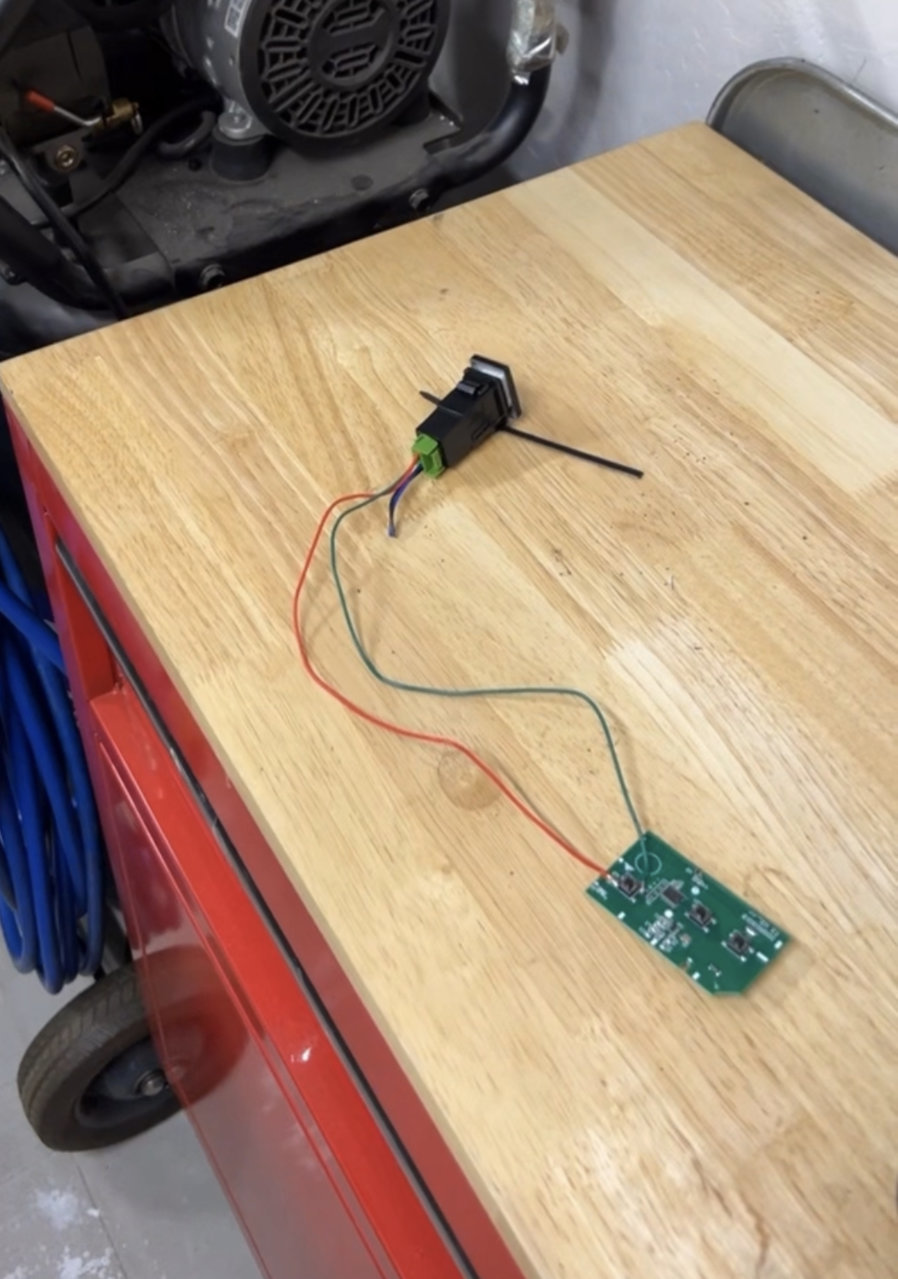

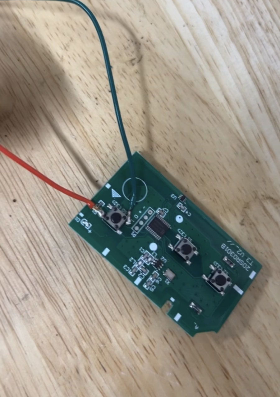

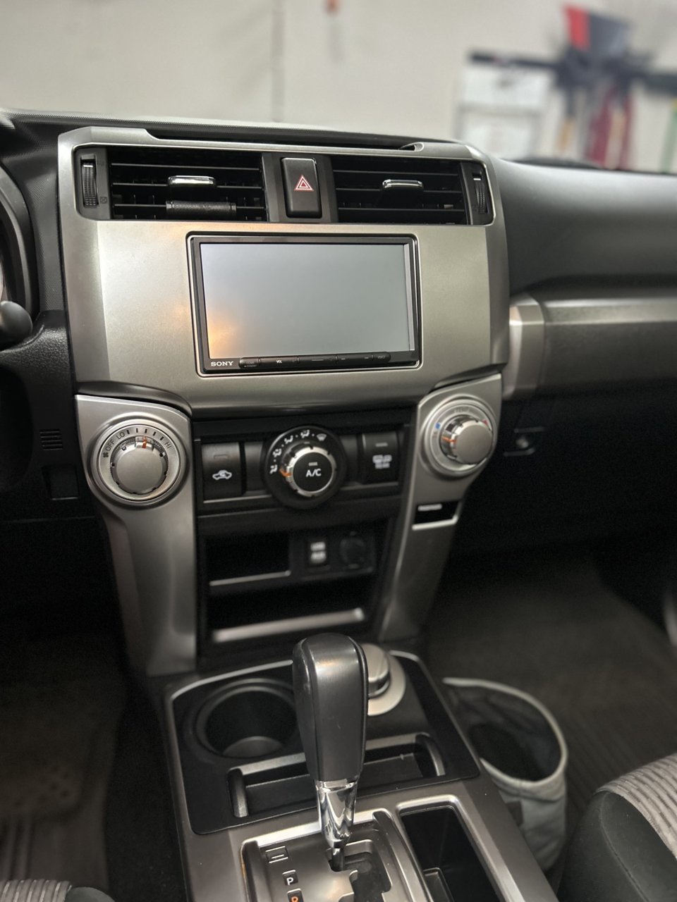

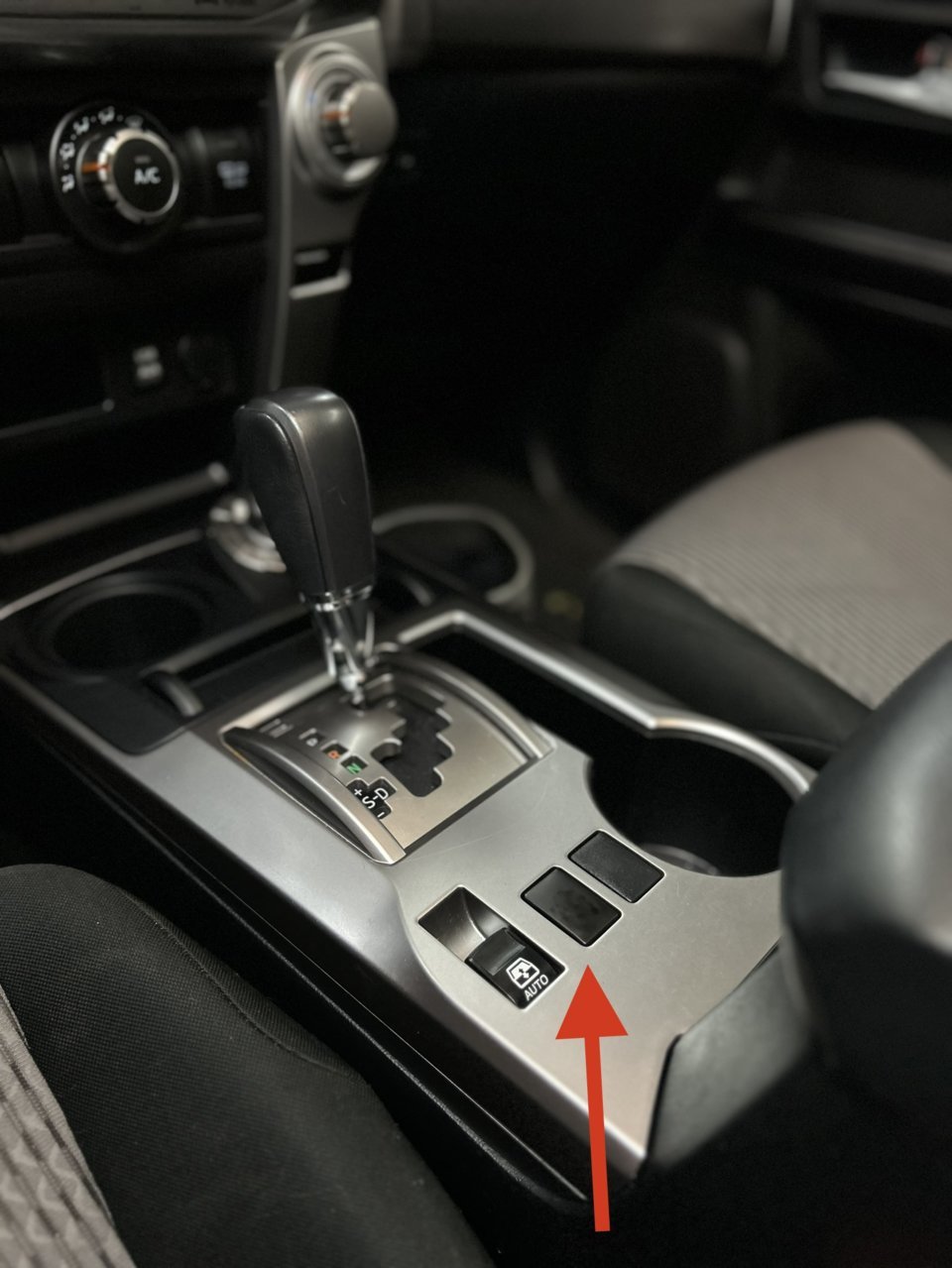

    No homelink in this poor spec SR5 and I dislike garage door openers on window visors, so I repeated what I did in Betty white. I took a momentary switch meant for the truck and wired it into the garage door opener and shoved it behind the dash. All that’s needed is to solder two wires onto the remote, so you’re completing the circuit with your new button versus the button on the opener itself.
    Excuse the potato pics, they’re screenshots of my IG story.
    I then put it back into the garage door remote case, wrapped it in tape and shoved it behind the center console.
