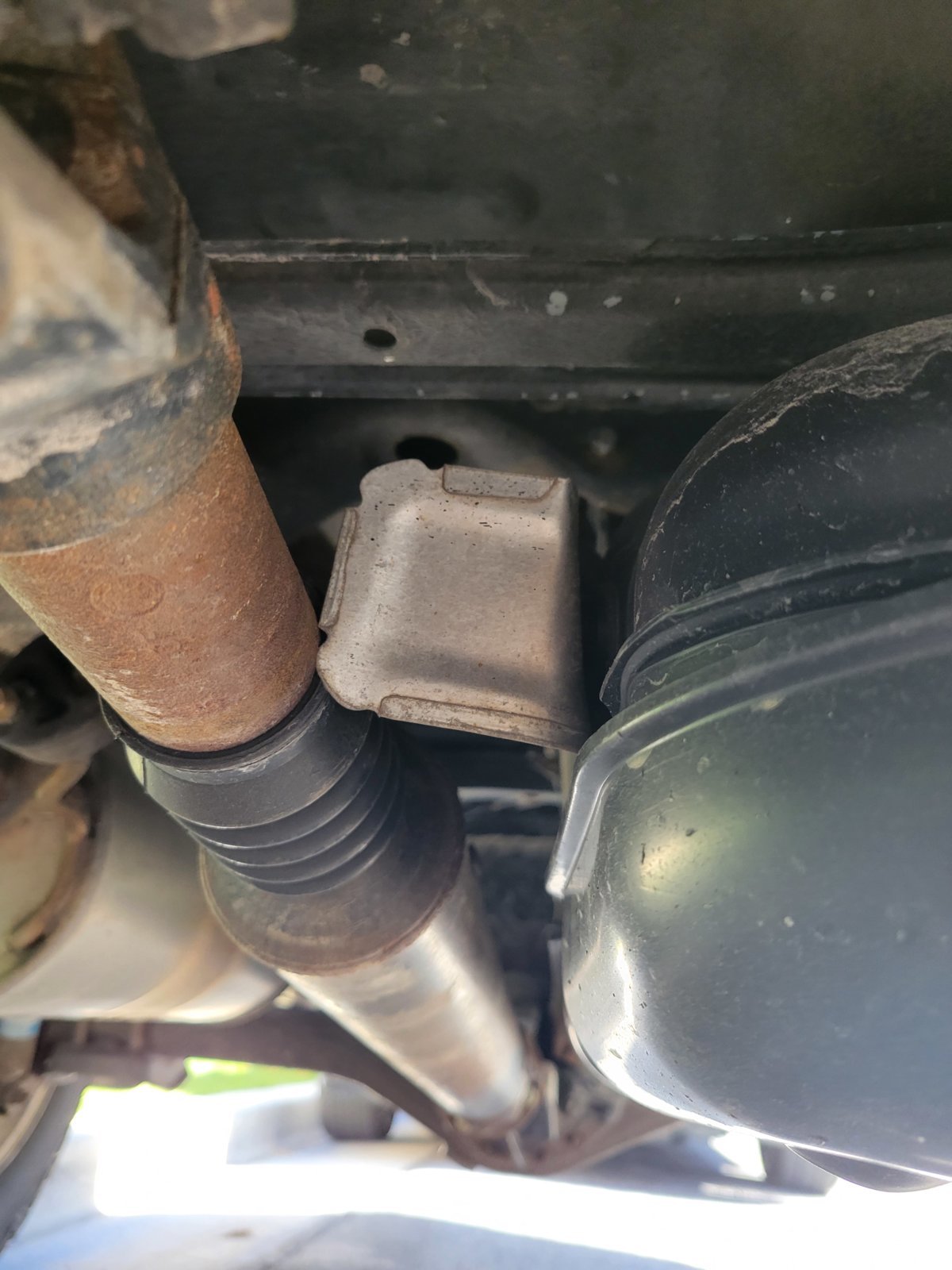

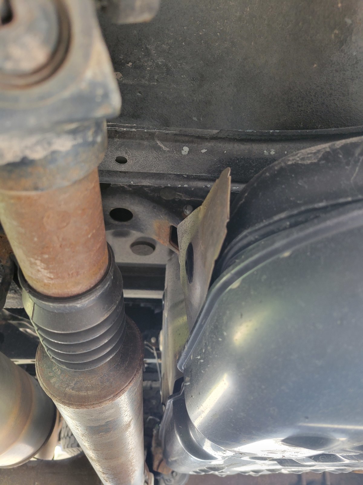

    Norris started making a weird grinding/rotational metal on metal noise this last week. I could easily replicate it any time I downshifted and put more torque on the driveshaft and could clearly hear it was coming from mid truck, not transmission/transfer case or engine area. Crawled under it today expecting to find my carrier bearing grenaded. But, found this instead...
    I love simple fixes!
