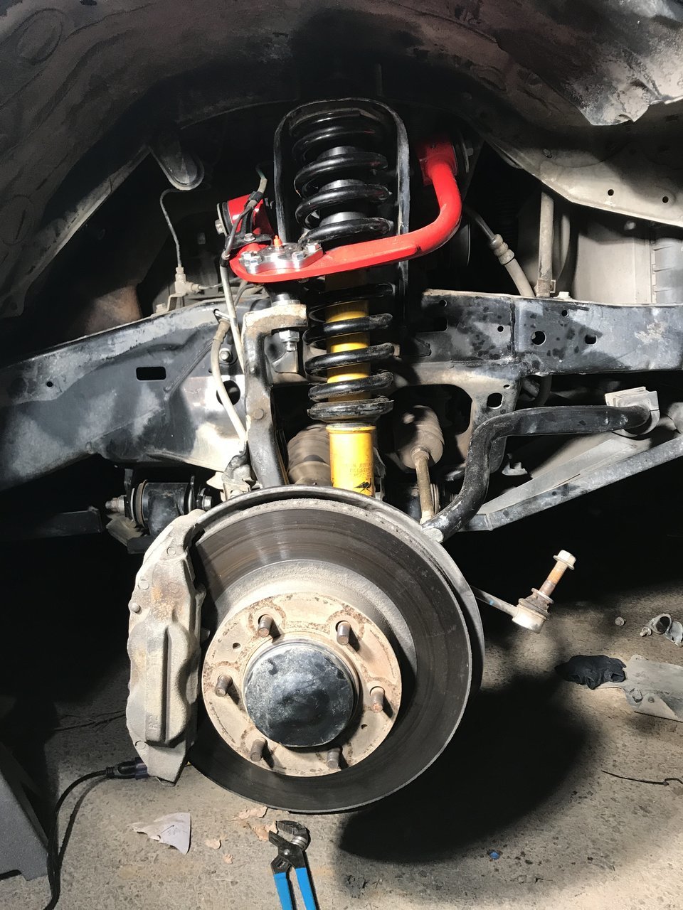

    Which UCAs are those?

    What he said! Install was ok. My plan was to cut out the bolts and reinstall backwards to avoid bending sheet metal. On the drivers side, there were some hard brake/fuel lines in the way, so after 15 minutes of struggling and cursing, I gave in and bent the metal and the bolt came right out.
    On the passenger side, there were no lines in the way so a backwards install was a breeze.

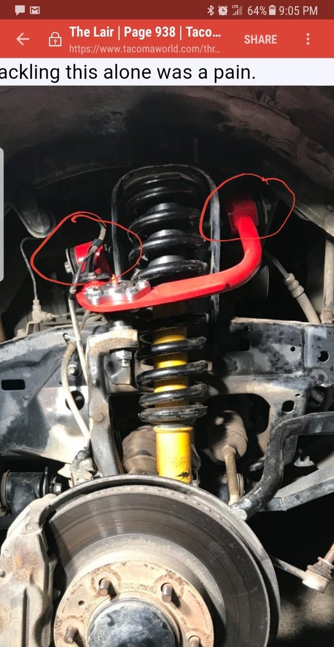

    Pics? What do you mean backwards install?

    UCA upper bolts.
    The fender sheet metal is so darn close to the long ass UCA bolt that it gets in the way of pulling it out.
    Take quick peek at your truck and you’ll understand.
    Installing the bolts the other direction would make for an easier install and de-install in the future.

    These?

    Yup. Look at where the fender sheet metal is in relation to the uca bolt.
    The bolt enters from the higher side (front side) and exits on the lower (rear side.)
    In order to pull out the bolt, you would have to bend the fender sheet metal on the front side. Or cut the bolt head off and pull the bolt from the lower side.

    What Lloyd said. The sheet metal is in the way of backing the bolt out. I cut the head off, and slid it out backwards. On the drivers side, reinstalling backwards was impossible so I bent the sheet metal a little and put in the correct way.
    On the passenger side, those brake lines weren't there so I put it in backwards and didn't bend any metal.
    That's one loooonnng bolt.
