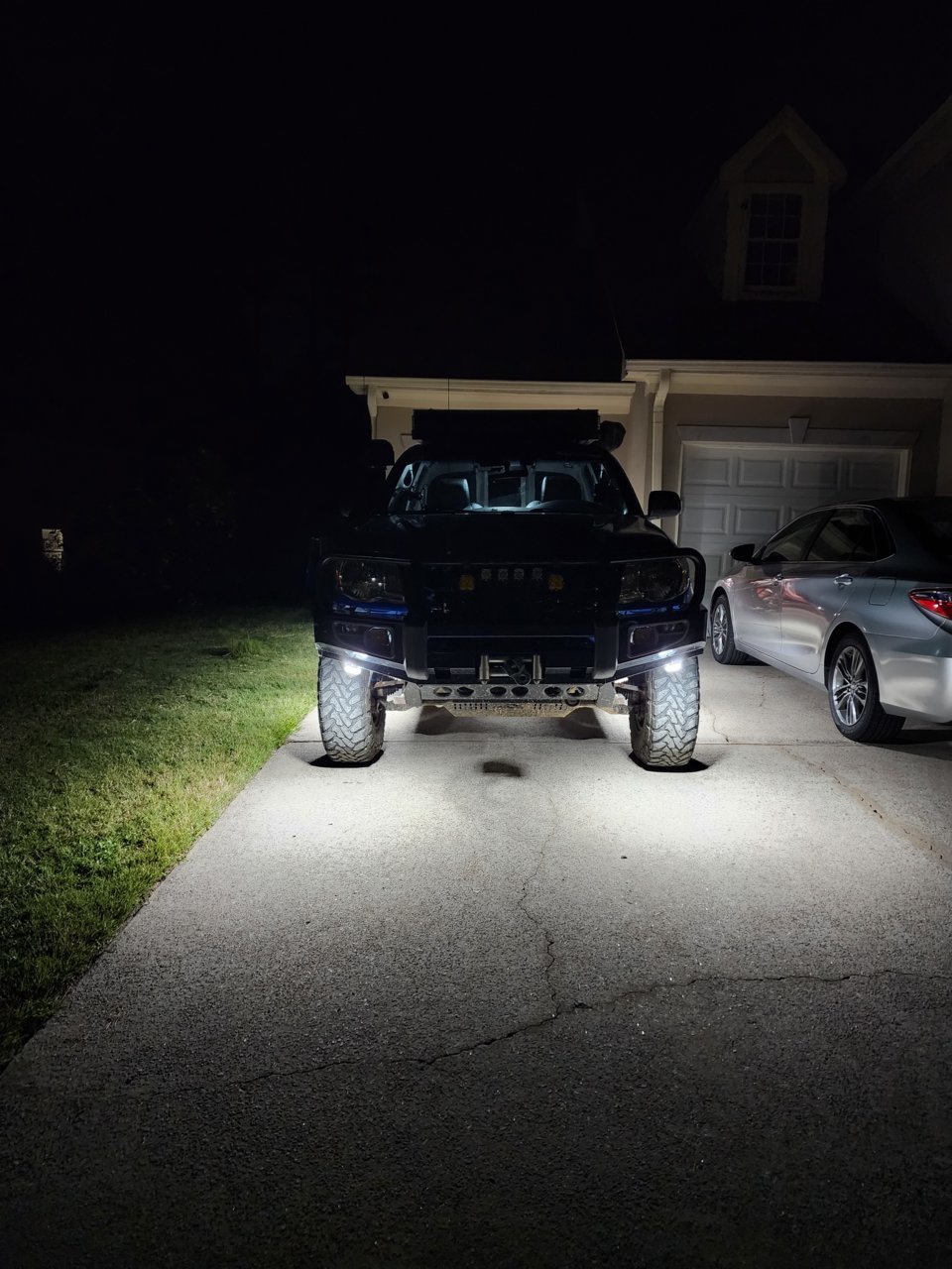

    Ditch Lights, LED Bumper Bar
    those must be great on a dark night!

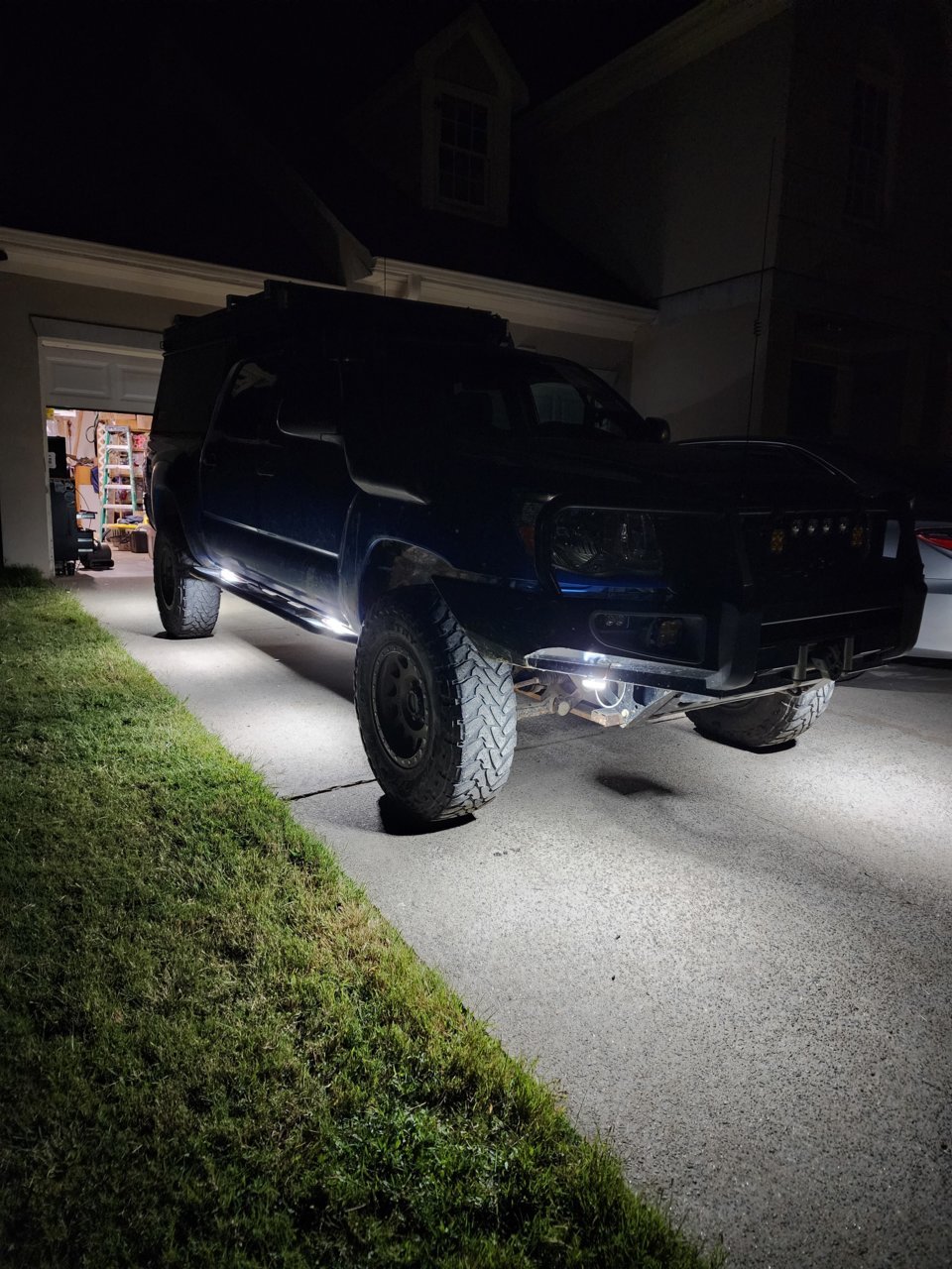

    **** 2021 Mods **** Sokietech No Drill Hood Struts (Replaced) Color Matched Mirror Caps Color Match Door Handles SUPAREE LED Side Mirror Turn Signal Lights AVS Dark Smoked Hood Bugflector (Removed) Meso Black Interior Door Handles AVS Window Vents AUTOGINE Super Bright 6000K White LED Vanity Mirror Lights 3D Rear Tacoma Letters Matte Black OEM Blacked Out Emblems OEM Black Trim around Fog Lights Full BedRug AMP Research Bed Extender LoMax Tonneau Cover (Replaced) RBP 77-Spike Wheels 18X9 (Replaced) Nitto Terra Grappler G2 tires 285/60 (Replaced) Blacked out Toyota emblem on steering wheel Night Shade Front Grill (Replaced) Dark Tint Front TSS Emblem (Replaced MBRP Dual Exhaust KTJO Door Pod lighting Window Tint, 5% in the back 30% up front MESO Chrome Delete center console MESO Chrome Delete Vent Rings **** 2022 Mods **** Cali Raised Steel Front Skid Plate (Replaced) Ice Blue Map and Dome LED bulbs Rek-Gen XL Mud Flaps - Black on Black All interior trim painted Matte Black with Flat Clear Coat Aqua Blue Foot Lights - Front and Rear MESO Switch Panel Custom Layout MESO 3 Switch Overhead console panel MESO Chrome Delete Climate Control Rings UpTop Bravo Roof Rack Extreme LED 38 inch LED Light Bar in Roof Rack Diode Dynamics LED Strip Grill Lights Meso Ultimate Tail Lights (Replaced) Rock Lights - 8 Cyclone V2's (Replaced) UpTop Roof Rack Grab Handles UpTop Scene Pods with Baja Design Rock Lights Diode Dynamics Elite Series Fog Lights CaliRaised Stealth Bumper 30 inch Infinite Offroad LED Light Bar X2 Zeak 10,000 Winch KTJO Driver's Side Grab Handle LambTek Winch Switch Boomers "faux" TRD Pro Shift Knob Tacoma Lifestyle Smoke Third Brake Light Blacked out Instrument Panel Lens Diff Drop Dobinson's Suspension, Front Coil Overs, UCA's, Rear Shocks and Leaf Packs DB Customz Grill, Color Match with RGBW LED Letter Lighting **** 2023 Mods **** PowerTrays Tray with Busemann Fuse Relay Pioneer DMH-WC6600NEX Maestro RR2 SiriusXM SXV300 Tuner BoxWare Anti Glare HU Screen Protector Varity of cables and adapters Focal ACX 690 Front Speakers (Replaced) Focal ACX 165 Rear Speakers (Replaced) Diode Dynamics Stage Series Rock Lights - 3 in each wheel well Diode Dynamics Flush Mount Brackets Revolver X4s Tonneau Cover UpTop Roof Rack Grab Handles V2 Raceline Compass 17X9 wheels Toyo Tires Open Country A/T III 275/70R17 Tacoma Beast Infinity Tail Lights Taco Clout Wide Angle Convex Mirrors - Heated + Turn Signals + BSM KTJO Powered Folding Mirrors **** 2024 Mods **** Lighting Trendz Glow LED lights in Grill Lettering Cali Raised Cat Shields The Sub Box Shop Sub Amp box Rockford Fosgate 10 inch 4 ohm Dual VC Sub Kicker 3.5 inch speakers in dash (Replaced) Auto Harness House harness adapters for speaker wires Alpine PXE-C80-88 8 Channel Amp. Polk Audio DB 6502 Front Doors Polk Audio DB 6502 Tweeters in Dash Polk Audio DB 652 Rear Doors Hidden LED's in Bed Charvonia Design Bed Rail Tie Down Anchors Charvonia Design Bed Tie Down Anchors Charvonia Design Bed Floor Tie Down Anchors Charvonia Design Billet Battery Tie Down Redline Hood Struts TRD Pro Hood KITT Scanner LED in Hood Scoop Cali Raised Aluminum Skid Plate
    20220424_002227740_iOS.jpg 8 Cyclone V2's. One in each wheel well and one under each door.

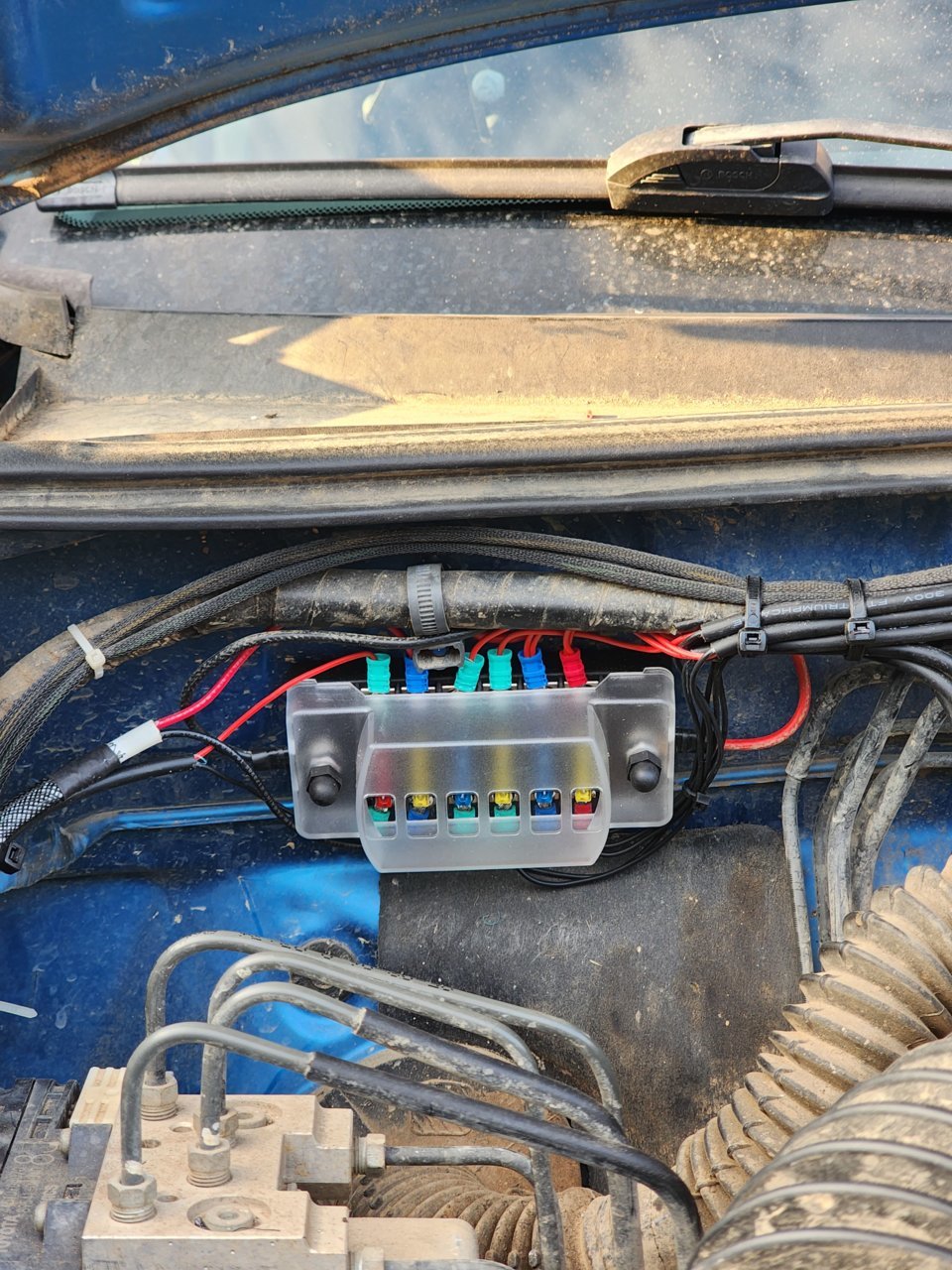

    I know it's been a while since this picture was posted, but did anybody else but me notice something possibly wrong with the wiring of this fuse block? Fuses are normally run "in line" on the positive side and that's not what I'm seeing here if I'm seeing the positive (red) and negative (black) wires correctly.
  17. Dec 20, 2022 at 12:54 PM
    #197
    paranoid56
    paranoid56 Well-Known Member
    Jul 25, 2012
    #83443
    3,447
    San Diego
    14 double cab taco
    normally yes, but that panel is a odd one. one side is neg and the other is positive.

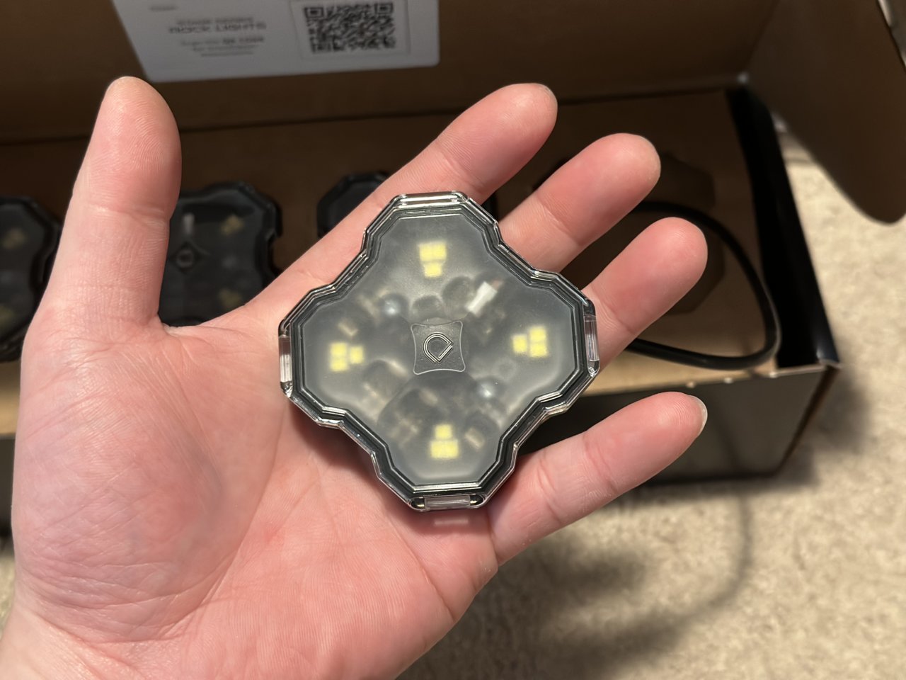

    They are finally here
