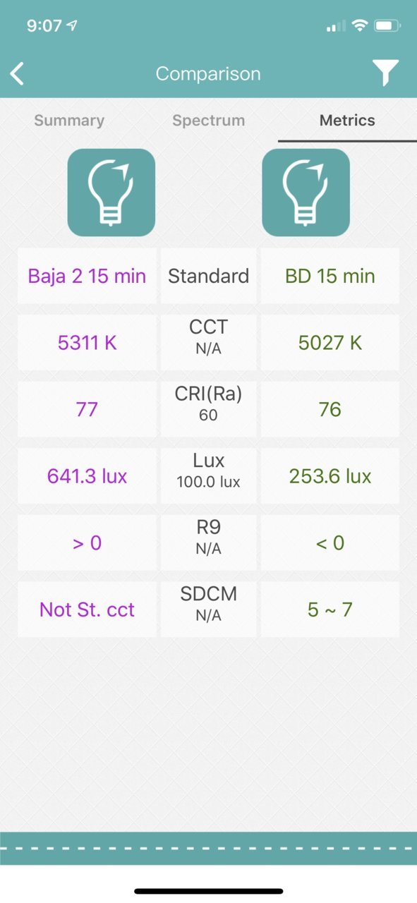

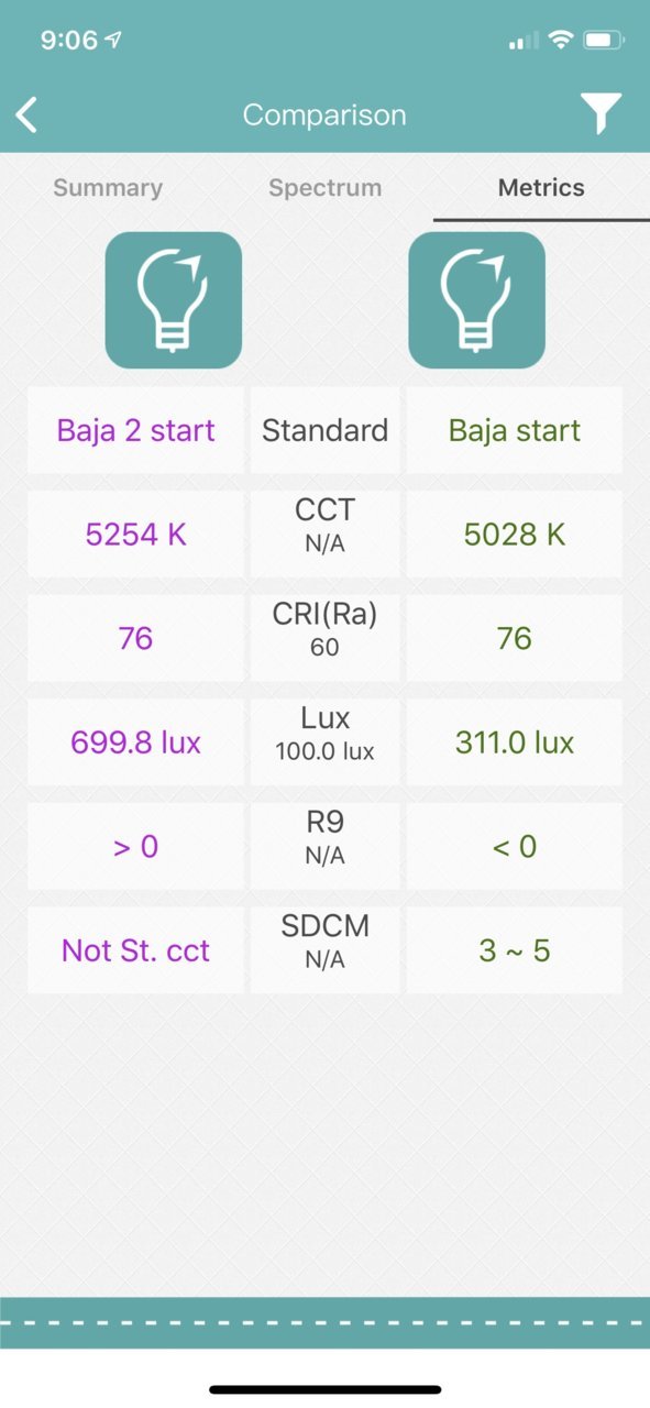

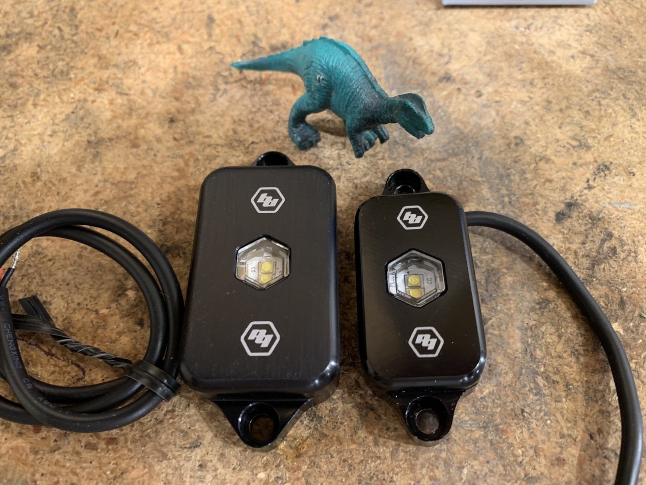

    Update on the Baja Designs rock lights!
    Turns out the rock light I received was somehow 2 generations old, and not the current model or a fair comparison. Thank you @memario1214 for noticing that and sending me the current model for re-testing. The results are substantially better. The new model is also a bit larger.
    New left, old right
    "Baja 2" is the new model in the charts below. As you can see Baja Designs improved the output by roughly an impressive 2.5x over the model I tested previously.
    I'll go back an update the charts and rewire the testing rack to recreate the output shots with the correct Baja Designs light soon. This still doesn't put BD output above Rigid, Morimoto or VLEDs, but certainly gets it a whole lot closer.

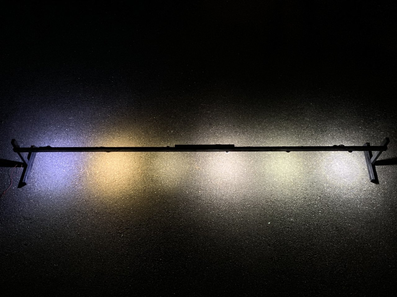

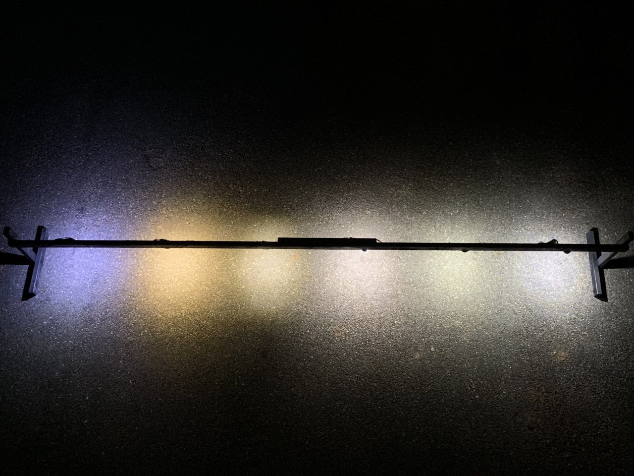

    Output shots and all data/charts updated for the latest Baja Designs rock light model. Baja is 3rd from the left.
    Before:
    After:
  20. Jun 14, 2019 at 5:12 PM
