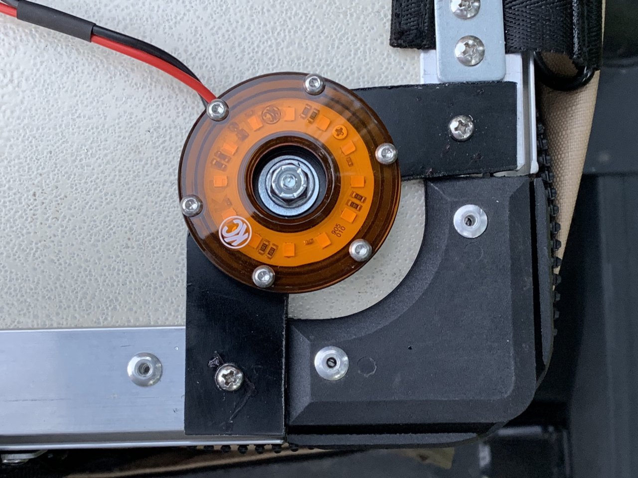

    I went with the KC amber lens Cyclones for my project.

    Wow, that looks good! Did you end up using those magnets to mount the KC lights?

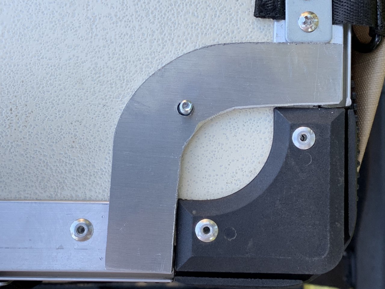

    RTTs are aluminum framed, so magnets are a no go. I made some brackets.

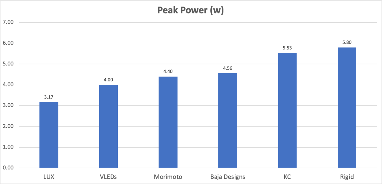

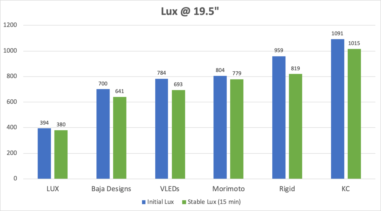

    If you go that route for size and mounting simplicity, I would go with the Max over the Monster. But the other lights in this thread are quiet a bit better in output.
