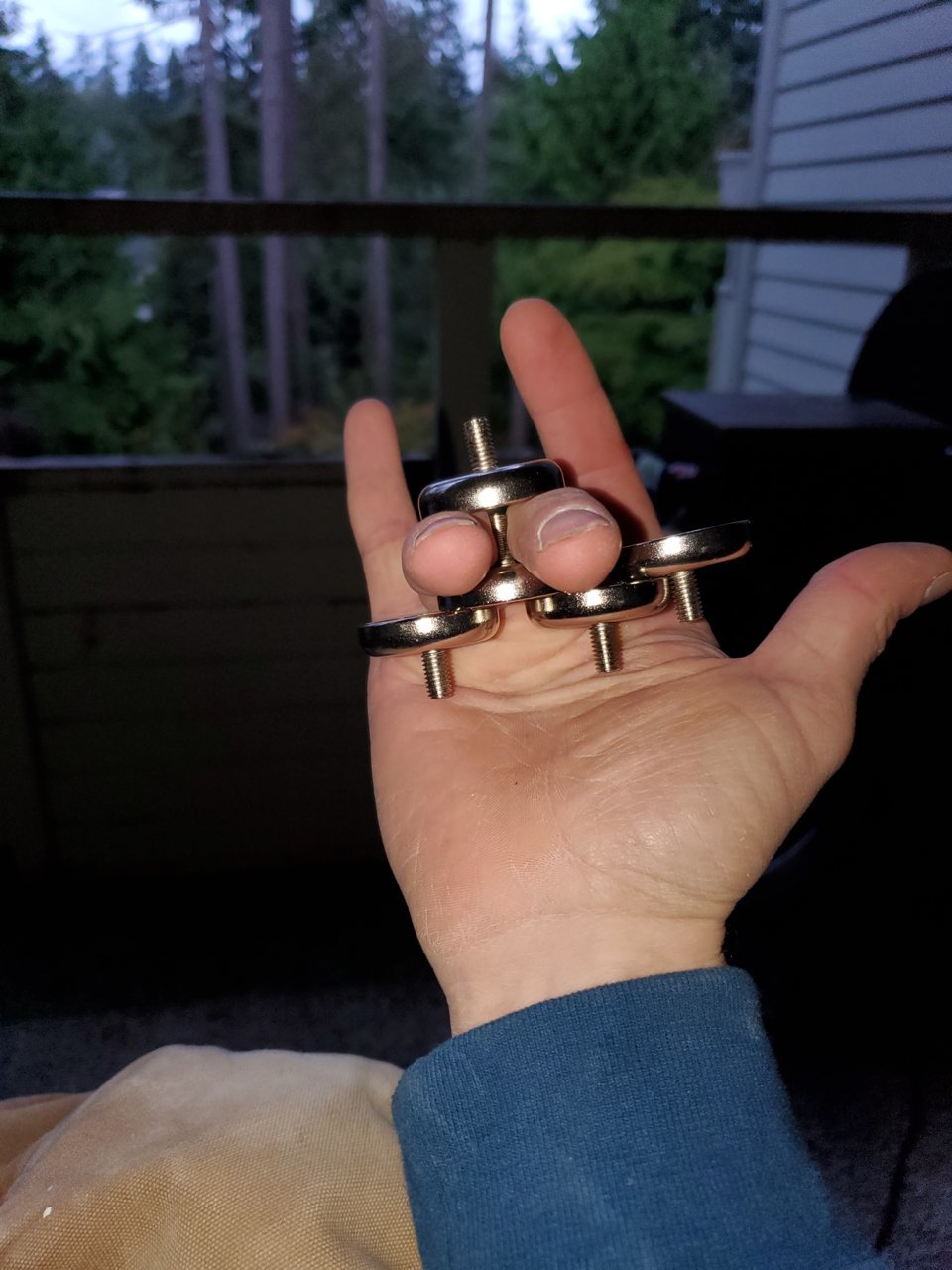

    20190917_190024.jpg 20190917_183939.jpg im about to install my kc underbody lighting. possibly with @crashnburn80 as we live local. im not sure if he posted about magnet mounting. these he suggested are beyond ridiculous strength. like, never, ever fall off factor. stay tuned for final install.

    Definitely wanna see the install on this. I'm getting ready to install the KCs soon and mounting is still up in the air for me

    man, id go magnets. no cutting plastic, no holes to rust, mobile, relocateable....

    I used magnets for mine as well... worked out very well so far.

    these are rated at 75lbs each. insane hold.

    They were linked in the original post but looks like the link no longer works, I’ll have to update it. I specified those as a semi-permanent no-drill mounting option. Way overkill of course.

    So I found some magnet options on Amazon with the bolt and nut design. But $19 for 2!?! Holy crap. Anyone see any strong, but cheaper options?

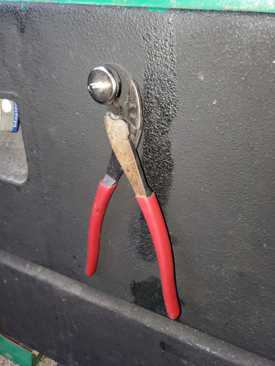

    I used some from home depot. Magnet source #07047

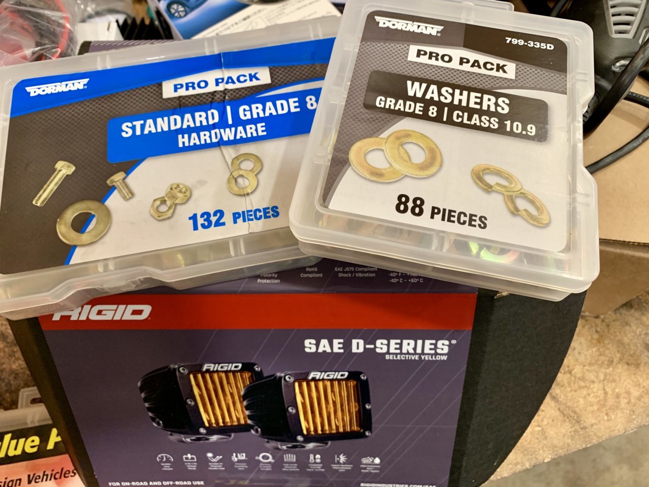

    You can try to find one that includes nuts. The link I provided says 1/4-20 thread, you can find a fitting nut at your local hardware store. I typically keep metric and standard hardware packs which contain a variety of common nut/bolt sizes, which you can purchase from an auto parts store, and it almost always has what I need so I don’t need to go searching. I highly recommend keeping them on hand.

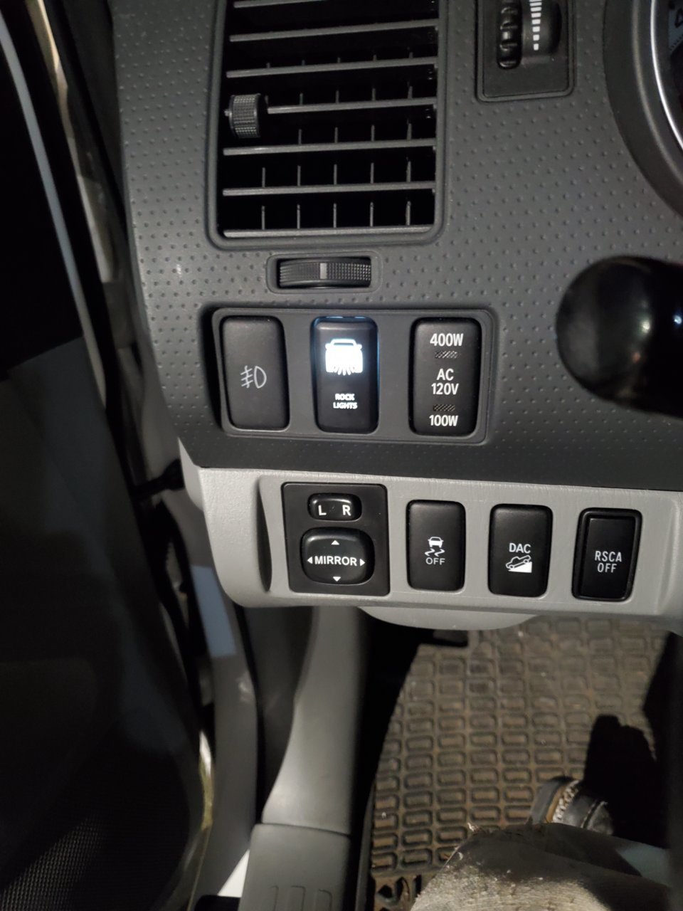

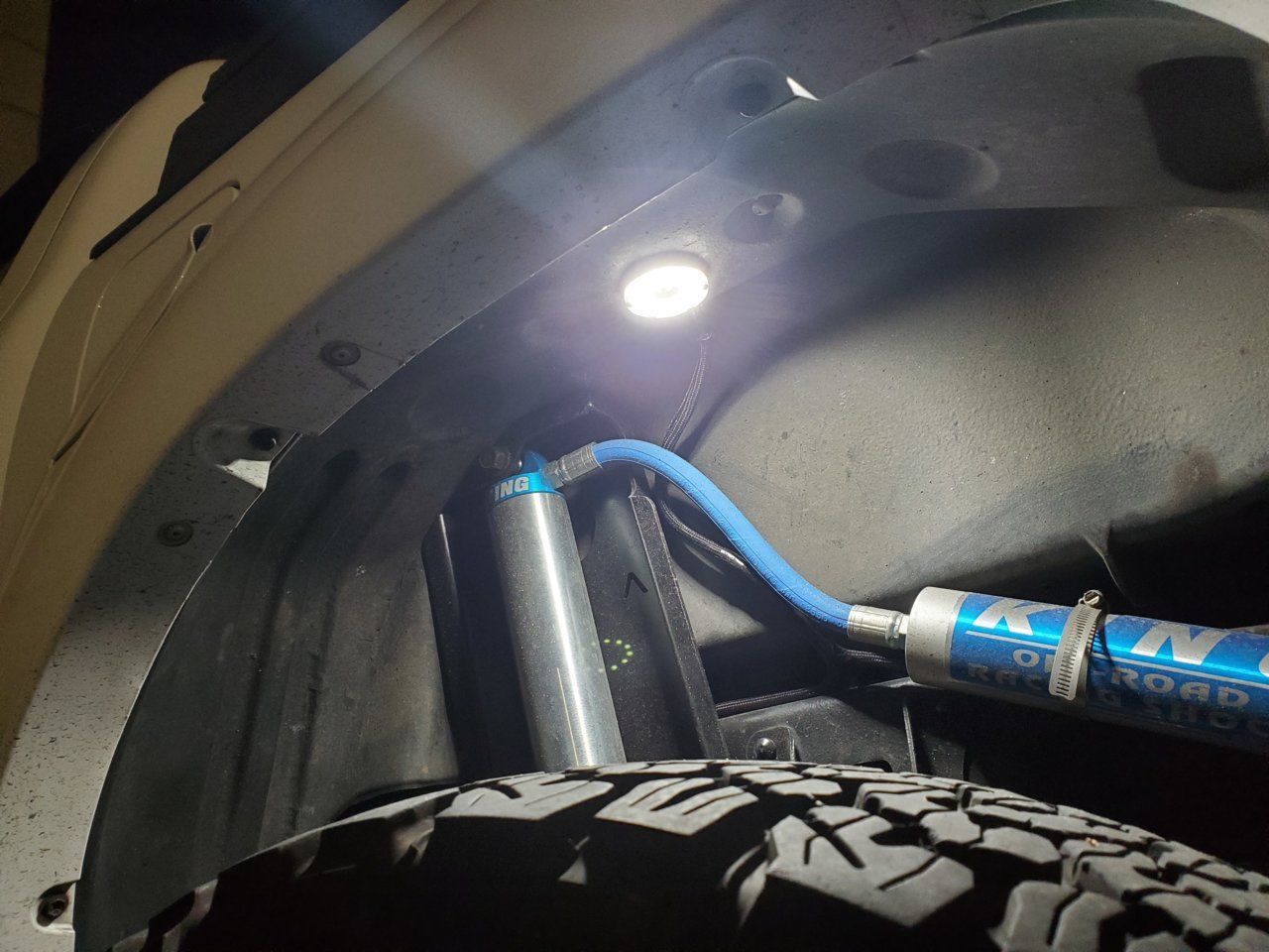

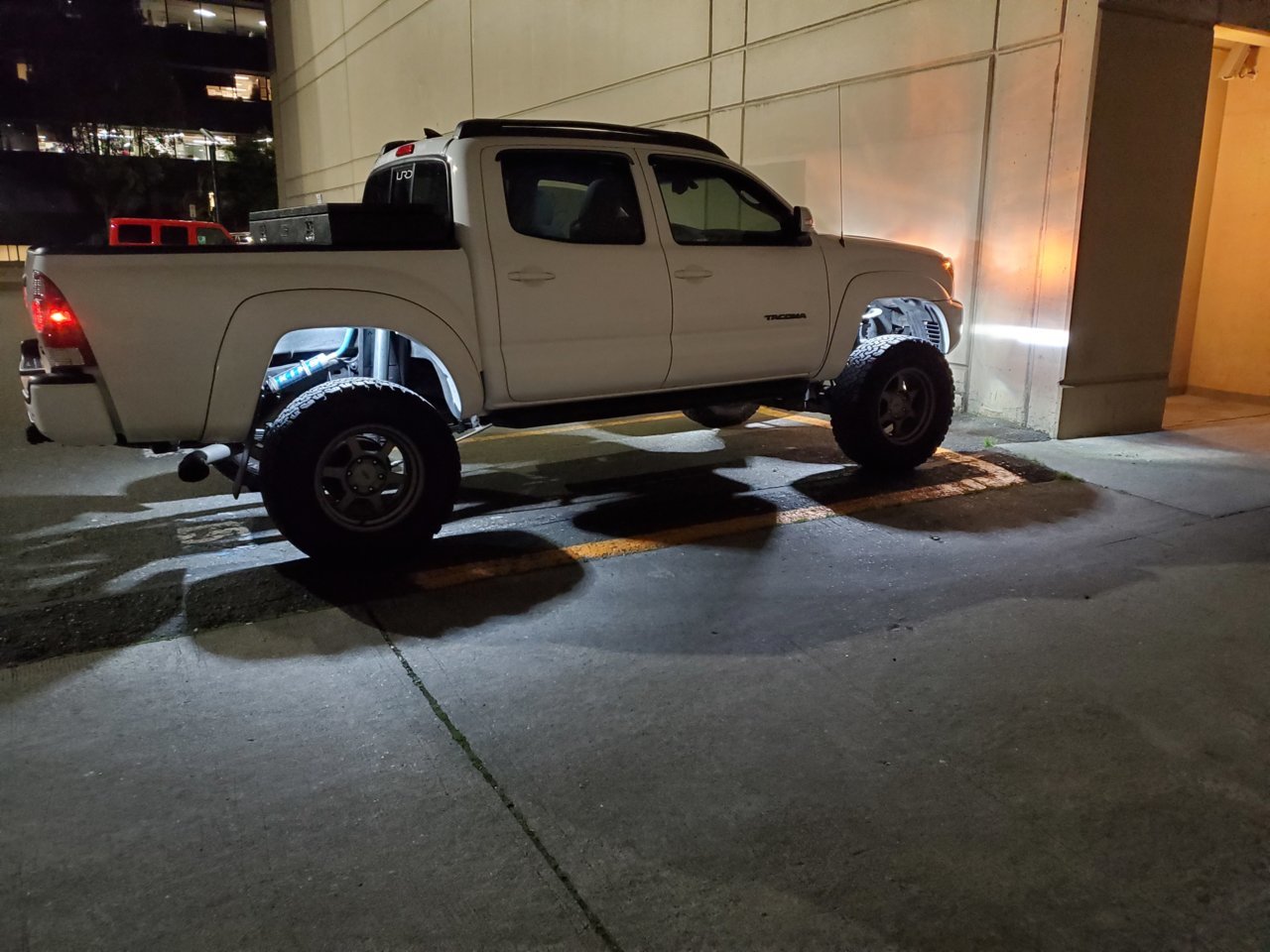

    So i tapped a constant power lead so i had the choice of using these without keys in the ignition.
    After swapping axels i had an open switch bay. 20 dollar Amazon rock light switch for now. Honestly would prefer a stock oem foglight switch. If i can find one at less than retail. Passenger front wire is routed through the engine bay instead of under the truck. Ran it down the drivers side frame rail then over to the passenger rear. everything is water proof crimp/shrink connections and loom coverd. these shots are under dim city lights. Big thanks to @crashnburn80 for the testing and inspiring.20191002_063232.jpg 20191002_062531.jpg 20191002_062507.jpg

    Looks sharp! I know you really just wanted to show off those killer Kings. :D Need to get some better output shots in a dark location, I know a few around my place with very little light pollution.
    Any comments on the ease of using the magnetic mounts in those locations?

    fronts are simple, anywhere. For the rear test fit. youll have a weak reading but theres a metal support brace under the mud skirt. top center. i just used a sharp razor knife and cut a small circular hole. trimmed carefully so its only as big as needed. ill take another pic of that later.
