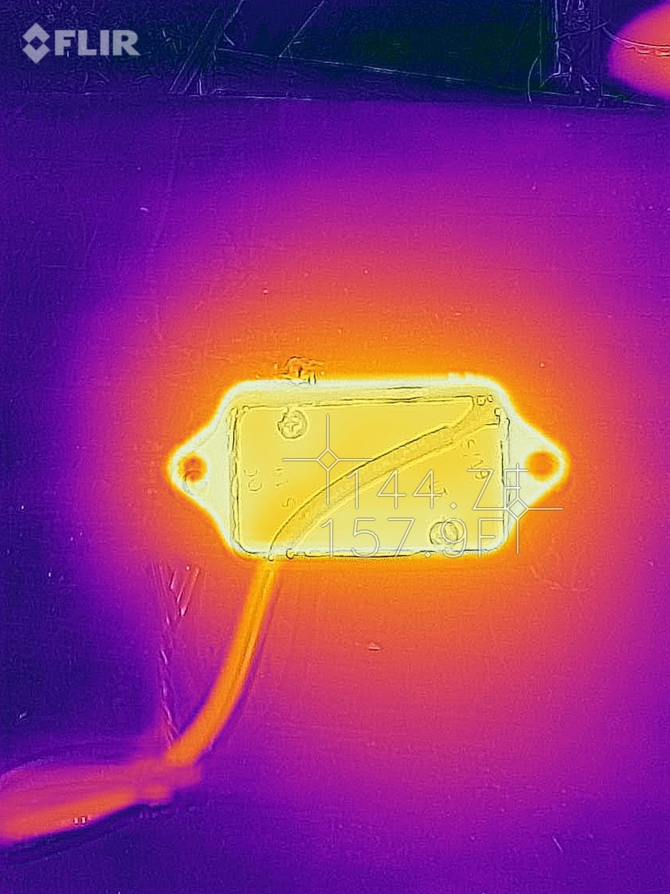

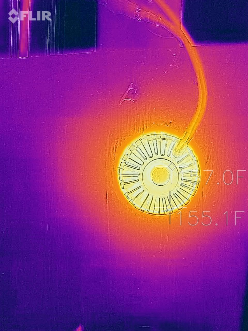

    Testing out a new FLIR thermal camera.
    The Cyclone has very consistent temp across the back as one would expect being a single piece of solid aluminum.
    The back of the BD light is filled with resin, like the Rigid light. Resin is a plastic insulator and pretty obvious in the thermal image this doesn't conduct heat well as there is over a 13 degree difference between the back of the light and the outer body.
    While the peak recorded temps are very close, Baja's temps are slightly higher even though the KC light draws over 20% more power and are over 50% higher in output intensity.

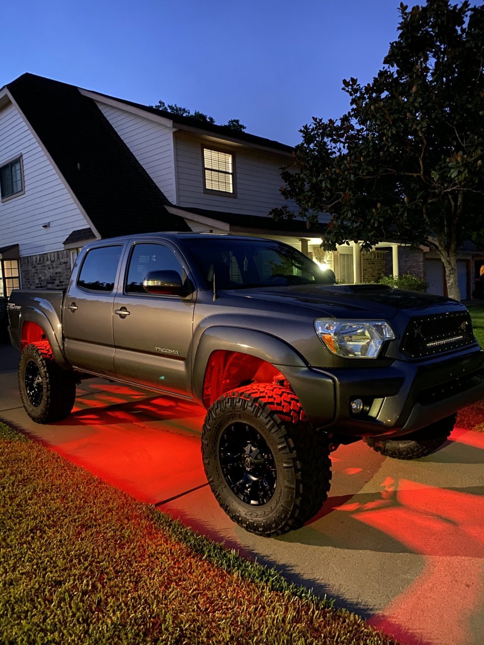

    How many did you install?

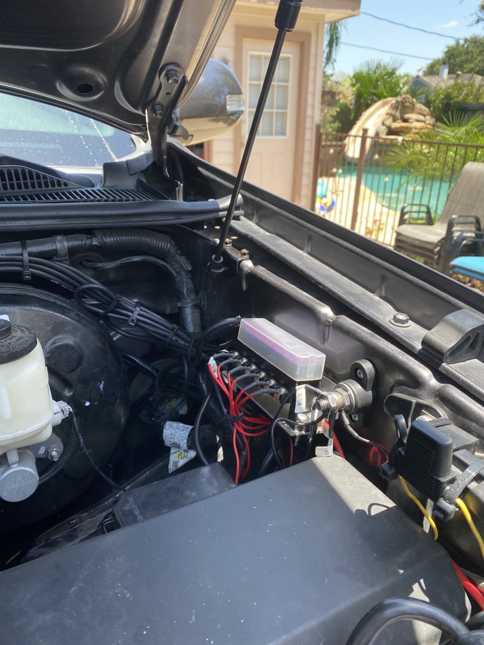

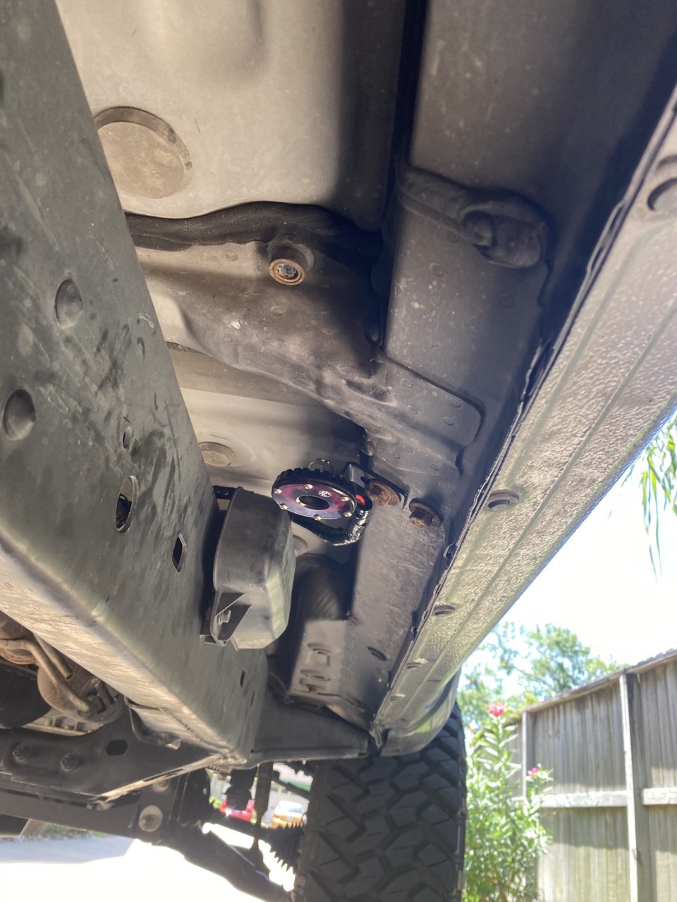

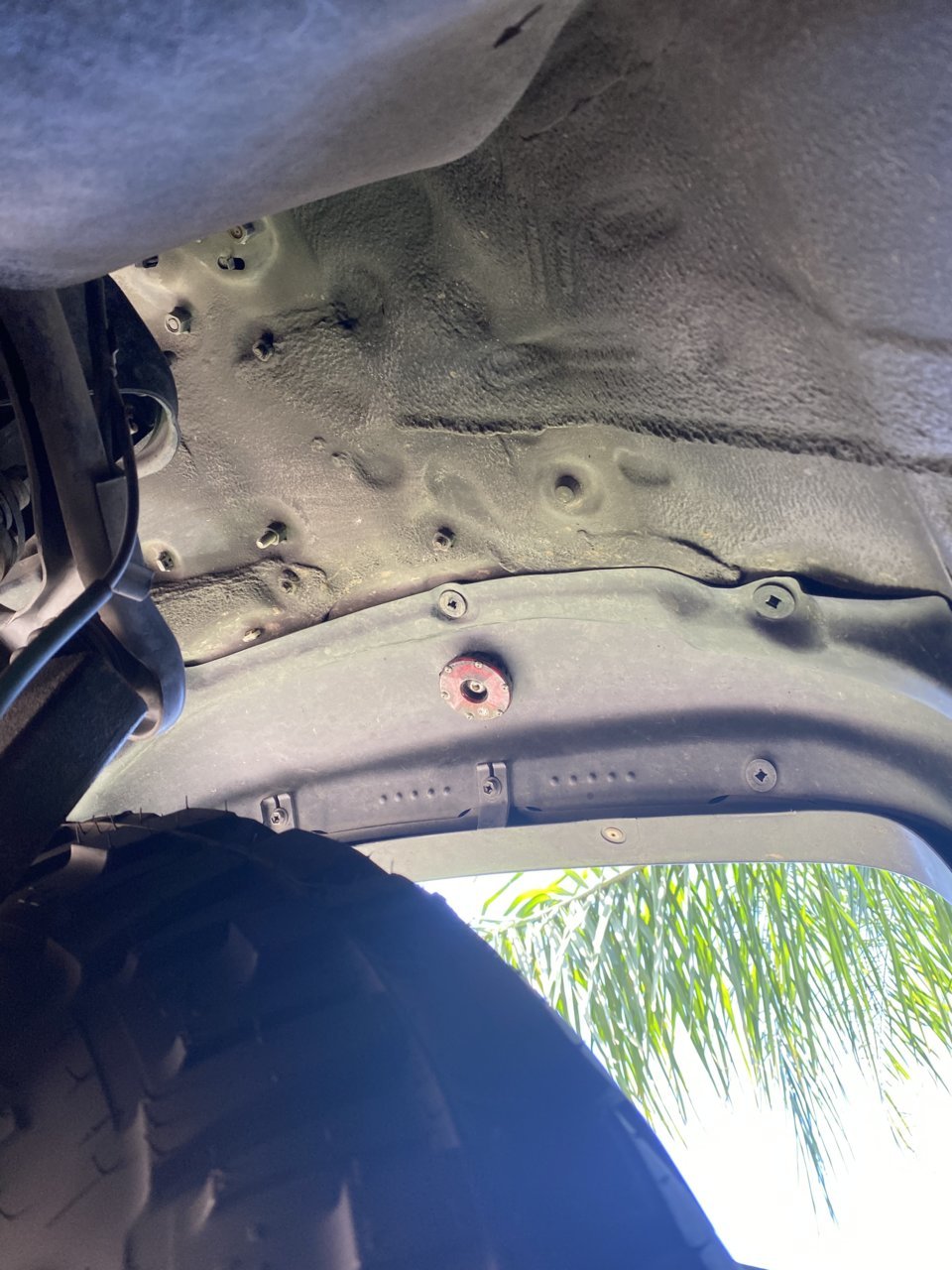

    I installed a total of six (they sell in a pack). I tried to limit as much damage to the body as I could so utilizing the plastic in the wheel wells and bolt ins that were originally used to hold my factory side steps came in handy.
    As for the fuse box (just to be fancy) I cut a piece of aluminum so it had a place to sit. The install was only a few hours due to the fact I’m OCD when it comes to wiring.
    I am probably going to get more and add some to the interior, but I’m really happy with how the lights came out. B36B5EE7-2FEA-4F29-A102-A43EB56976A4.jpg55EBDDB7-90DA-430D-930B-C8CDF78B88F1.jpg 3A21D51B-B278-4F9F-BD23-98B4A6E31FA5.jpg

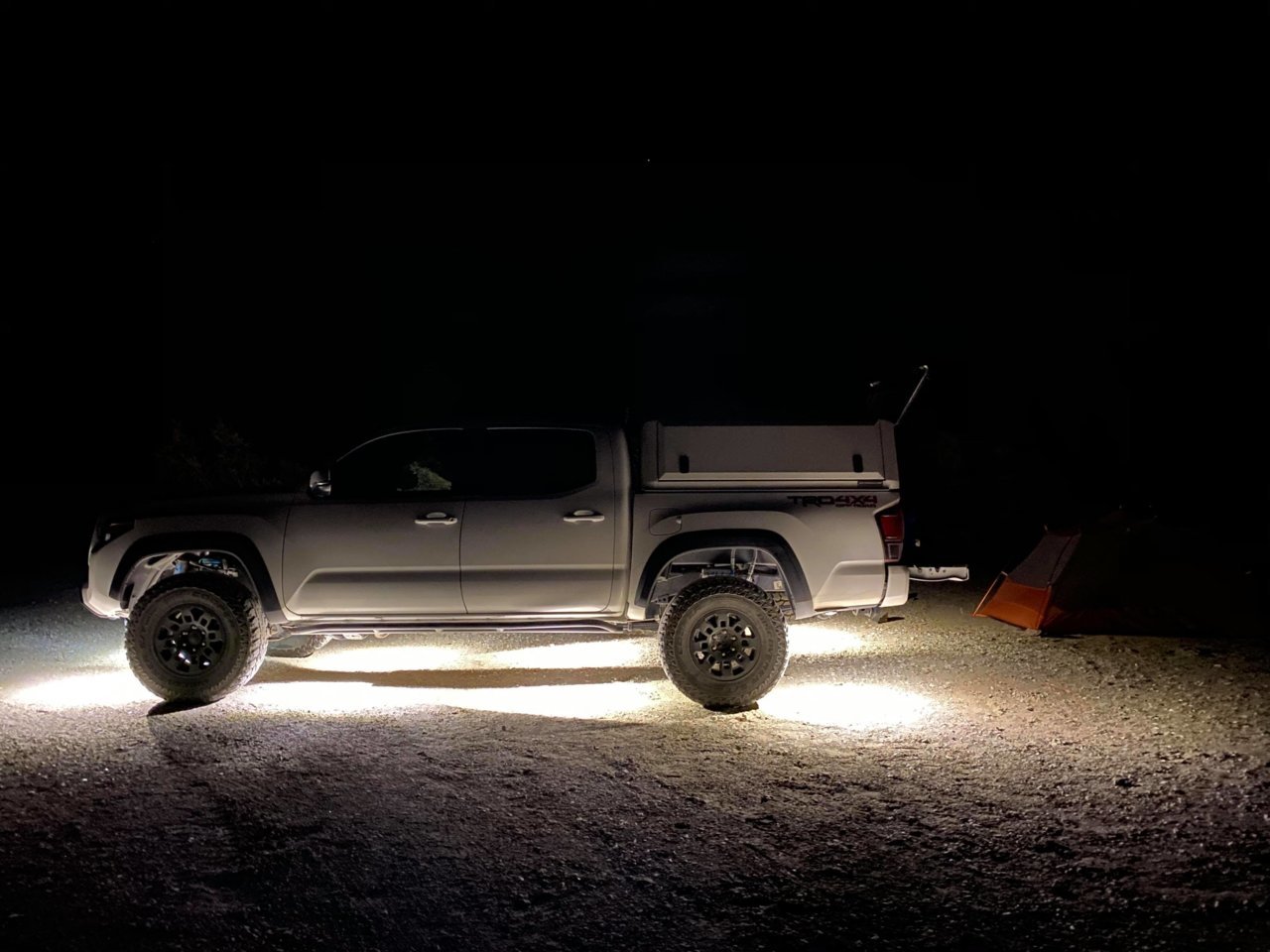

    If this is the wrong spot, LMK and I will delete, but tried to find the biggest rock light thread and this seemed to be it. Figured some might want to see how the lightforce rok9's look. This is a quantity of 8 taken at a recent camp. Super useful, almost too bright (good for tire placement when wheeling, but a bit much for camp lights which is what I use them for mostly) but can be dimmed via the switch pro ap.
