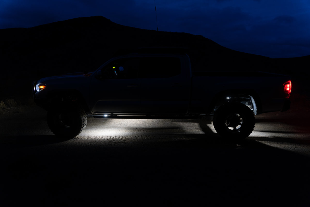

    Believe it or not we're actually working on something that internally we're calling the "rock light project", but we'll hopefully come up with something cooler than that addressing this exact thing.
    Our thoughts to this point are that you should have a set towards the front to capture the approach, a set towards the middle for an overall underneath view, and a set lighting your departure. We don't put any in the wheel wells...
    Here's a pic showing you that 4 rock lights doesn't quite cut it on a DCLB.

    With 6 lights, you typically put one at the top of each wheel well which should give some spread ahead and behind each wheel, and one roughly centered in-between the wheelbase. Mounting the lights higher up in the wheel wells allows them to illuminate a larger area, with the note that the tires will cast a shadow. Depends on the purpose too, as @memario1214 picture demonstrates the wheel well mount illuminates both behind and forward of the tire but really blocks light to the outside of the truck.

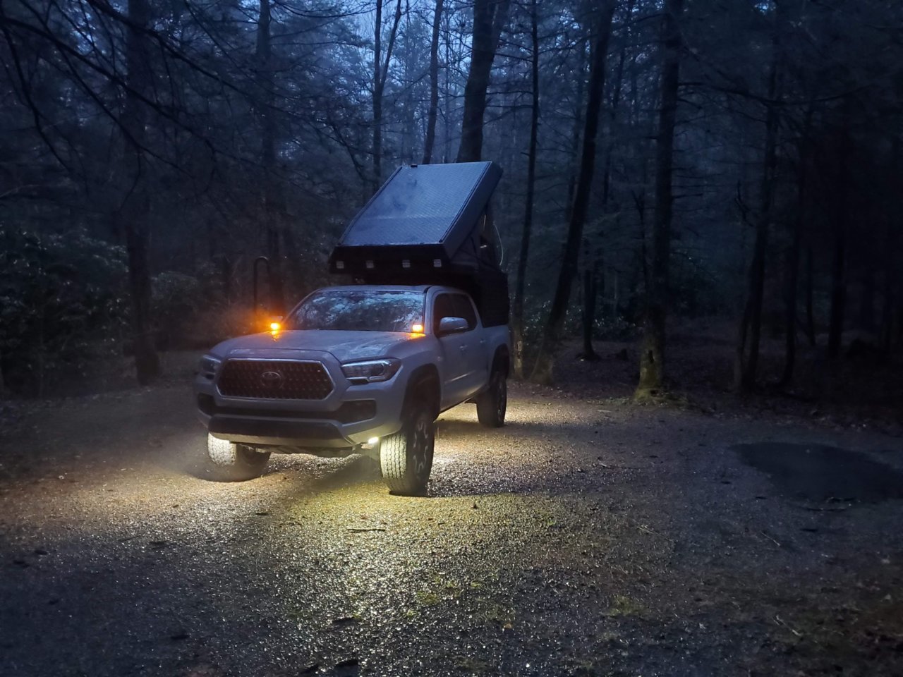

    I'm running 6 cyclones, 2 mounted on front bumper, 2 centered on the b piller and 2 on the rear bumper.
    I found above the wheels looks cool, but wastes alot of light. Not alot makes it to the ground

    Hey, @MJTH! Thanks for your reply and suggestions. The image is really helpful too!
    My buddy, @memario1214 and I were talking about this very thing a few weeks ago. They are “rock” lights not “neon” lights. :)

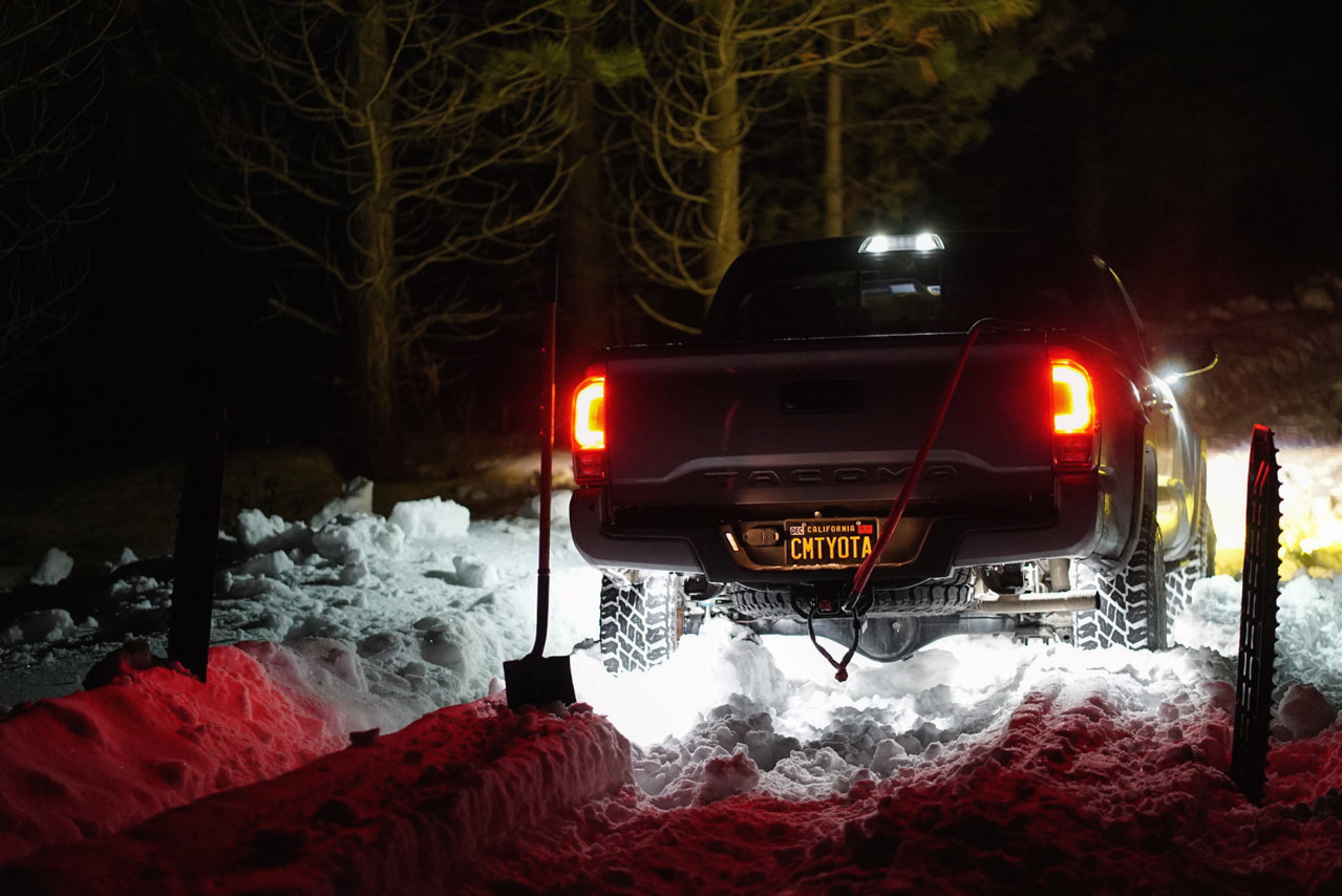

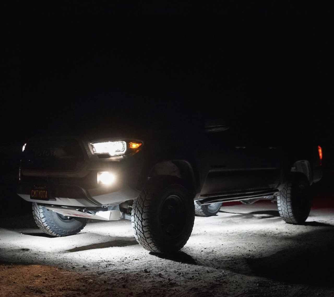

    Old pic. Here is my 9 KC cyclone set up. Cylones in front and behind each tire with 1 under the center of the truck. I was trying to eliminate shadows. Overkill but I like lights.

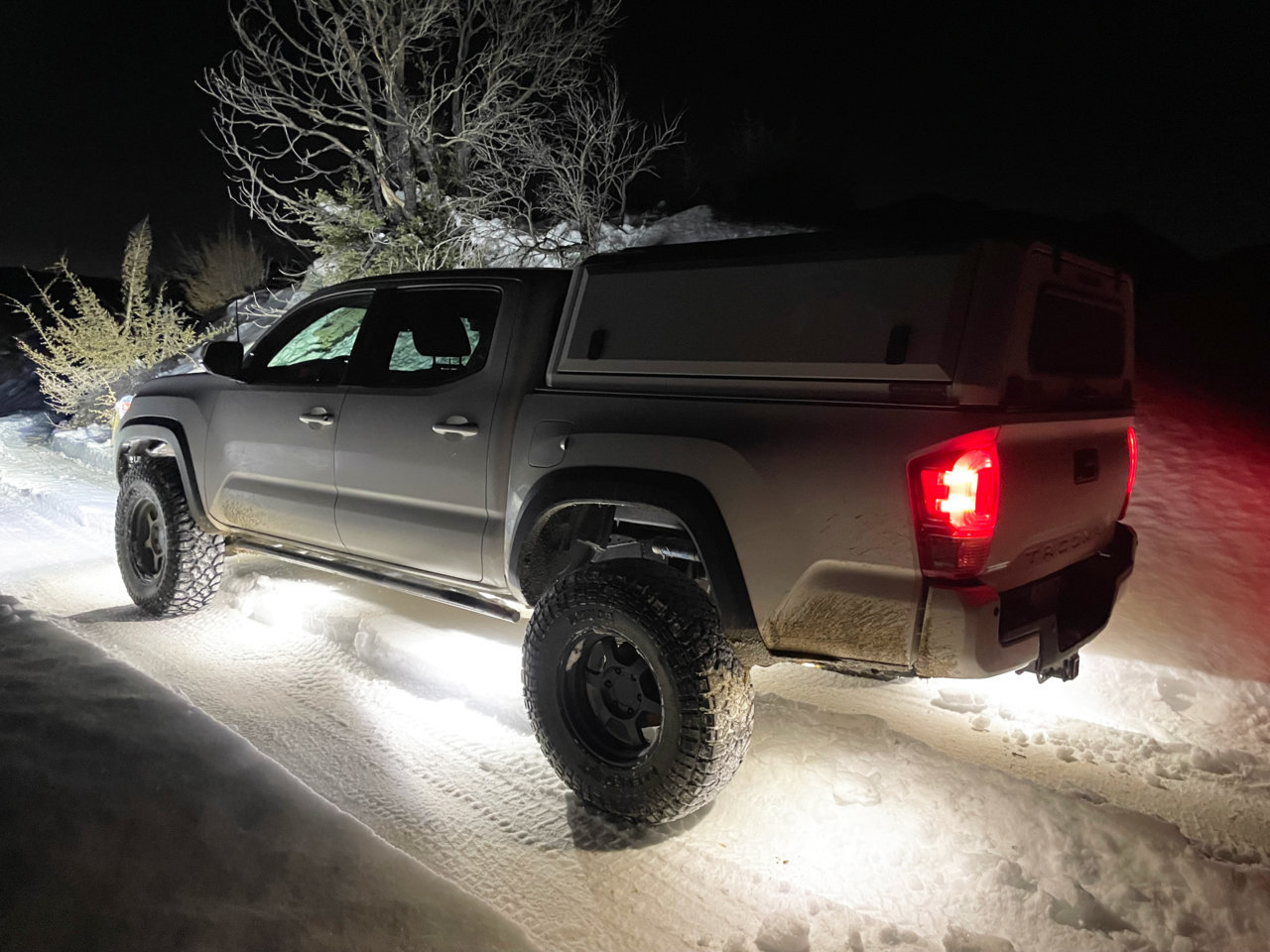

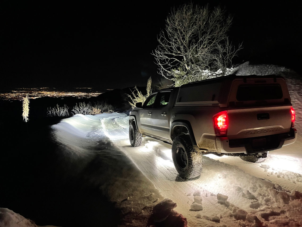

    Kings/Deavers/SPCs 35x10.5 Kendas, LRA FuelTank, WARN Zeon10s SDHQ mount, Switch Pro, LightForce rock lights, reverse light & Lightbar, Baja Design Squadron Pro fogs, CaliRaised Sliders, RLD Canopy, Odyssey group 31, Dometic CFX3-55IM
    I agree with the dudes above, I think eight is the right number for most trucks if you are actually going for functional illumination (not just illuminating your suspension and casting harder shadows where you want to see... I'm running 8x LightForce Rok9's. Rear lights in this photo look to be casting a warmer tone, but that is just a bit of mud on them. They're pretty bright and push through quite a bit until they need to be wiped off.
