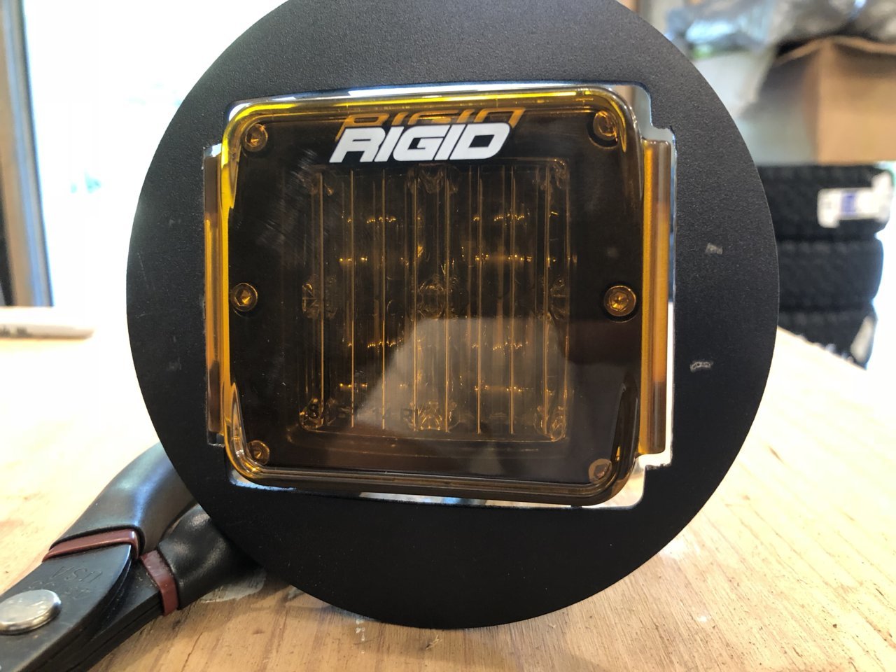

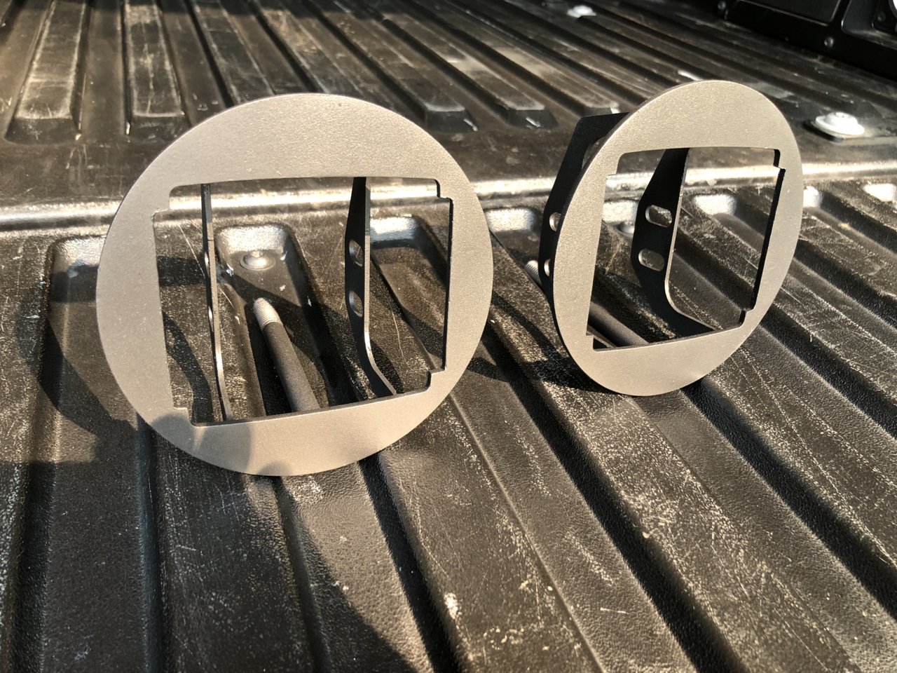

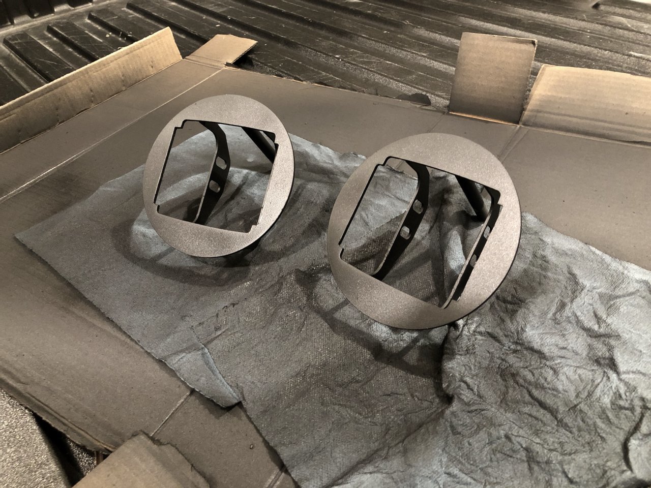

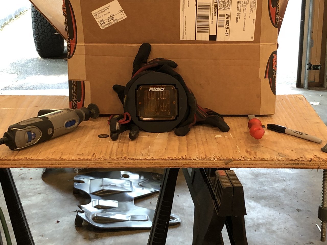

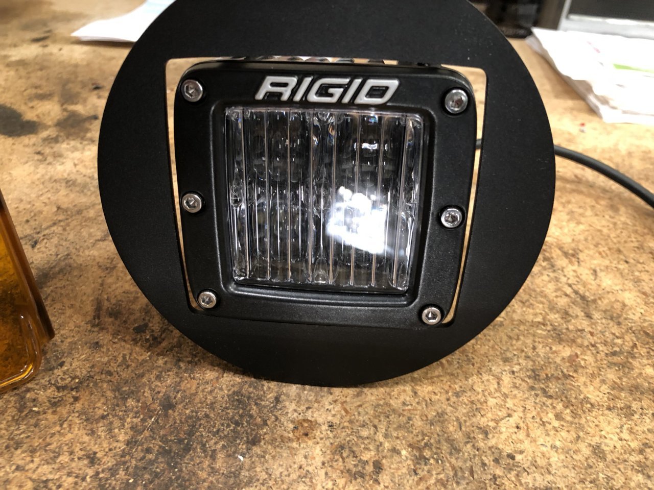

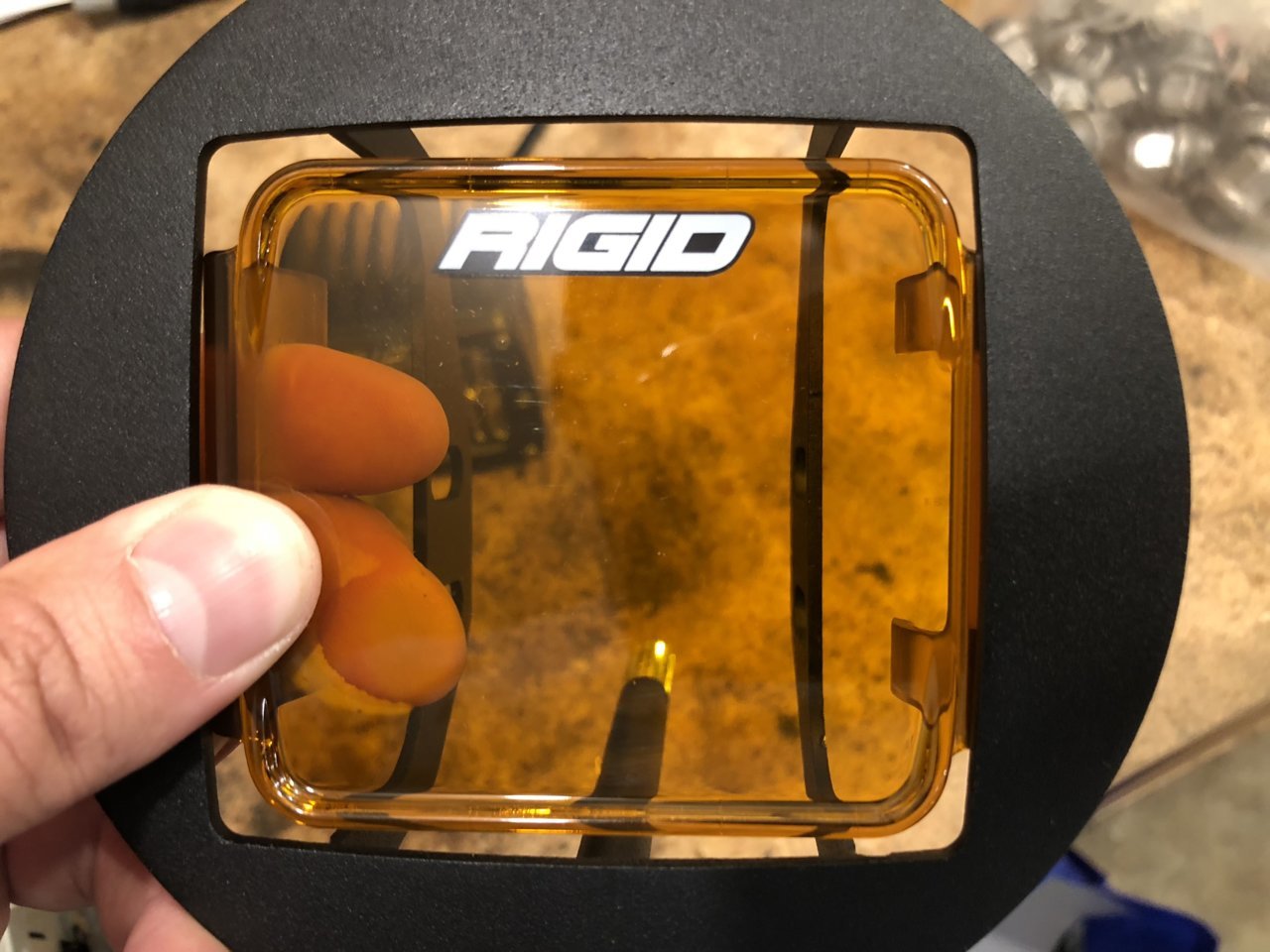

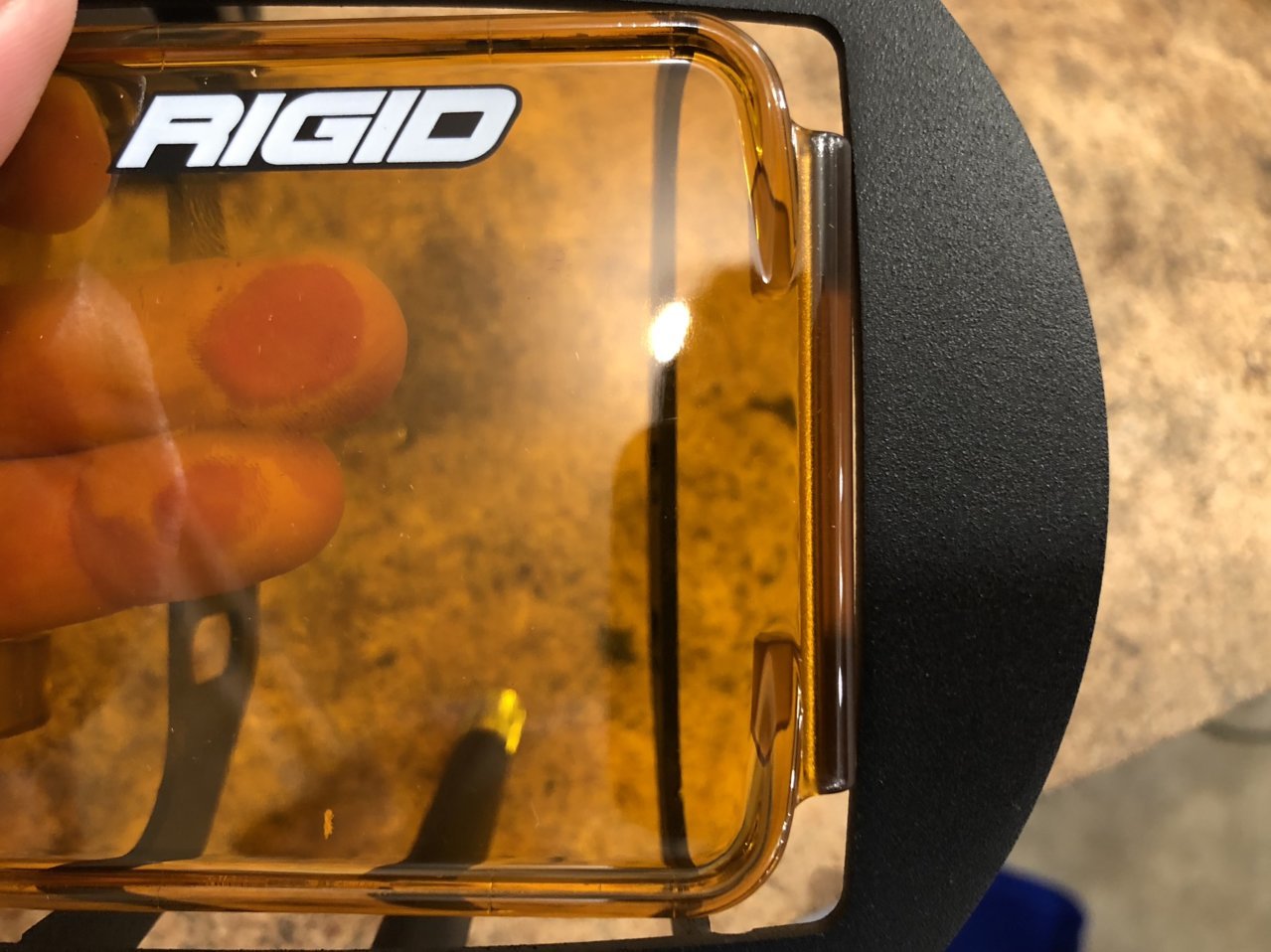

    Have a 2005-2011 Tacoma and looking to run amber LED fogs but no product exists to do so? KC G4s only fit 2012+ trucks, and the pod brackets for 2005-2011 fog pods will not allow fitment of pod covers to run amber.
    Modify the pod brackets to work.
    Barely enough room for the pod, not enough additional clearance for covers.
    Covers do not fit.
    Approximation of material that needs to be removed.
    I always promote very high quality well built products. actually built their light mounts out of cold rolled USA steel, these things are built well enough to be suitable as armor. Who builds light mounts out of hard cold rolled steel?! Using the highest powered Dremel model available, I picked up a 5 pack of extra metal cutting Dremel discs for the task. Cutting the mounts consumed 4 cutting discs.
    Raw test fit before finishing work.
    Rough edges filed down, raw edges hand painted with anti-rust paint, assemblies resprayed in antirust paint for uniform appearance.
    Done.
