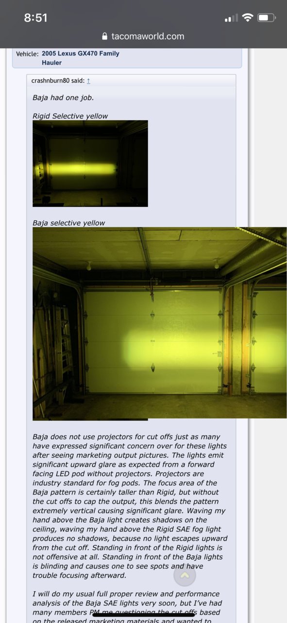

    A88AA2FE-8F3F-449F-BF4F-3D22A351C954.jpg 1266C77F-B341-4EEB-8B91-60F06E0416AA.jpg Wanted to get a comparison of before and after. Best I could do, if the biggest issue before was the cutoff then it looks like they accomplished it. Properly aimed and in the Tacoma it may not be that far off.

    This depends on the light. A light such as Baja with maximum legal glare, running 2 sets would cause excessive glare. A light with much more refined optics and glare control may not exceed the legal level while running two sets. However I believe only one set of aux lights is legally able to be run at a time, meaning two sets of fogs would not technically be street legal.
    Note that when the KC G4 ambers were reviewed they were the first non-white long wavelength SAE LED fog for the Tacoma. High color temp 'white' LED light is much less useful in situations where you really need a fog light. While long wave length amber does great in cutting through fog, the output intensity is relatively low as is the contrast, and colors appear a bit monochromatic. Selective yellow offers much higher intensity output, with better contrast and improved visibility over amber while retaining the same long wavelength poor weather performance benefits. The KC G4 is an excellent product and one I highly recommend in their 5000k white, but for amber, newer selective yellow products from other vendors offer better performance.

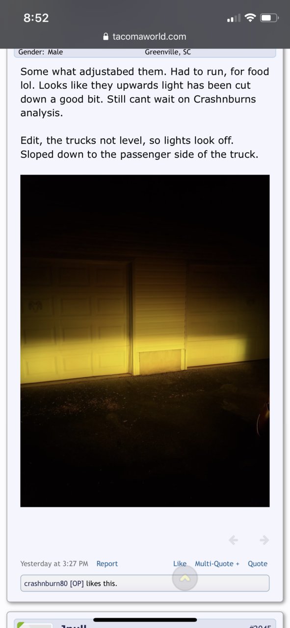

    On the top pic is on my F150, the little but of orange or yellow above the modified cut off might be my turn signals I park mode being on. It is less glare up high but not as intense as Rigid or Diode Dynamics. I still have yet to aim them 100% since the paved part in front of my garage is not level, tried my best with a measuring tape but will know how off I am tomorrow when I get to work.

    It's ok for a Ford lol. I'll know more about the cutoff both side and upwards tomorrow morning going to work at 3am. I know the roads and how the lights performed before the retrofit kit. However when I did take it out Friday night I wasn't really paying attention, more focused on the free dinner lol. They side cut offs do seem harsh, not sure if they could have cut, no pun intended, the "blinders" in the lens to allow more side lighting or chamfered it to allow more. Maybe some is brave enough to modify there kit to see if they can get a wider light with out hurting the upwards cut off. My opinion seems like Rigid or Diode Dynamics is the way to go for general/universale mounted fogs. Nownits I had a Tundra I'd have more options, one day lol.

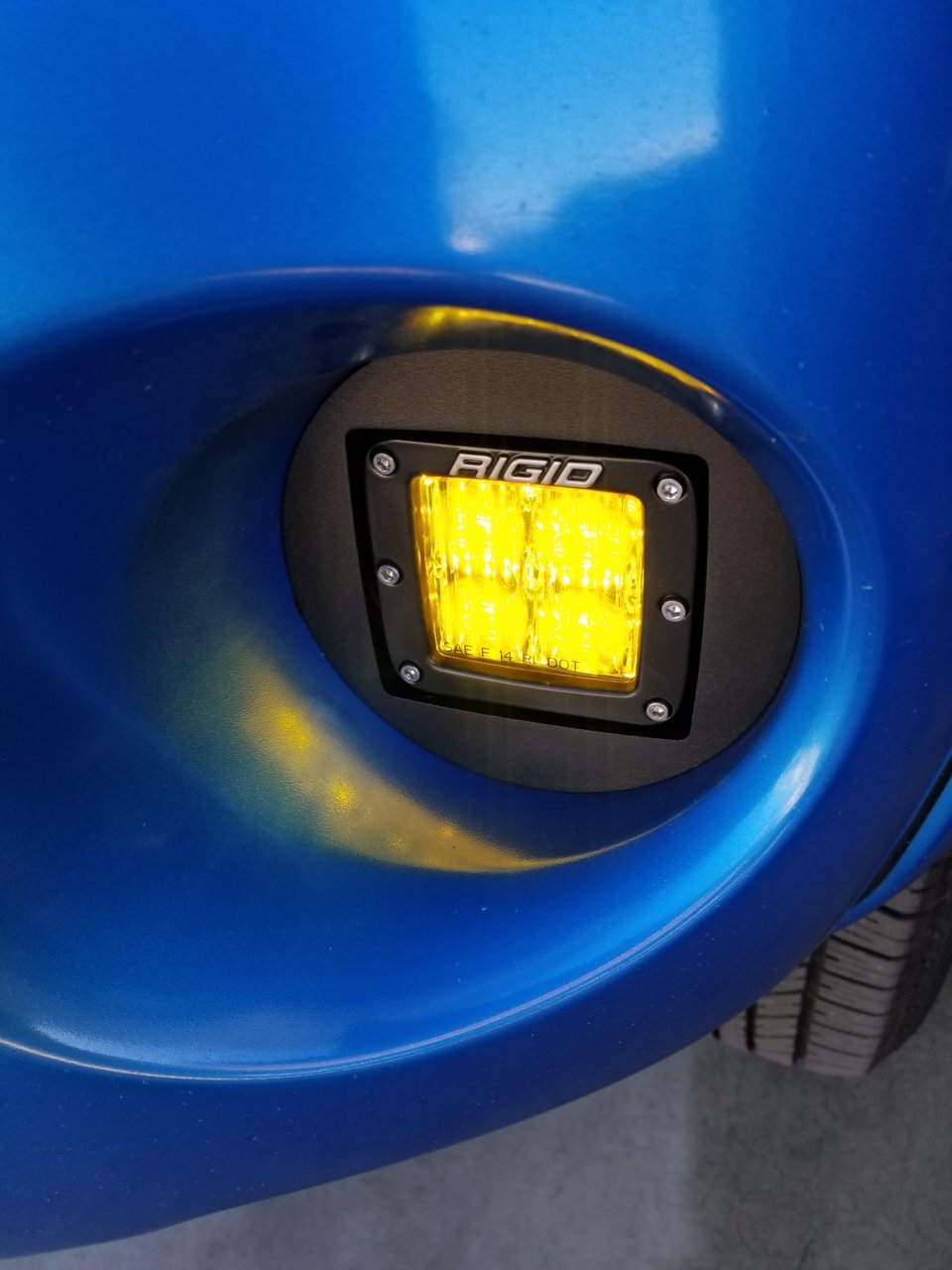

    For Rigid you have those D-Series plus the Rago Fabrication Rigid fog mounts or the round 360 series with the upcoming OEM mount. The 360 OEM mounts have been delayed, latest is they are supposed to be available mid-Jan.
    3rd Gen D-series mount:
    https://www.rigidindustries.com/201...t-kit-sae-compliant-d-series-pair-465673.html
