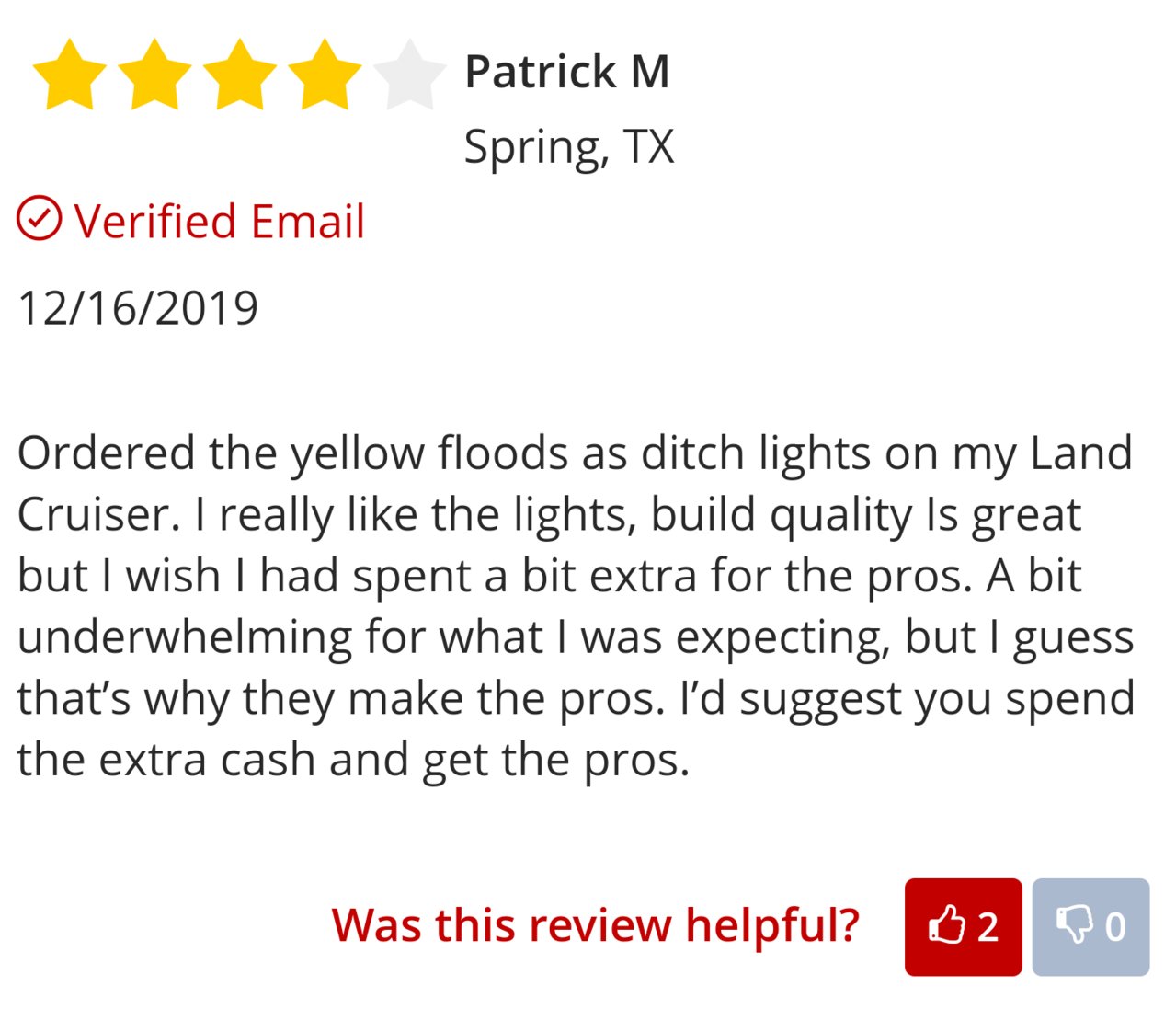

    Read the reviews on DDs site, one guy that got the yellow sports said they were pretty underwhelming and he regretted not getting the pros.
    If anything with yellow there’s less perceived output so I’d think it’s even more important to get the pros if you’re going yellow.

    The sports use smaller emitters. With the TIR optics, the smaller emitters have more focus, just like performance halogen bulbs use smaller filaments for greater focus. Greater focus of the sports give sharper cut offs, they meet a more modern F3 fog spec vs the Pros meet the older F spec. Both are street legal in terms of their cut off and the Pros offer greater output intensity. I'm still waiting on mine to review but the Sports spec the same output intensity at 10 meters as the Rigid SAE selective yellows I run, which are great. I'm not sure how one could say that level of intensity is 'underwhelming', unless they really didn't understand what kind of product they were buying. Until the launch of the DD Pros, no product has been able to beat Rigids SAE D-series in intensity and the Sports claim to match it while offering a wider pattern. This is all by specs as I have yet to test them first hand.

    Exactly. I wouldn't trust that reviewer either. I have my yellow SS3 sports installed correctly, pointed slightly downwards with the gap and they are quite impressive. Got my first "flash" with them as well. Some mid 90's Corolla didn't like how intense they were apparently. Been running them off now that I have tested them in the dark. Couldn't be happier with the 160$ black friday sale for the yellow sports. Great deal.

    I think this is the review you're referring to: he left it under the fog lights but he actually has the floods. The flood lights are meant to be very widely dispersed with low, even intensity. The fogs have the light focused in a much tighter pattern.
    Baja Designs has their "wide-cornering" optic which I think pretty much nails the requirements for a ditch light. A 42º pattern is wide enough to disperse over a decently large area, while being focused enough to rely on for cornering at speed. I enjoy my S2 lights, they're a fantastic and compact option here.
    The SS3 so far doesn't seem to have a competitive optic in this space. The flood is very widely dispersed for large coverage, but only for low speed and static situations (maybe the pro is better here). The driving and spot optics are fantastic for forward facing, high speed lighting but won't spread much. The fogs are very wide for their intensity but the pattern is short- it's meant exclusively for the fog pattern.
