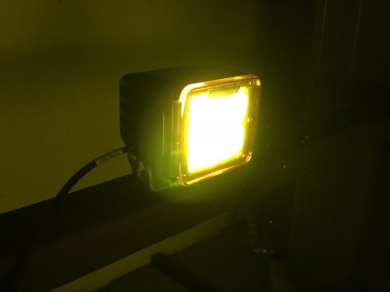

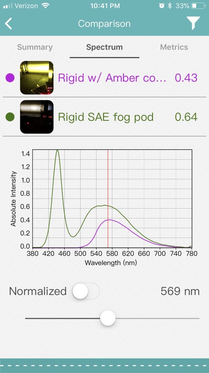

    In for this. Also how does selective yellow vs a simple yellow filter come into play here? Is it moot because LEDs have narrow wavelengths? I also thought selective yellow was better because it was all of the light just no blue.

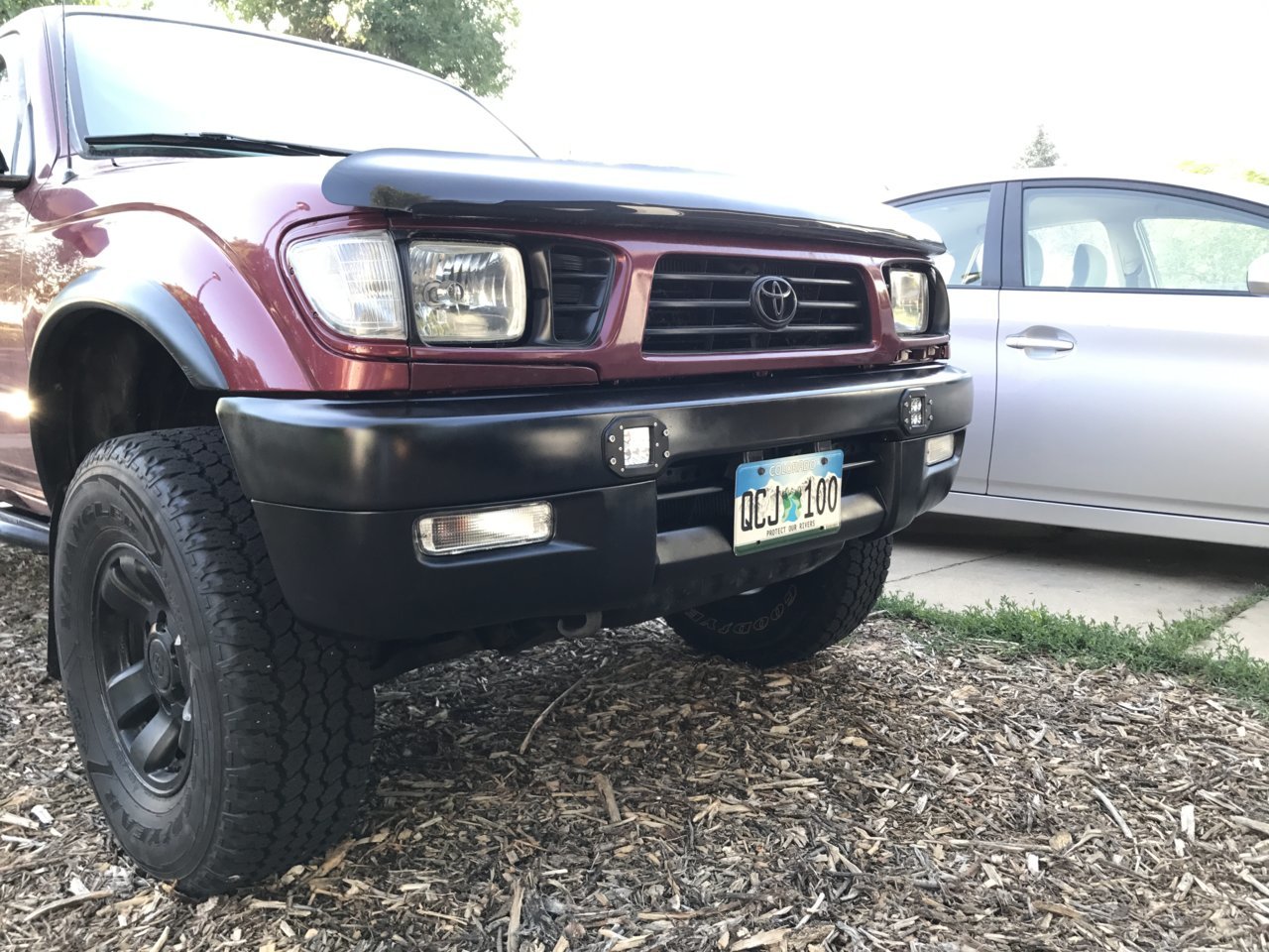

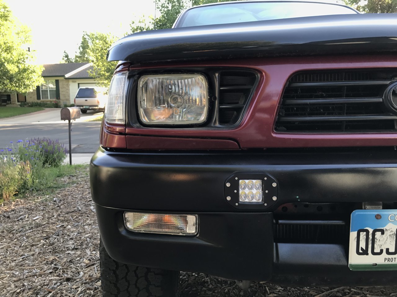

    Nice installation. I do have one question though. How do you aim them?
  8. Aug 25, 2018 at 8:34 AM
    #208
    Madjik_Man
    Madjik_Man The Rembrandt of Rattle Can
    Dec 2, 2009
    #26893
    19,607
    Colorado Front Range
    1998 Ext Cab 3.4 4x4 TRD 5MT, 2004 DC 3.4 4x4 TRD
    You don't. They're pretty flush, square and plumb in that portion of the valence. And I guess I got lucky a bit. Because when I turn these on they light up the road and sides of the roads incredibly well. Which is was I needed with these lights (backcountry/mountain/canyon roads). They also do really well on trails at night but I very rarely find myself wheeling in the dark.

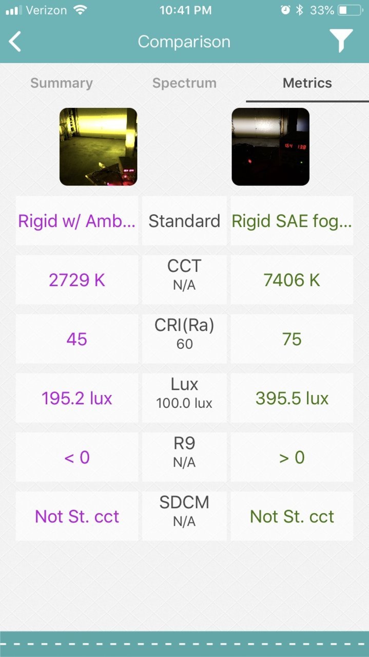

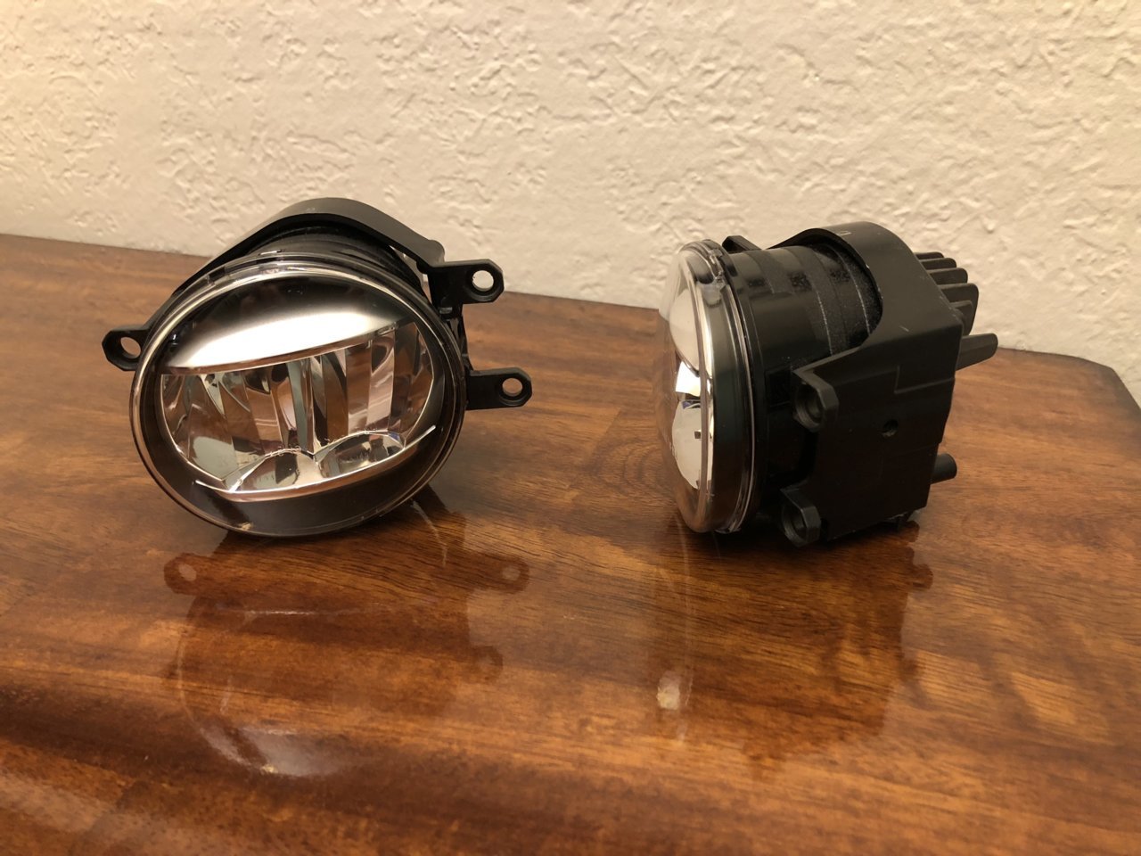

    In my original writeup I did miss the OEM Lexus LED fogs that are a bolt in replacement for the Tacoma. (Lexus is made by Toyota for those that did not know). @Mtn Mike was generous enough to send me the fogs out of his truck for comparison testing.
    Measurements:
    Color: 6148k
    Power: 10.1w
    Lux @ 18ft: 196.2
    These lights use 2 top down firing LEDs with reflectors to reflect the light forward. They are made in Japan and being OEM Lexus I'd expect them to be high build quality. The 2 LEDs have a unique offset cut off, so the driver side of the beam is a little lower than the passenger side, there is a step up in the center of the pattern to a slightly higher passenger side beam, similar to projector headlights to reduce light and glare for oncoming drivers. The pattern is vertically narrow like the majority of the fogs in this thread, to where KC and Rigid provide roughly 2x the light area coverage compared to the OEM Lexus product. The cut offs are not super clean, so there is some glare emitted from the fogs, which is likely caused by the flat spots in the reflector at the base of the fog light reflector assembly. Compared to the other drop in replacement LED fog lights, these are a little brighter than the Morimotos (170 vs 196 lux), but also higher in color temp (5500k vs 6148k). The KC G4s are significantly brighter (296 vs 196 lux) with 2x area pattern coverage and much lower color temp (5062k vs 6148k).
    It is currently raining (thankfully with all the fires and smoke) so outdoor pattern shots will have to wait for tomorrow. I'll add these to the original post when I have some more time.
    Thanks to @Mtn Mike for the addition to the thread!
