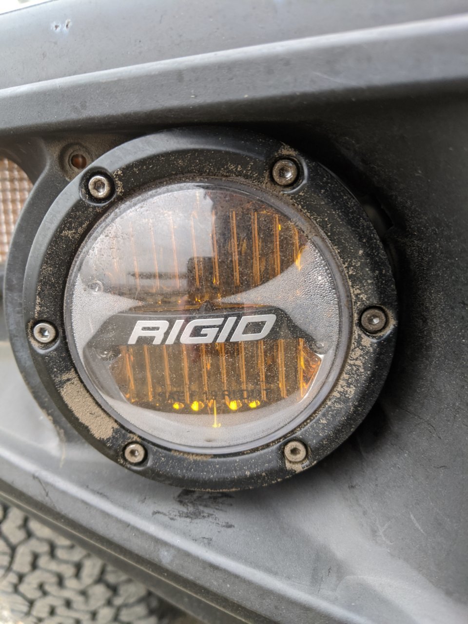

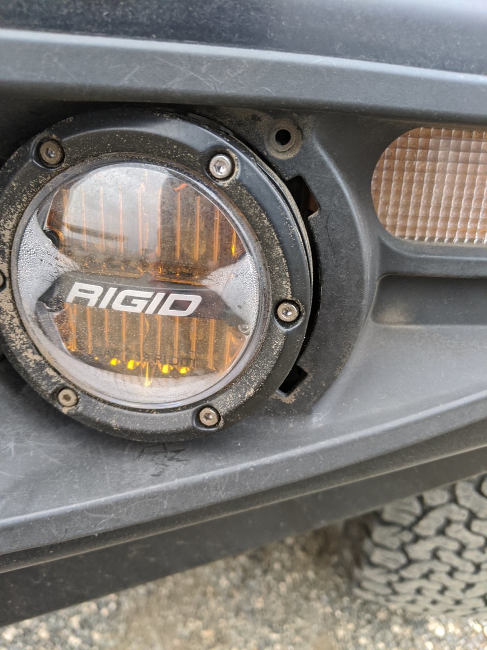

    I'm no expert either, but I did not run into condensation issues with the KC G4 fogs that these replaced. Those were used in the same conditions for two years. I had my fogs running for two hours at a time getting over the pass and back and these Rigids run hot so I was very surprised to see condensation.

    dang lol. maybe the rigids need more venting?

    I'm hoping these were just a bad pair. I've had condensation issues with cheap eBay and Amazon lights and over time they look like shit inside.

    i should take back what i said. im thinking it shouldn't happen to small housings at all

    A quality sealed light shouldn’t get condensation inside, definitely not normal. Rigid had an issue with that years ago but I’m surprised it still happens, especially considering what those cost.
    Their warranty should take care of you no problem, back in the day when this was happening they swapped lights out without a problem but after a few sets with the same issues they went to a different brand.

    You shouldn't be getting any intrusion on a set of Rigids. The OG Duallys, yes. But not on these new ones. I would say give them a couple more days of burn-in, but I'd push em pretty good on it.

    I had same problem with an OEM Rigid fog, I had to fight with the dealer to replace it.

    o god that's a nasty one!

    Yea Florida is full of rain and the replacement held up luckily

    The outer lens appears sealed separately from the rest of the light. You shouldn’t be getting condensation in there. Makes me curious if there is any venting into the light body of that intermediate chamber, as that could be problematic if not.

    Hi Yeos. Sorry to hear about this issue! The lens is sealed to the body and that trim ring is just for looks. The lamp has a vent on the side to equalize pressure and allow moisture to be expelled - but that vent also allows water vapor to pass into the lamp body in humid environments when the lamp is turned off. The fog on the lens should dissipate pretty quickly when the lamp is powered on. If it doesn't go away after like 30 minutes powered on, then there could be a leak causing excessive moisture in the body. Rigid customer service will get you a replacement set if that is the case.
