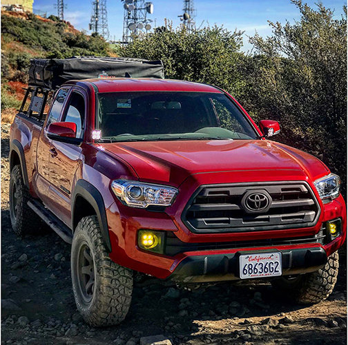

    Hi All,
    This is my first post to Tacoma World and I wanted to shout out to @crashnburn80. I’ve been trying to figure out what I want to do for lighting and I’ve probably read most of your threads by now.
    I’ve got a few questions for the fog lights.
    I read your post about how you shouldn’t run LEDs in reflector housings meant for halogen like the 3rd gen fogs. Any thoughts on Diode Dynamics Fog Light LED? Supposedly made for fog light applications and comes in white or yellow. My guess is, it still causes glare but it’s just not as bright.
    I’m assuming for the replacement lights, if they go out you have to replace the whole fixture right? No bulb changing.
    I really like the color of the Baja Design’s pods but like you mentioned I want to run a street legal fog. (I think I posted an example picture.) Do y’all think the Rigid and the KC fogs are similar in color? When I think amber I think orange not yellow. Is it just the same thing?
    Lastly, you mentioned about possibly comparing the amber KC fog to the rigid with amber cover. Anything in the works for that? I’m super curious to see how they match up.
    Again Crash great right up and thank you for all the information!

    Welcome to TW! It does look like Diode Dynamics came out with a fog light assembly similar to the Morimotos. Their full replacement assembly shouldn’t produce glare, it is the drop in bulbs to the halogen housing where that becomes an issue. They do mention in the listing it isn’t any brighter than stock though, I’d anticipate them being similar to the Morimotos in performance. I didn’t see an amber version on their website.
    KC has generously agreed to supply their amber G4s for this thread. However they are on backorder till November, I’ll include them once I receive them. Based on specs and my measurements of the Rigids with amber covers, I think the Rigids are going to be a bit lighter yellow whereas KC specs their wavelength at 580nm which is right at the transition from yellow to amber. ‘Amber’ isn’t orange for automotive lighting, is is more of a darker yellow. I’m not sure what the color temp/wavelength of the BD lights are for comparison.
    A quality assembly should last the life of the vehicle, they are typically rated at 40k-50k hours. If it was on the lower end of that spectrum and you ran them 4 hours a day, every day, they’d last over 27 years.
