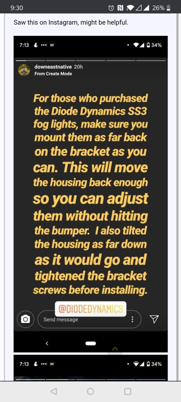

    How are yall aiming the DD ss3 pros

    Leave it just barely loose enough to adjust up and down

    I took that screenshot a while back...no credit for the original post.

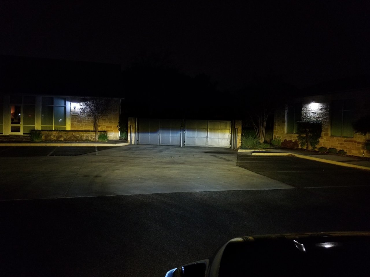

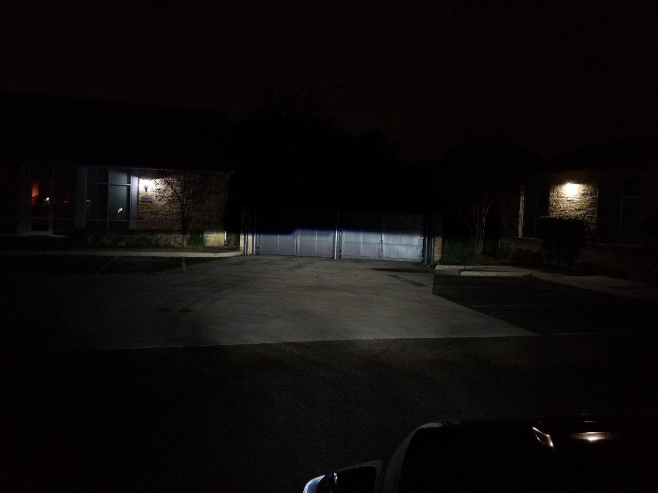

    Took 2 photos this morning with the camera settings locked. The dumpster wall is 50-60 feet away
    Low beam - 35 watt d2s projectors with 5500 Kelvin bulbs
    Low beam with SS3 Pro fogs

    Not bad, but I almost think they could come down a little.

    Looks like they are aimed higher than the headlights
