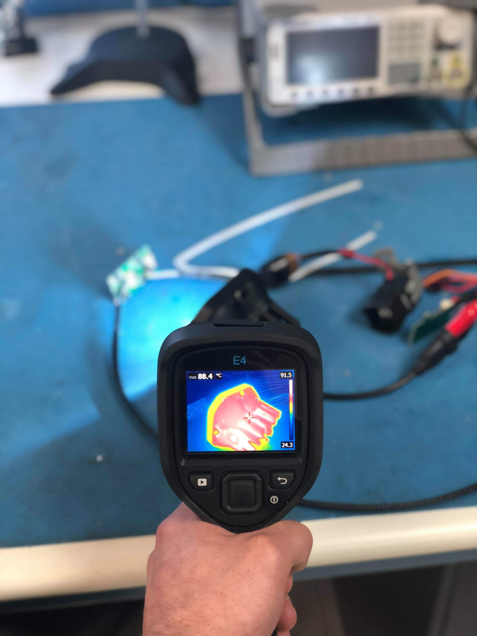

    Rumor mill is some people think these get a little too toasty; DD just sent me these photos.

    Does that mean yes or no? #Predatorvision
    Tretiak30[QUOTED] likes this.

    They do get hot, but I wouldn’t call it too toasty. That temp gun reading shows 191 degrees F (88.4C), my IR temp reading was just over 200 from the back of the pod after 15+ minutes runtime in an ambient temp of roughly 65 degrees.

    neo-garage.com
    That‘a not hot. Warm enough to melt ice or snow off it and clear it but think about how hot halogens or gas bulbs get

    I would say that’s around ideal.

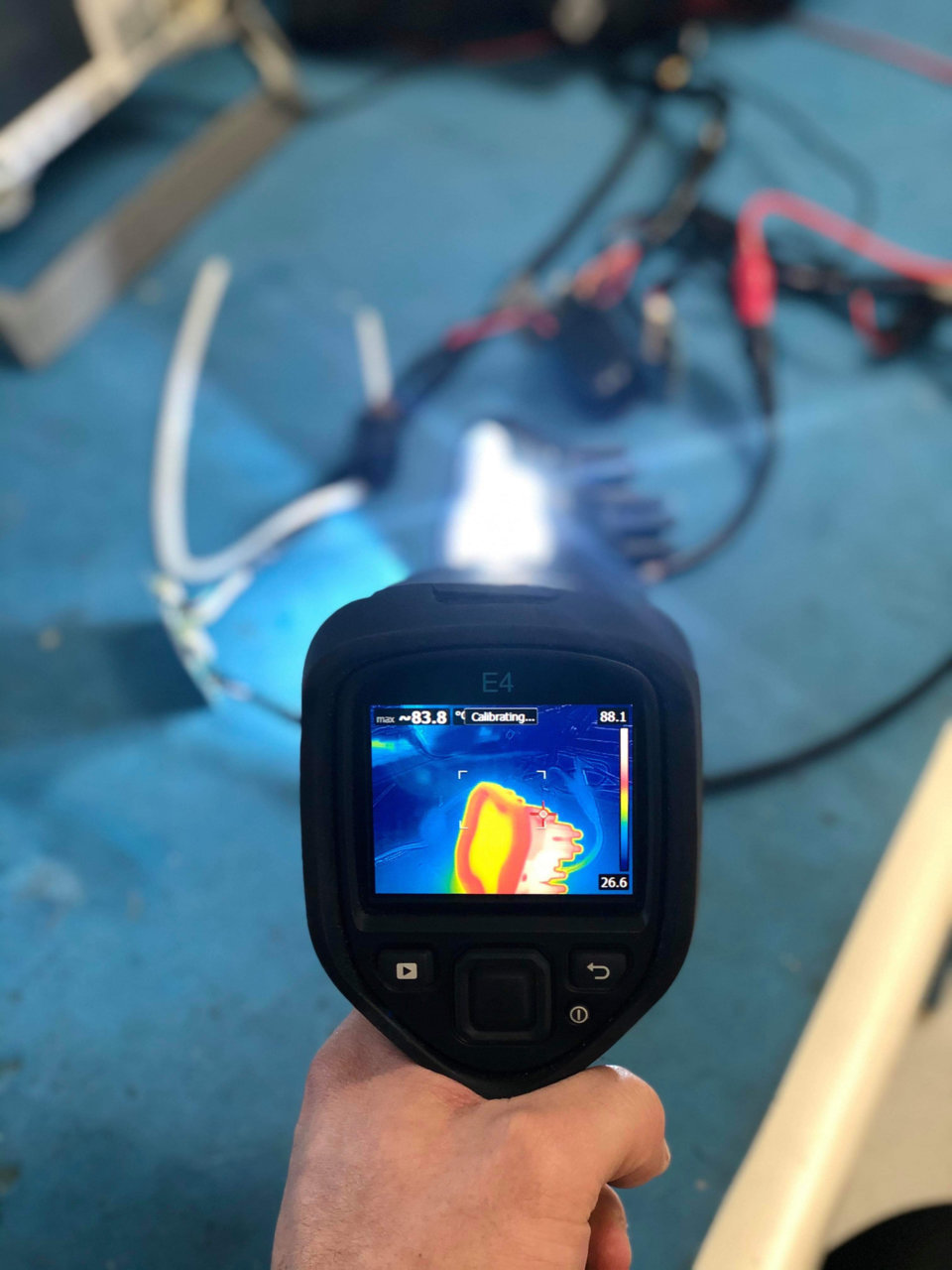

    The Sports were much cooler. Heat is a byproduct of power, and the Sports are 14.5w vs 36w of the Pro. The cooling design is the same and the Pro has nearly 2.5x the power, it is going to translate into roughly 2.5x the heat to dissipate. I did not repeat a comparable temp test in the initial assessment with the Sport but I will when I write up a full review. Keep in mind as well, with the LED pod design the back of the pod is always much hotter than the face of the pod. But when installed in the bumper, what is important for snow performance is the heat at the face of the light.
    For reference:
    Stock H11 TRD fog with ambient temp of 75 degrees.

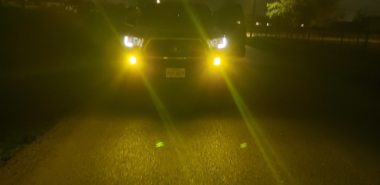

    Just installed baja design squadron sae but I'm starting to like those ss3 now :bananadead:.

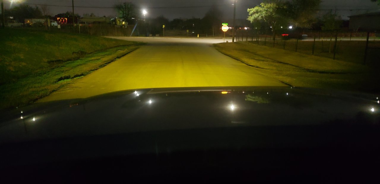

    Is that with the new SAE lens or the old one? Looks like it still just floods the whole area.
    you can see how crisp the cutoff is with the SS3 SAE Fogs.
