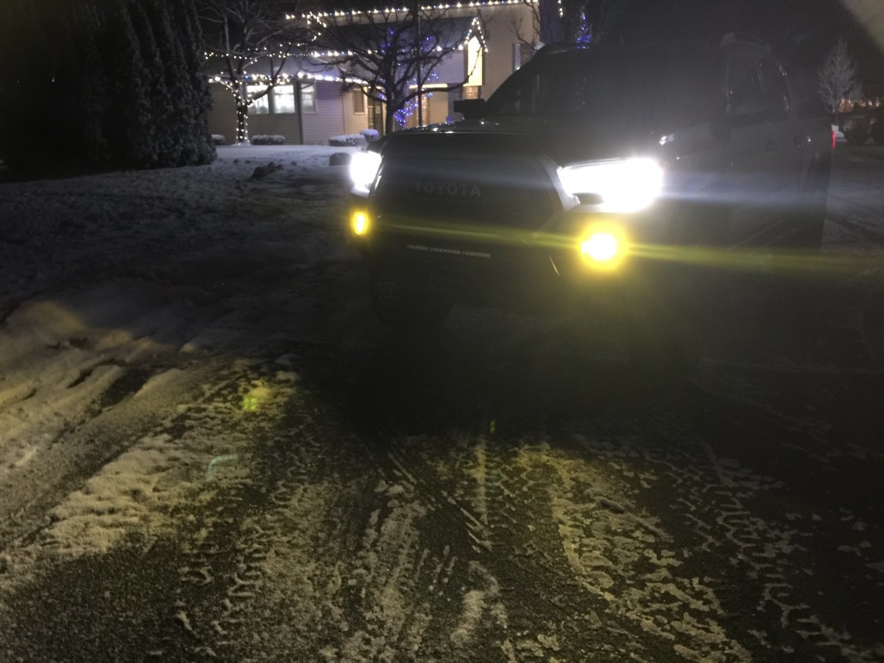

    Looks good, but I think you're still a tick high on the aiming based on the lack of foreground lighting. Remember, a fog beam pattern is for foreground and side to side lighting more than distance. And if you aim fogs too high, you'll bother oncoming drivers.

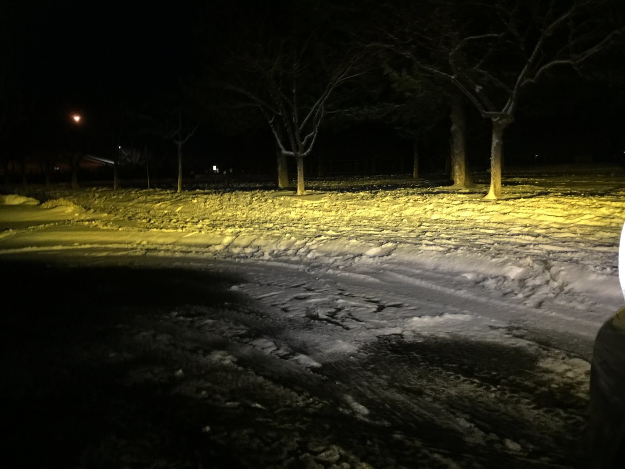

    Just thought i'd add my 2 cents. I got a really good deal on some brand new Morimoto Type T amber fog lights. Very... underwhelmed by their performance. The beam is too narrow. I will adjust aim a little higher but may end up in the buy / sell / trade section.

    The Rigid SAEs have over 2x the output intensity of Baja’s SAEs. So even if you put the amber covers on the Rigids which cut output by 50%, the Rigid’s with the covers are still higher in output intensity than Baja’s SAEs.
    Agreed on the very narrow beam of the Morimotos. If wanting true amber the KC G4s are a much better option, they have a larger pattern area and a fuller spectrum of light in the amber color as tested in post #588.

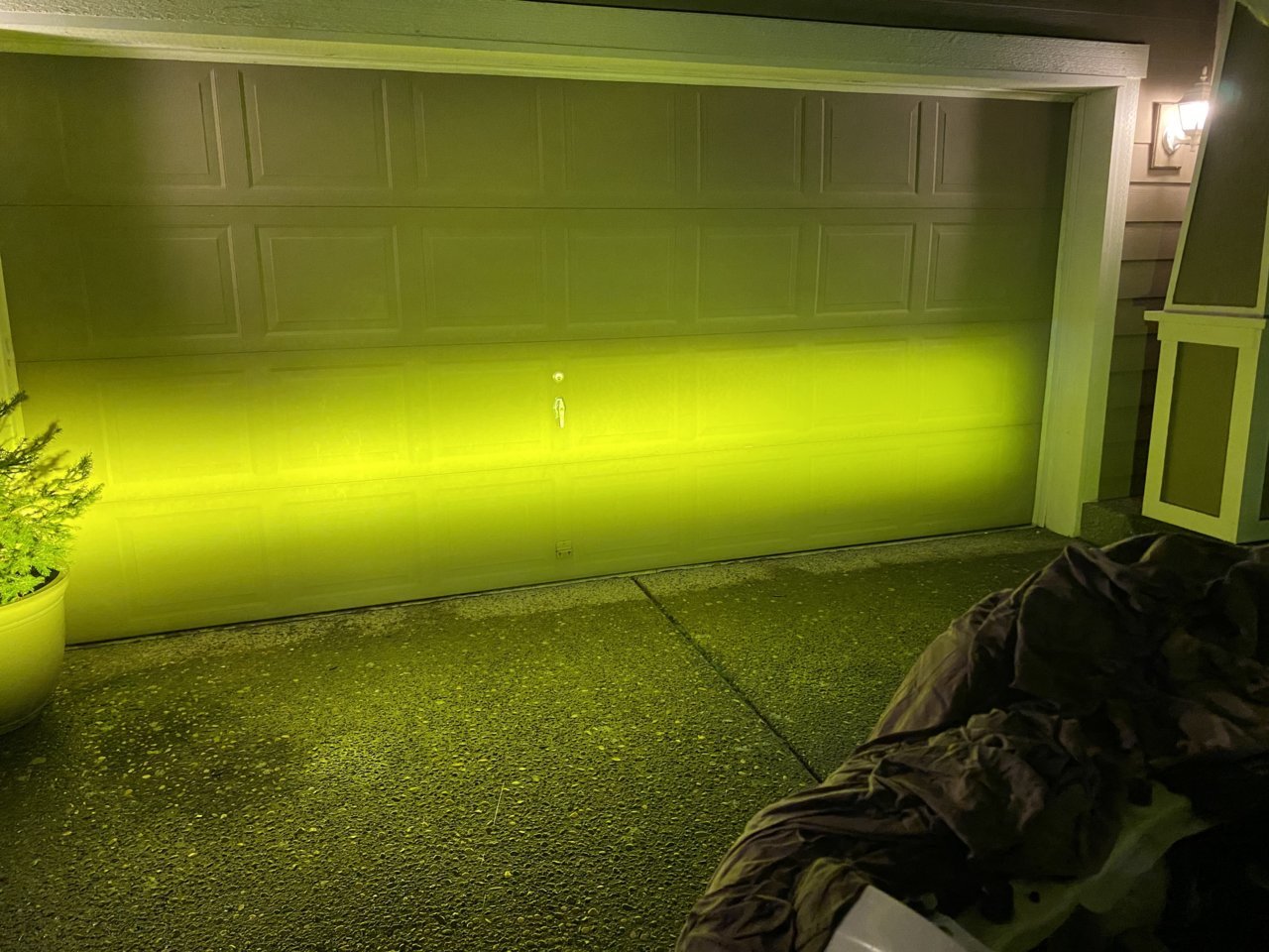

    Tonneau cover, Black exhaust tip, blacked out badges and tailgate lettering. Black rhino(glamis)18x9 wheels with +12 offset. LT265/70/18 Toyo Opencountry ATIII. Metaltech 4x4 rock sliders Cali Raised lower grill light bar/mounts TRD Pro Skid, DD Fogs(pro), Ironman 4x4 FC pro lift.
    The SS3 pro appears to have a higher intensity towards the center of the beam which might be why overall output is significantly brighter than the BD SAEs. Left is DDSS3 right is BD SAE.
  19. Jan 15, 2020 at 9:47 PM

    The Pros also have a much wider horizontal projection angle than Baja. The Pros optics are far more advanced and efficient and the light has over 2x the output, giving over 2x the peak intensity vs Baja. However, the Baja’s have maximum legal uplight/glare. In your photos the Pros appear to have more light above the cut off than Baja which is designed to be 10% below max legal SAE spec (10% below to allow for manufacturing tolerances). Look at the header/threshold above the garage door. Looks far more illuminated on the left vs right. Granted the out door light throws the photo off a bit.

    I think it's the angle from which the pic was taken plus looks like there may be another house light just to the upper left. Still a decent comparison picture.
