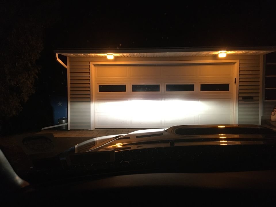

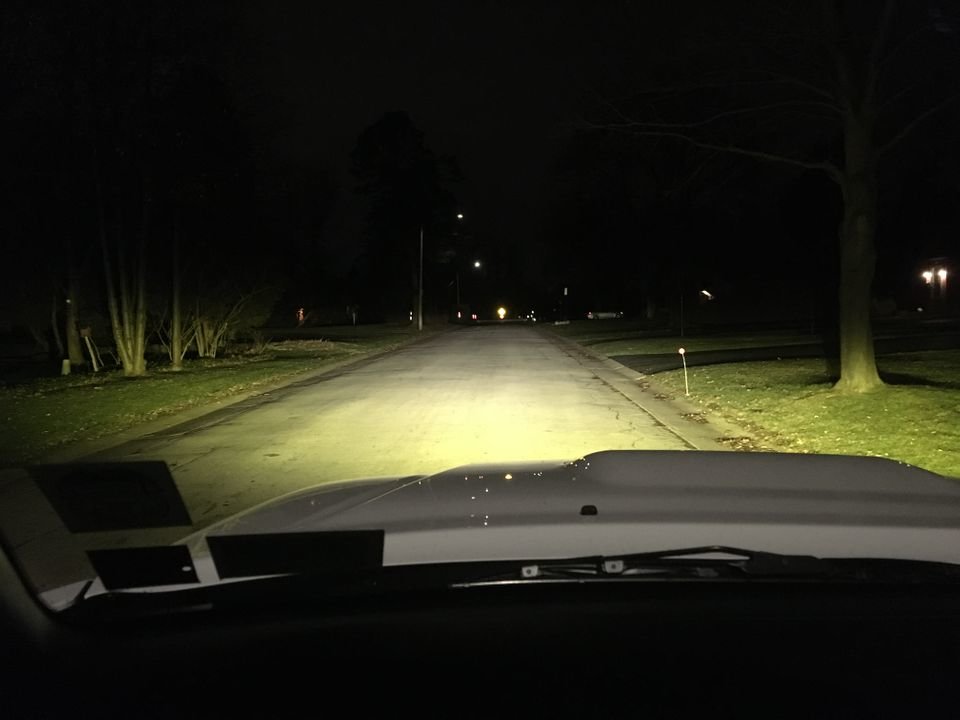

    I've had my new Diode Dynamics SS3 Pro Fogs in for almost a week now. That's been enough time to get them installed, play with the aim several times and use them in a variety of weather conditions. (No snow unfortunately.) I thought I'd post in with my thoughts on these lights, so here goes.
    Pros: Simply stated, the output on these things is awesome. To say that they're intense would be an understatement. The beam spread is more than adequate. The pattern saturation is dense and without any obvious hot or cold spots. The color temperature is also just about perfect. (I can't wait to try these in some heavy snow or rain.) The lights themselves are beefy and appear to be very well made. Nothing cheap about the housings, lenses or wiring at all.
    Cons: The horizontal cutoff is not very well defined. Said another way, it's fuzzy and allows a good deal of leakage above the actual cutoff. (This appears to be very similar to the problem BD ran into with their SAE fogs.) If you look at the pics of my SS3 Pros against the garage door, the cutoff isn't anywhere near as sharp at the SS3 Sport versions. What this does is force one to only use the lights on a "as needed" basis instead of being able to leave them on much of the time - as I did with my KC G4's.
    Here's some pics:
    DD%20SS3%20Pro%20Fogs%20Street_zps3iy15w_8a442185151539a70f8e45992ea25e01c4afd03a.jpg
    Headlights%20and%20SS3%20Pro%20Fogs_zpst_15f70531de4c1086803d0b2fadc3dab8e922a021.jpg
    Speaking of aiming, these are a bit of a pain to aim. This is mainly because there isn't an "aiming screw" as you'd find on the OEM's. Morimotos or KC G4's. One is forced to remove two 10mm bolts on each side and pull the front of the inner fender liner down to access two Allen Head bolts from below that lock the aim in place. My advice is to get them fairly snug on your initial install, but not so tight as to prevent movement. Then manually adjust them by pushing on the top or bottom of the lens until you're happy before fully tightening them. The aiming may take a few tries.
    The Mounting Brackets were kind of interesting to install. As you may have read in @crashnburn80's posts, he found the mounting for 3rd gen trucks is slightly different than for 2nd gen trucks. But DD says these fit 2012-2019 trucks. (Mine is a 2014.) The tabs that slip into the front bumper fit sort of tight. But it's the tabs where the attachment screws go in that are a bit odd. The screw holes in the bumper are just a bit farther apart than the holes in the brackets. This means you have to start the screws on slight angles, them straighten them out as you go it. All of this while laying on your back. Then when you look closely at the cutoff, you'll see that the inside / center is a bit higher than the outside. Said another way, it's not perfectly level. Maybe they split the difference between 2nd and 3rd gen trucks?
    Possibly because of this slightly tilted cutoff or more likely because of the leakage / spill over at the cutoff, even after repeated re-aiming attempts, I've gotten flashed 3 or 4 times. (Full Disclosure: I do have the Ultimate Headlight Upgrade in the truck, but virtually never get flashed.) Based on the amount of selective yellow light that's lighting up signs down the road, I think it's the poorly defined cutoff causing glare for oncoming divers.
    In summary, I think these are awesome fog lights. They totally blow away the OEM halogens, Morimotos and to a lesser extent, the KC G4's. (I've had all three in this truck.) I would like to see a better defined cutoff and thus less glare though.

    Thanks for the review! I think you'll love them once you get the chance to try them out in bad weather. I am really happy with the color we were able to achieve on the yellow.
    Just to comment on a few of the critiques:
    Both the Sport and Pro version of our lamps meet the gradient requirement (sharpness) and the total glare requirement for on-road use. This is defined by SAE standards, and we have internal testing facilities in order to ensure our lights actually meet those requirements. It's certainly higher than factory lamps due to the greater overall output of these lights, but it is within the requirements. In yellow, it's actually quite a bit lower than the requirement. You can use them in any way you'd like, but it is completely legal and acceptable to use either version of our lamp on road.
    From your photo, it appears that the lamps need to be angled down further if possible. It appears the cutoff is about at horizontal, but it should be just below that. I suspect this is why you are being flashed by other drivers. The Pro model should be angled down almost as much as physically possible in the bracket. I would recommend removing the lamps completely, aiming them all the way down in the bracket, then reinstalling. As you said, it's not too easy to aim once they are installed, but installation should only take a minute.
    Aiming is certainly the biggest challenge on these lamps so far. We are adding a "warning" note in the box to make it clear they need to be aimed down, but we are also looking into options to help with aiming for future iterations as well. Again, thanks for the review and feedback!

    As far as the aiming, I actually started with them all the way down for my first test drive - and got flashed twice. I then aimed them up just a tick because all the way down (at least on my truck) just seemed just too far down. On the test drive with this position, I didn't get flashed. Go figure.
    We're supposed to get some snow the next two days, so I'll be out gathering some more feedback!
