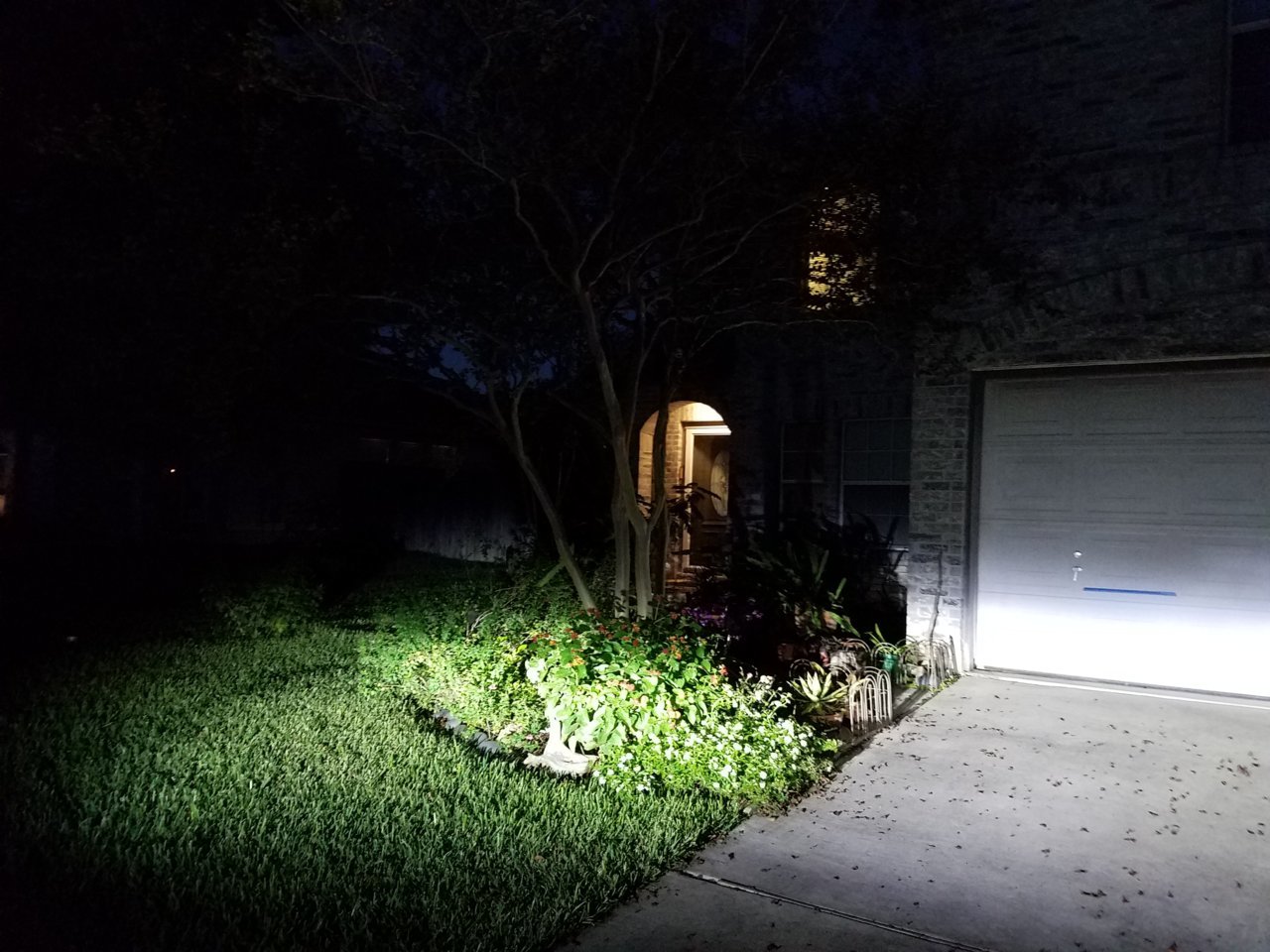

    KC G4 driveway test. Amazing.

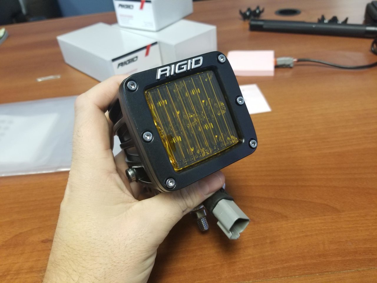

    14,772
    Kirkland, WA
    2003 DCSB TRD OR
    I met with Rigid reps 6 months ago and purposed building an amber version of the SAE pod, along with some other ideas. This is their pre-production unit they are sending my way for evaluation.

    Look what arrived today!

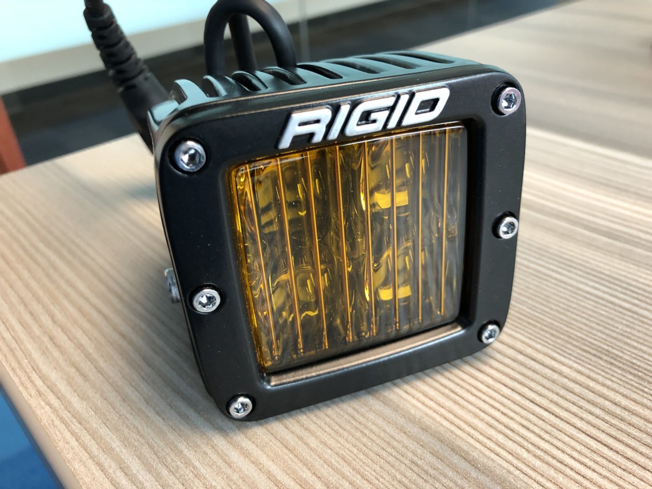

    Testing the Rigid amber SAE pre-production prototypes
    I was concerned with the level of output reduction caused by the amber lens on these pre-production lights after seeing the 50% loss caused by Rigid's amber snap on covers. I compared the measurements of the new Amber SAE pods (purple) vs the standard white Amber SAE pods running the Amber covers (green):
    The new prototypes come in at over 60% brighter than using the amber covers on white lights, while also having a slightly higher color temperature which is helpful for general visibility. A significant improvement over the snap on cover solution. You can see Rigid did their homework to achieve the lower color temperature while minimizing the lux loss in their amber SAE fog.
    As a major added benefit to those in cold environments, the yellow filtering lens appears to absorb a good amount of light energy and get quiet warm compared to the clear lens. You can see in the comparison to the unfiltered spectrum output below, that all that low wavelength blue light gets absorbed by the lens, translating into heat. The amber lens should therefore have much better resistance to icing than the clear lens.
    They take a little while to get warm, but icing shouldn’t be an issue. Ambient temp 63 degrees, lens temp 143 degrees.
    The reduction in output from using the snap on amber cover compared to no cover was measured at about 50% loss as shown below. The new prototype design is significantly more efficient with only a 20% loss.
    I've ordered Rago mounts for street testing. The performance of these lights is quiet compelling for an amber fog compared to the amber cover option.
