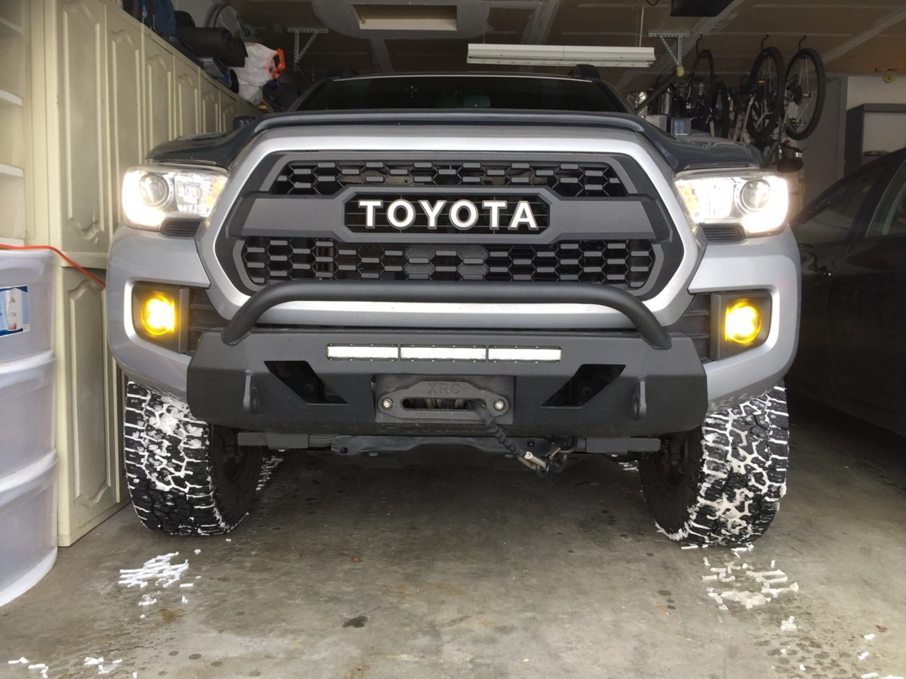

  20. Jan 29, 2020 at 6:21 PM
    #2660
    SpeySquatch
    SpeySquatch Function over Form
    Mar 6, 2018
    #246516
    7,365
    2016 TRD OR DCSB
    C4Fab LoPro, BAMF Sliders, Ext ADS 2.5’s, 4.88's, OVTune (OG to KDMax)
    Been running the DD amber Sports now for a few weeks and loving them. They survived the snow just fine so far. @crashnburn80 good recommendation on these. They rock!
