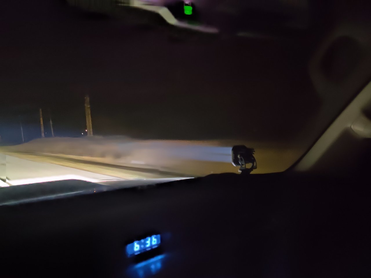

    I'm pretty impressed with these on my 4Runner. DD SS3 Pro fogs light up an incredible amount on both sides of the interstate when it's pitch black outside. I can see a couple hundred extra feet to my right and it's still a great cutoff. The driving lights are awesome too. They have great distance. Definitely hundreds of yards of extra visibility when it's legitimately pitch black out in the country. IMG_20200126_183552.jpg

    is that all fog or is that bleed off from your hood pods?

    That's from the fogs. The hood spill with the driving lights isn't bad at all, especially compared to my squadron pros.

    them thangs are bright! Looks like you don’t even need the hood lights anymore haha.
