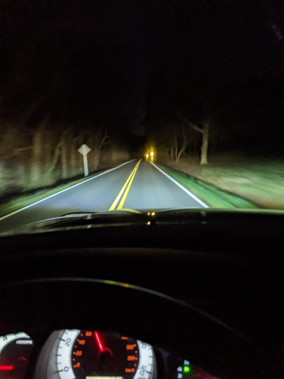

    Kinda blurry cause I was driving but this is with the rigids and the low beam x-treme vision +130s

    The D-series SAEs put out about 1000 actual lumens (not raw) IIRC, your headlights are brighter, but they are projecting that intensity much further out, whereas a fog is a short range pattern, which will provide high intensity light very close and seem relatively brighter. It is somewhat challenging to tell the relative height of the LED cut off on the left with the elevated road, but are your fogs aimed like stock.
    Until the release of the SS3s, the white Rigid D-series was the highest intensity fog on the market, their output intensity is impressive for sure. But yes, they are SAE compliant and have some of the sharpest cut offs with minimal light spill above the cut off, meaning they will not bother oncoming drivers if aimed correctly.

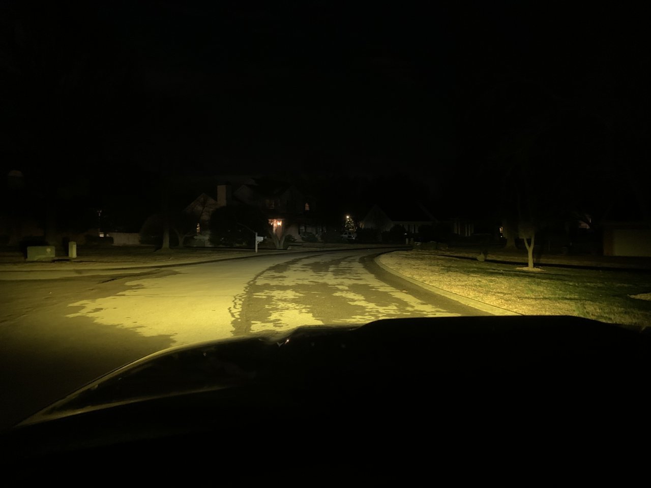

    Just got my ss3 pro yellow fogs installed, and holy shit. First impression is that these are great and more than worth the money. Got them aimed and walked around in the street in front of the truck, squatted down, sat in the street for a sec, etc... to make sure I didn’t have them aimed too high. They’re bright, but nothing that I think will cause issues for oncoming drivers.

    Perfect!
    Aiming is important guys

    Yours look like my SS3 Pros and yes, your aim is perfect. I played with my aim pretty extensively and although I got flashed once or twice initially, I haven't been flashed in weeks now. The amount of usable light these things put down is incredible!

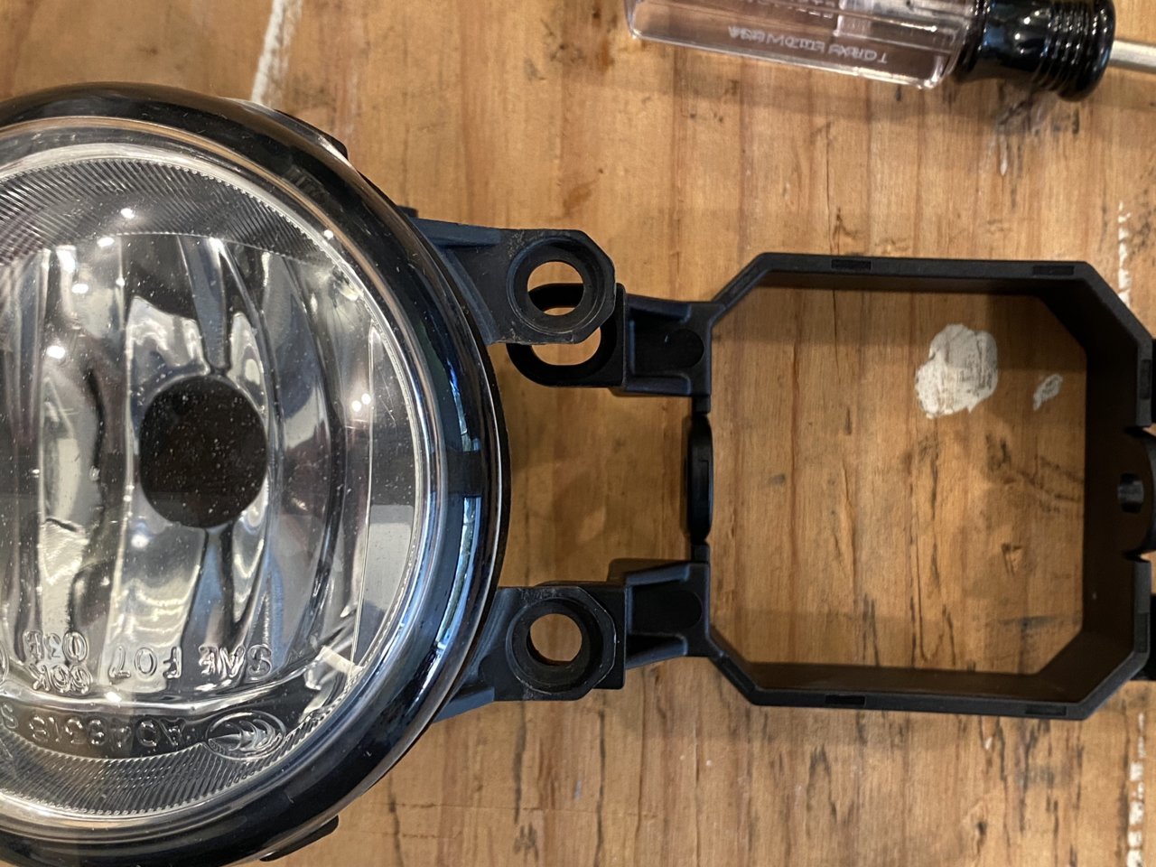

    Testing the @Diode Dynamics SS3 fog mounts on a 2015 2nd Gen. Being designed for 3rd Gen these have similar mount spacing differences as the Rigid 360s did.
    Tab insert mounts vs stock fogs

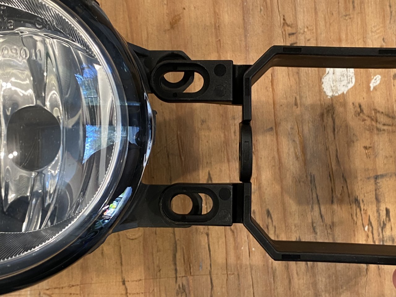

    Screw mounts vs stock fogs
    Since the screw mounts don’t both align, you need to use a single screw to mount, like 3rd Gen. Even though the stock 2nd Gen used 2 screws, 1 should hold fine.
    The lower screw is not the right one, this results in the light not being level left to right.

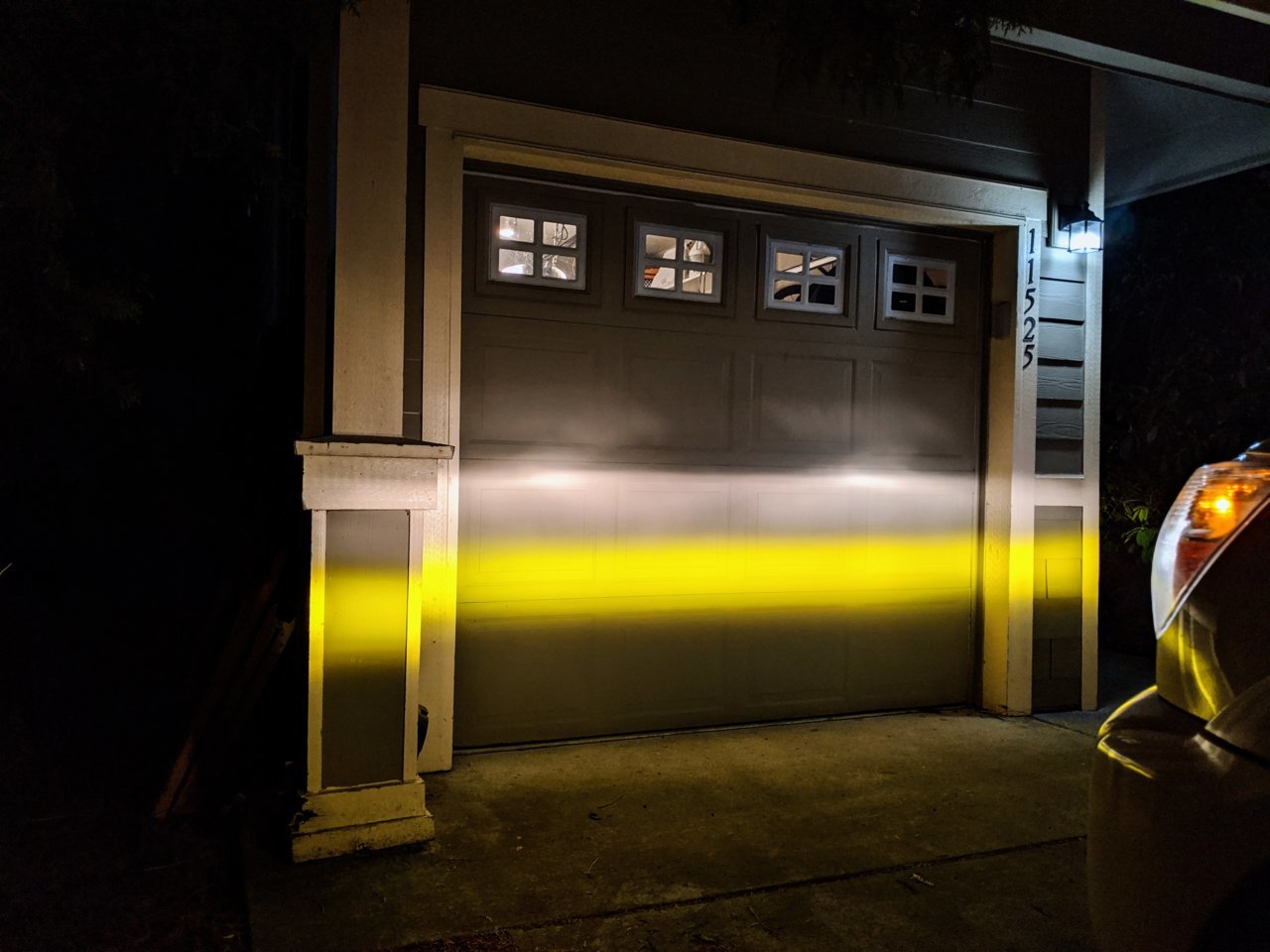

    The upper screw is the correct one. Not perfectly level due to Taco lean.
    So for 12-15 Tacoma’s installing the SS3, be sure you only use the upper screw mount on the bracket for the SS3s. Using the lower screw location or attempting to use both will result in a non-level light pattern.

    That's exactly the issue I ran into and noted in the original post on my installation. Based on your recommendation, I'm going to remove the lower screw in each of mine. Thanks for sharing!

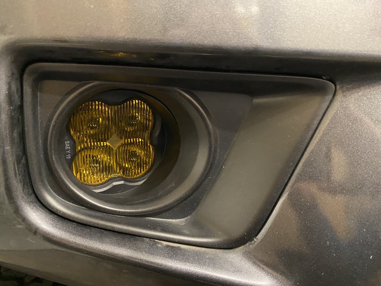

    Hmm. It is pretty obvious showing the mounts placed on the truck both holes will not align properly to the screw locations at the same time. The mount will either be tilted for both to fit, or the screws are angled to compensate, or the mount is stretched under tension. Seems to have worked for you so I wouldn’t mess with it, but it doesn’t seem like results would be very repeatable vs just using the one screw for a level mount.
