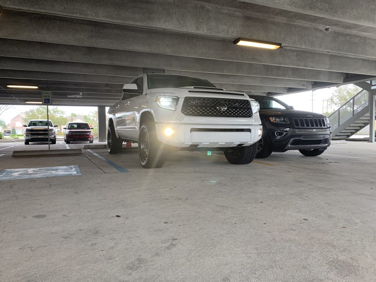

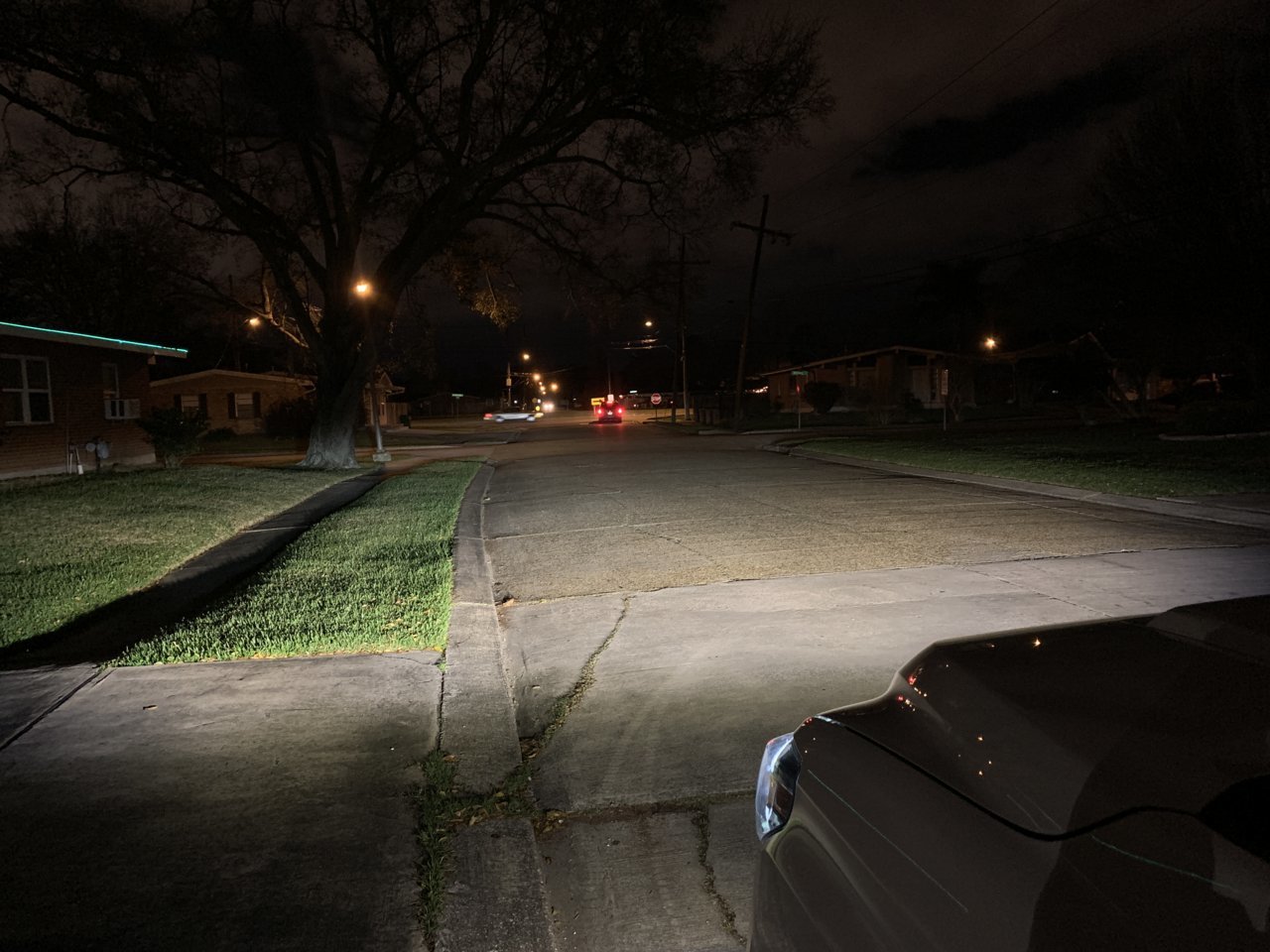

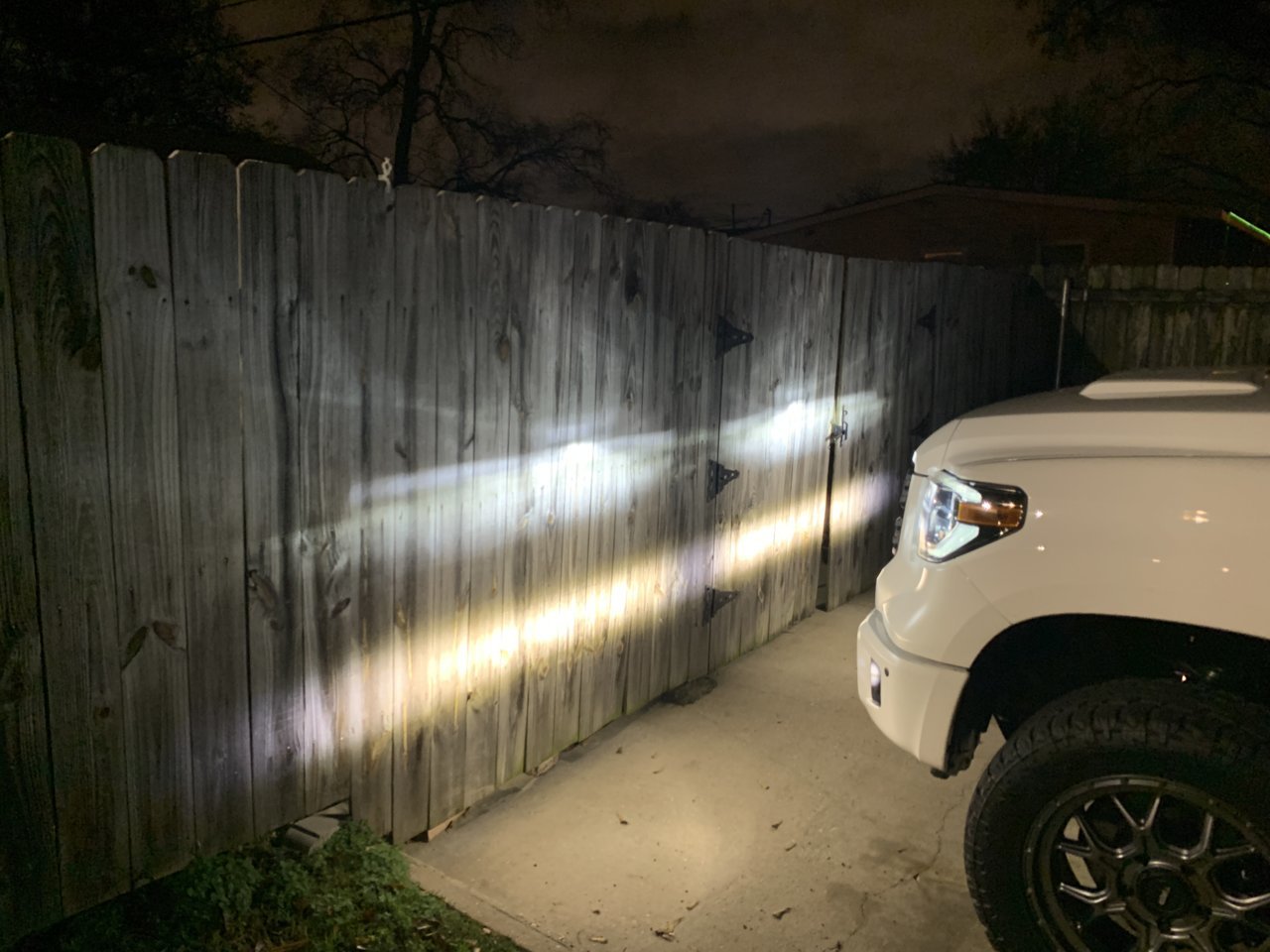

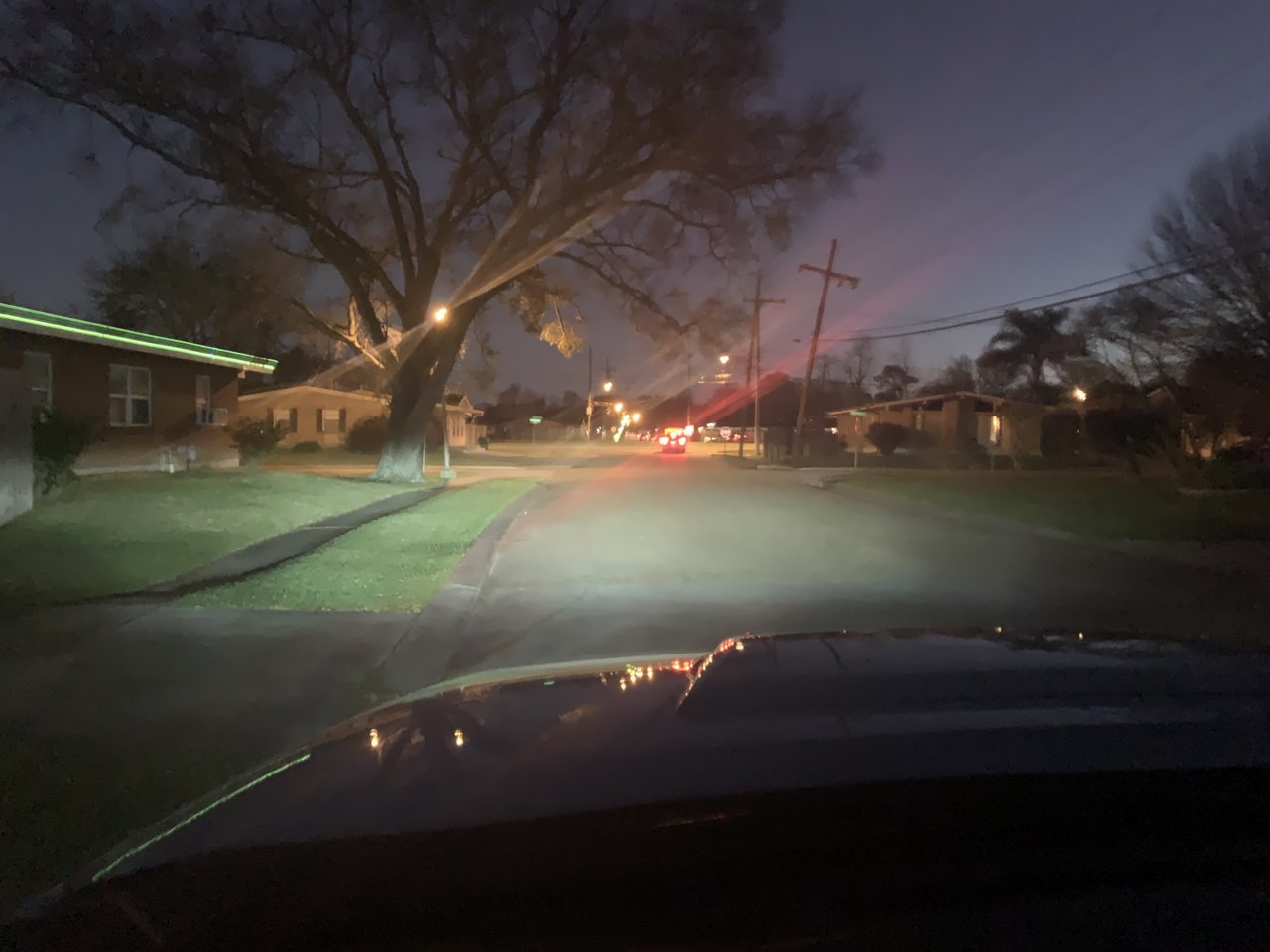

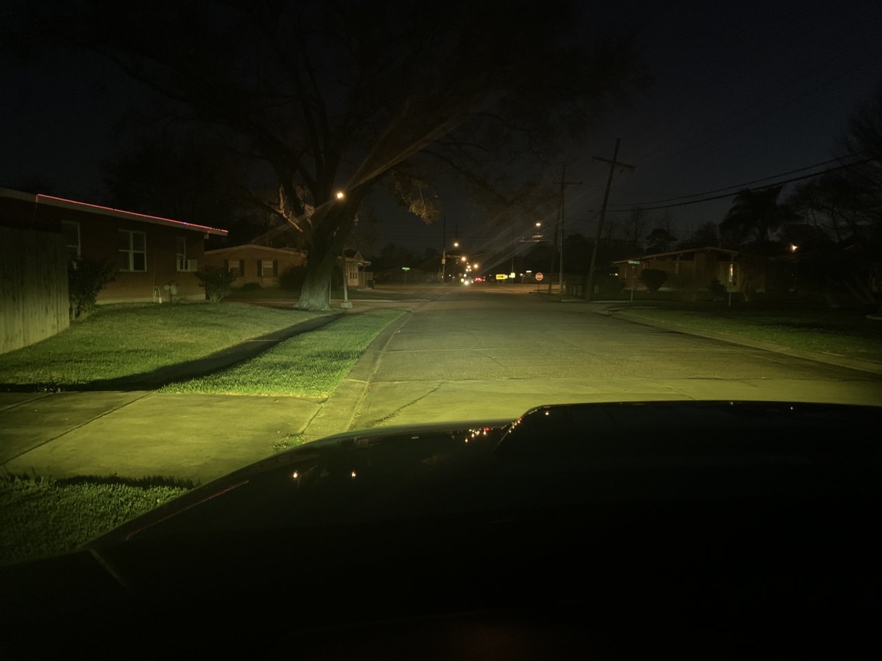

    So I swapped in the clear lens into my yellow SS3 pros. The light is crisp and clean. But honestly, to “my” naked eye, the yellow has just as much output as the light does with the clear lense.... it’s just white on the road. Ultimately, I went back to the yellow. The output is just as good and it certainly gives the truck a more distinctive look, albeit with a far more useable fog light.
    2nd to last picture is oem led low beams only.
    Last picture is low beams and SS3 Pro fog.

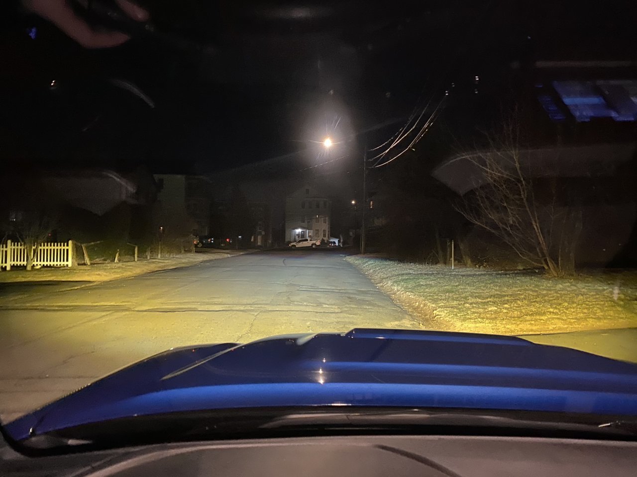

    First heavy fog this morning since I installed selective yellow. The light cut through the fog like a hot knife through butter. I'm embarrassed that I was so ignorant of how color temp impacts the amount of reflected light. Not sure why more manufacturers don't use yellow for factory fog light applications.

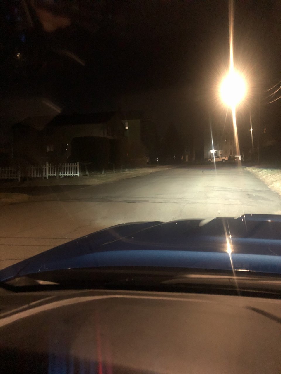

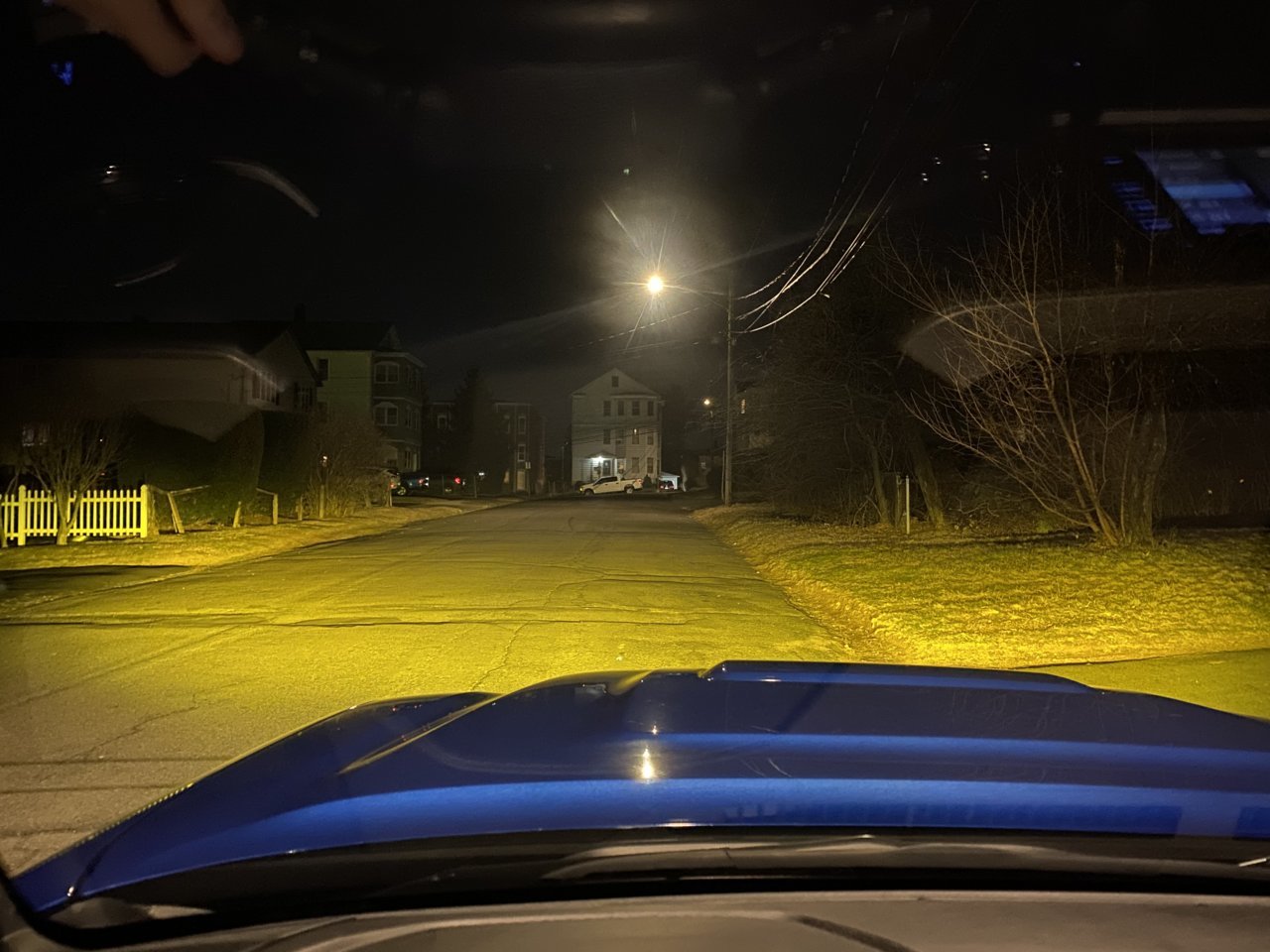

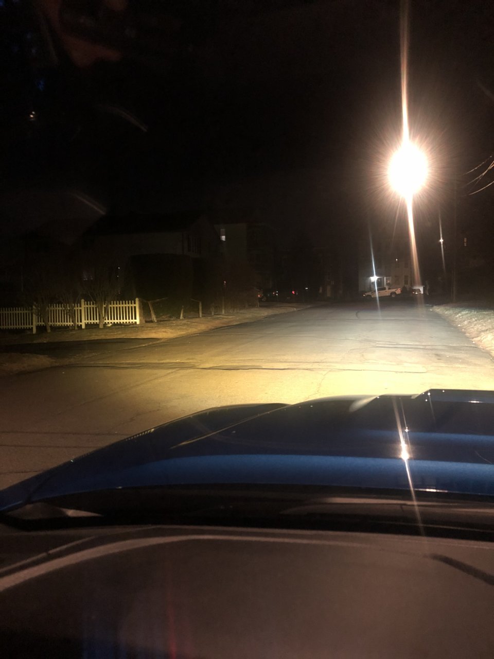

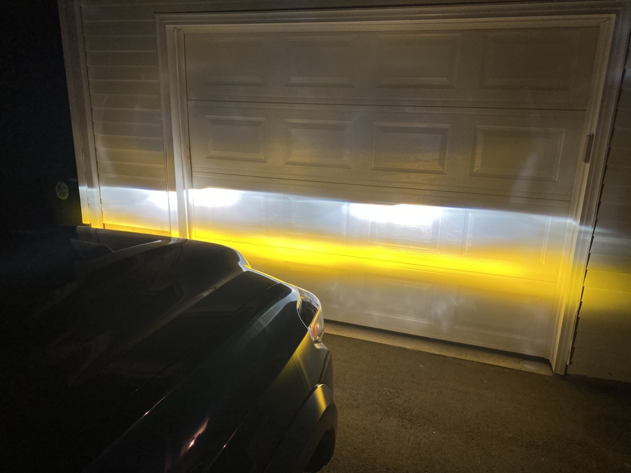

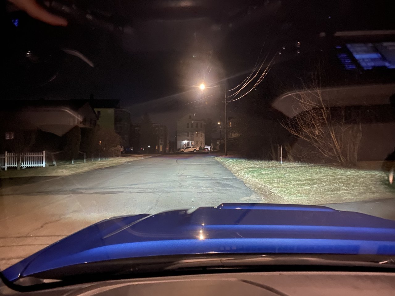

    SS3PRO on 18” TRD sport. Paired with D2S 5500K projectors. I did read about the spill from these fogs above the cut off line but I can tell by the pictures attached (you can see car lights reflecting bact me and they are parked way above the lowbeam cutoff. I want to use these lights everyday but I am afraid of blinding other drivers. Does anyone have problems with glare from the Pros? Might be going to SS3Sports since they have a crisp cutoff
    p.s these are angled all the way down.

    Yours are aimed a bit high. Drop back about 20’ and adjust the top of the fog pattern to where it’s just below the bottom of the low beam drop off

    They are angled all the way down. I followed the install instructions (kept the bracket all the way back so I could angle it as much down as possible). Idk what else can be wrong. I believe My lowbeams are angled lower than what they should be. I have to go to a shop to check everything.

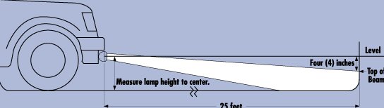

    Ill say it again and again. Aiming is very important!
    The fog cut off should NOT be higher than the fog light height on your bumper. THIS IS IMPORTANT. otherwise the cut off beam on the fogs with rise with distance blinding other drivers.
    there are tons of write up on this. find a wall, measure 25ft back. measure height of fogs on bumper. mark the height of the fog on wall. aim 4" or so below that line
    Please don't aim fogs "just below the low beam cut off", this is just wrong.

    When you say all the way back in the bracket, are you pushing the lights as far back as possible, or pulling them as far forward as possible. Pushing the light all the way back may limit tilt due to bracket interference on the pod body, and all the way forward may limit tilt due to interference on the bezel. I mounted mine in the center of the bracket and had no issues aiming them down with room to spare.
