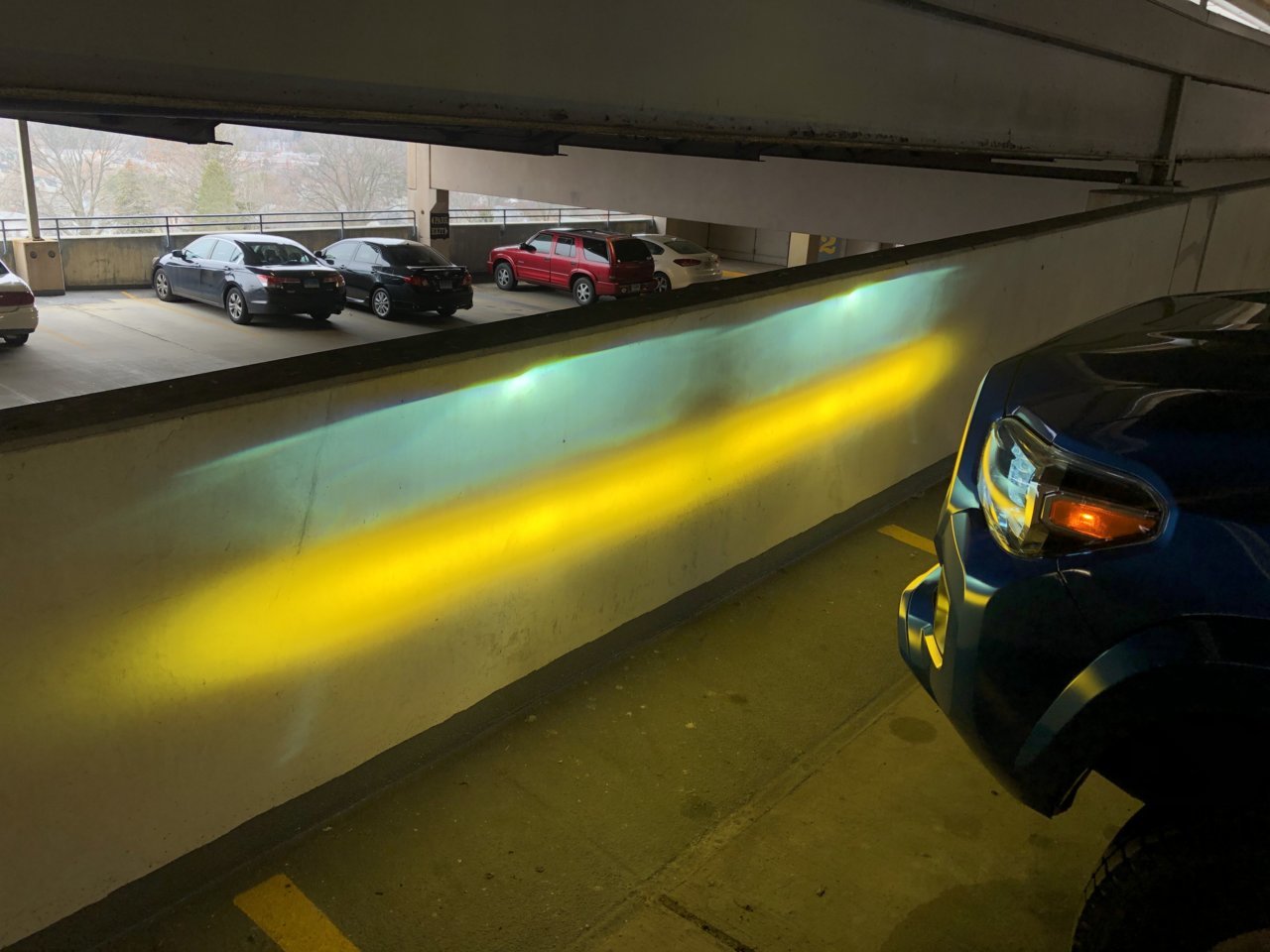

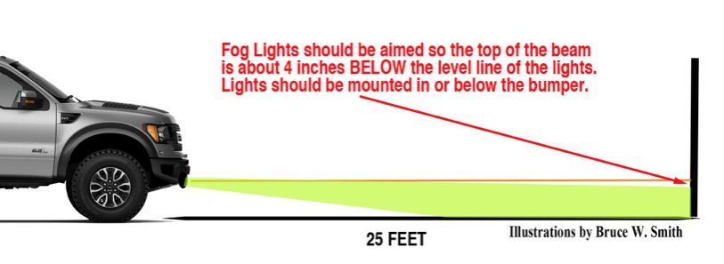

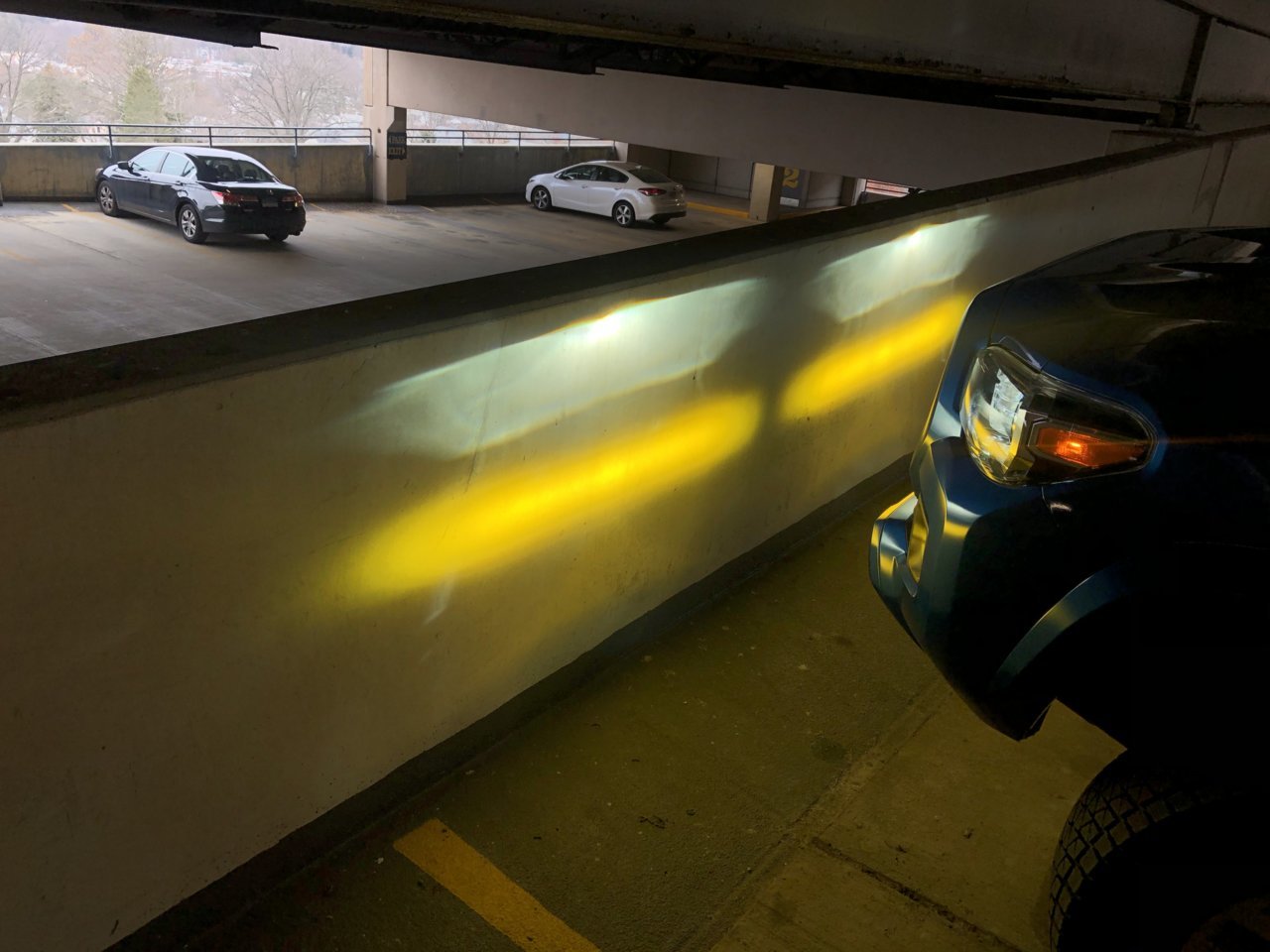

    This is before and after lowering the fogs.
    I can tell that they dont overlap with the lowbeams anymore.
