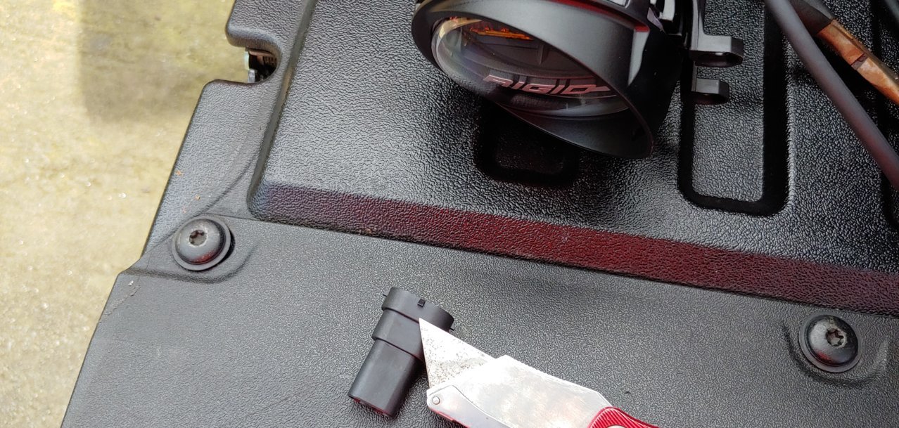

    On another note, do your h11 plugs have this tab on the bottom?

    Yeah I've assembled and disassembled them 2 or 3 times and tried a few things to pop them out, but no luck. Just wanted to let others know in case. I do also have a tab like yours shows. Not quite plug and play for $600. :rofl:

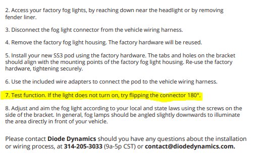

    That tab on the H11 plug is likely there so you can flip it around to reverse polarity if needed

    The plug really can't be flipped. There is a post inside the socket which forces it to be installed in only one way. Polarity needs to be checked prior to assembling the plug. Either the male or female ends of the plug could be modified but why do that when you already have to assemble the male end with the kit. It was easy enough to chop off the tab, just seemed odd. I'm sure there were plenty of different H11 plugs for them to include as part of the kit. They just sourced one with an unnecessary tab. :notsure:

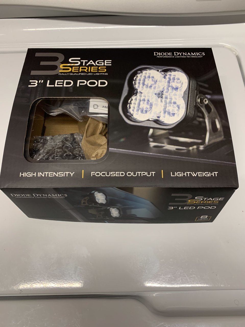

    Just got mine delivered, waiting for a decent day to replace the side shooters on the light bar

    My 2105 Tacoma was able to be installed both ways.
