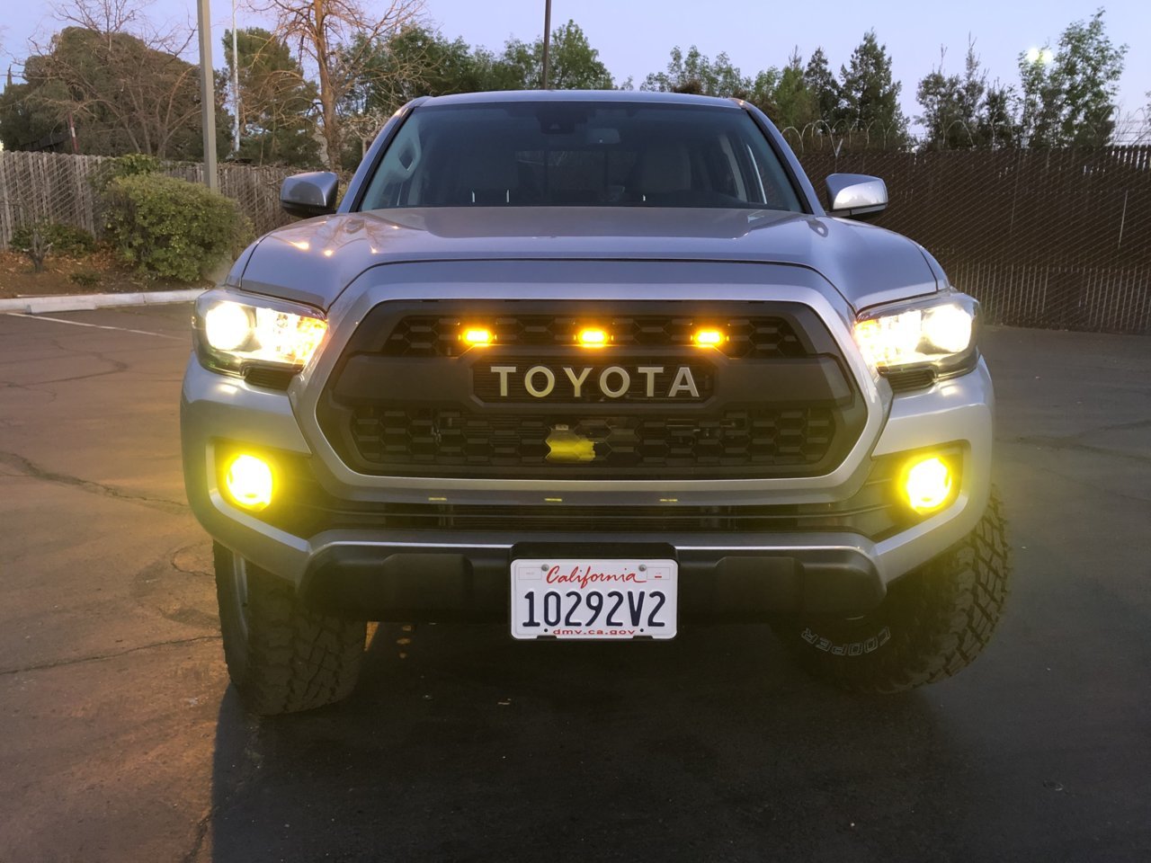

    Installed my pro yellows a couple days back. I tightened them down prior to installing them to the truck just tight enough that I can still move them by hand with a good push. They feel pretty secured and if there’s any movement it’s going to be from the entire housing and bracket shaking if anything as it’s just that one screw and tabs securing it. I’ve got mine pushed all the way down and I think the light output is great so far.
    I did manage to cross thread one nut so bad that I snapped a bolt. Rookie mistake and not fun drilling out the stud to get the nut back out. Take your time and don’t do what I did, it’s easy to cross thread it as the nut isn’t held it just sits in that channel.
    super happy so far, can’t wait to get some fog to try them out.

    I just lined the Allen bolt to the middle of the bracket, then tightened with the light pointed all the way down. Worked out perfect for me. Also installed SpartenX hood scoop light. I’m good for now :DECE332E0-3075-4832-A82E-549F0CE7B4C9.jpg
