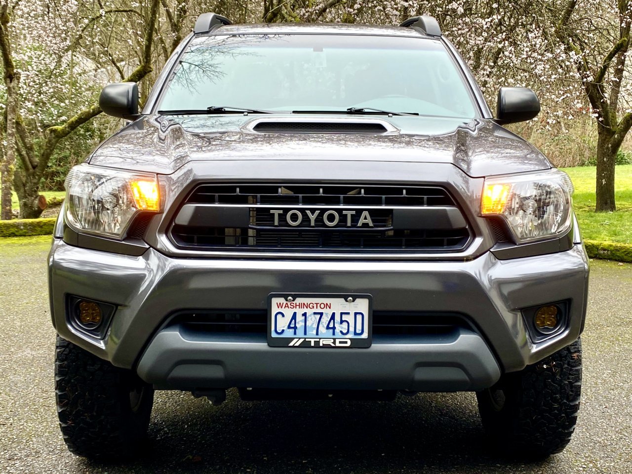

    Finally installed the second SS3 selective yellow Pro fog so I’m not running mismatched fogs anymore.

    It's about time. We were getting concerned about you running in circles every time you turned your fogs on! :devil:

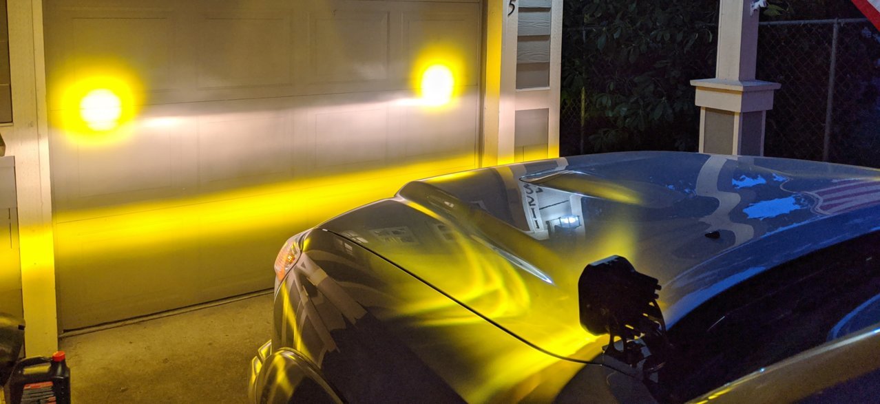

    Re aimed the fogs, and installed sport ss3 sae driving lights up top.

    I’m curious how that hood glare is in heavy rain, snow, or dust

    No ditch light is great in inclement weather. I'll switch to white in the summer but for now, the yellow is good for clearish nights with snow/rock on the road.

    For ditch lights you'd be better with the Sports vs Pros, as the Sports will have less hood glare due to better focus.

    Sorry, typo. Meant “hood” glare. Yellow is da bomb

    The extremely focused output from the driving and spot optic means almost zero glare on the hood. It's much different than a reflector based light!

    Ditch lights aren't really meant to point straight over the hood anyway. They're named aptly: to light ditches alongside the road in the driver's periphery. Mounting them back on the hood or roof allows the driver to see alongside the vehicle instead of just in front of the bumper. Pointing them straight forward achieves the same results as simply putting them on the front grill, but with more potential for glare.
    Also, check your final light height before using them on the road. They may be too high to be SAE compliant or street legal.

    Selective yellow is also not technically legal for driving lights, unlike fog lights. If on the street though nobody should be in front of you when you turn them on anyway, so it really shouldn’t be an issue unless your state requires covers on non-compliant lights.

    I'm definitely not running the driving lights with anybody in sight. I do alot of fs roads, and driving through eastern Oregon and Nevada where you won't see cars for literally hours.
    I'm still toying with the aiming, I had the flood lights aimed more towards the ditches. These seem to be better pointed straight...
